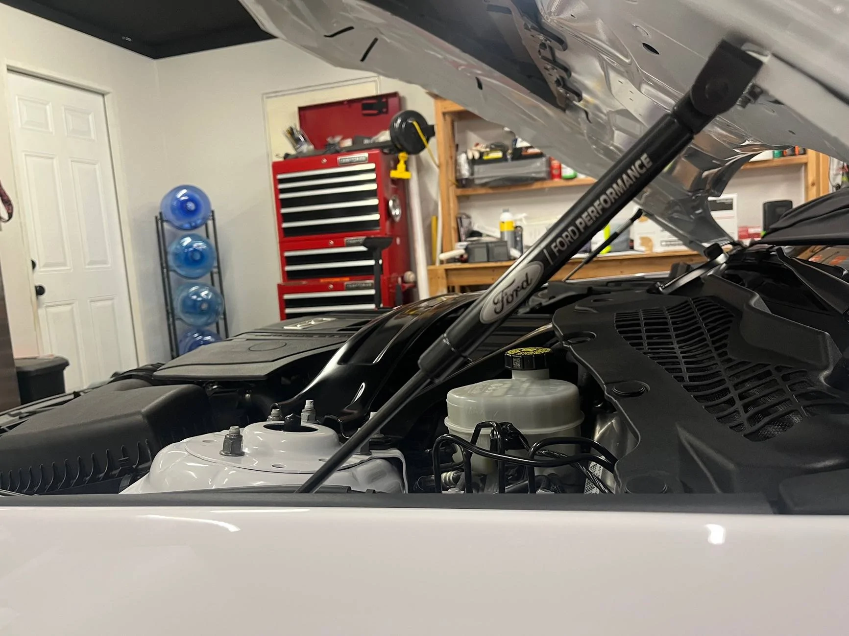

Ford Performance hood strut. Weight added for ease of life. But I took the prop rod off and it was the exact same weight down to the 1 billionth of an ounce so we’re good.

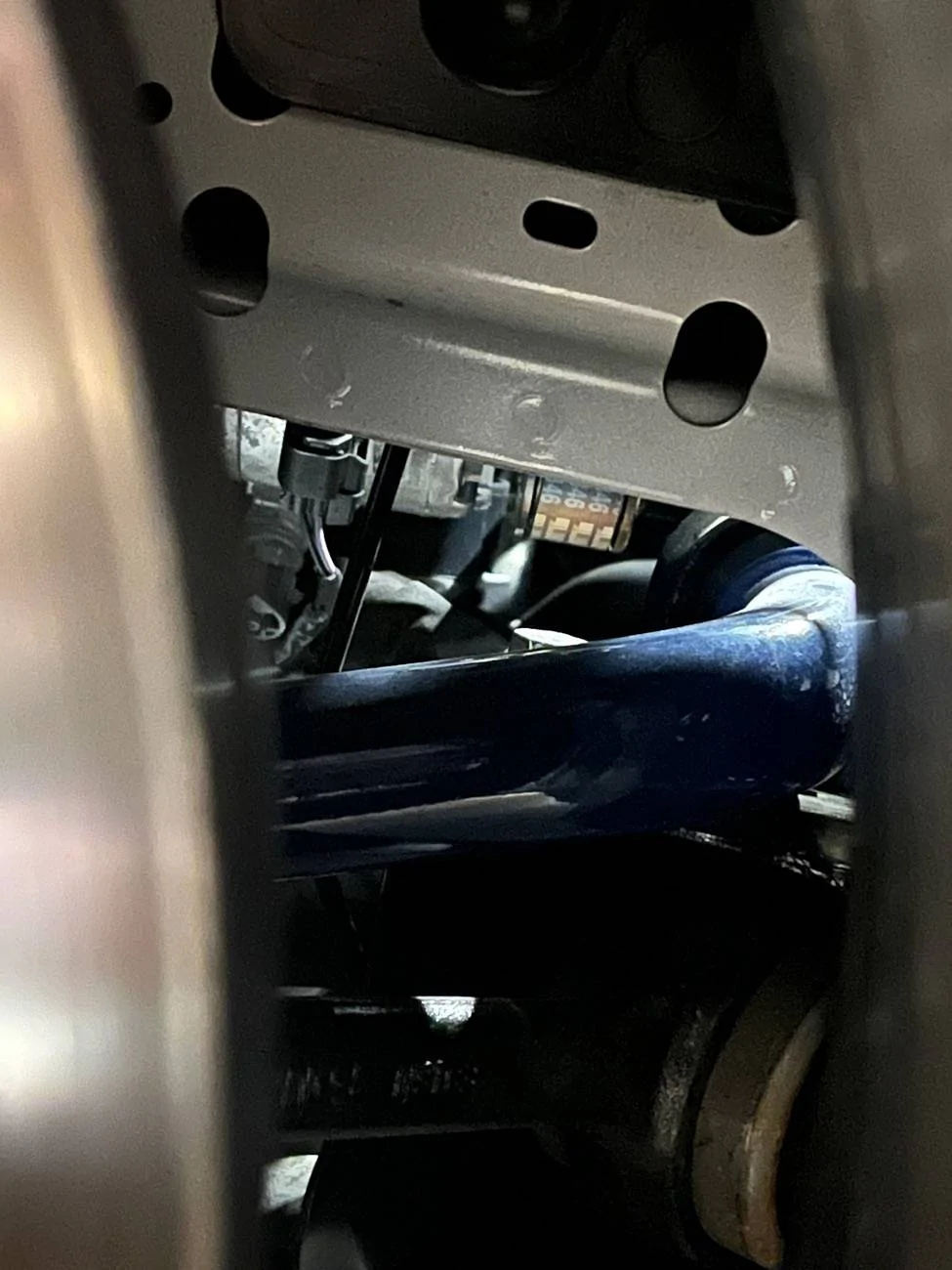

You can see my Ford Performance sway bars if you look just right. They are part of the track suspension kit I installed. I love them. I will say I added them at the same time as the shocks/struts/springs so I can’t comment heavily on them alone, but as a package… Se si bon.

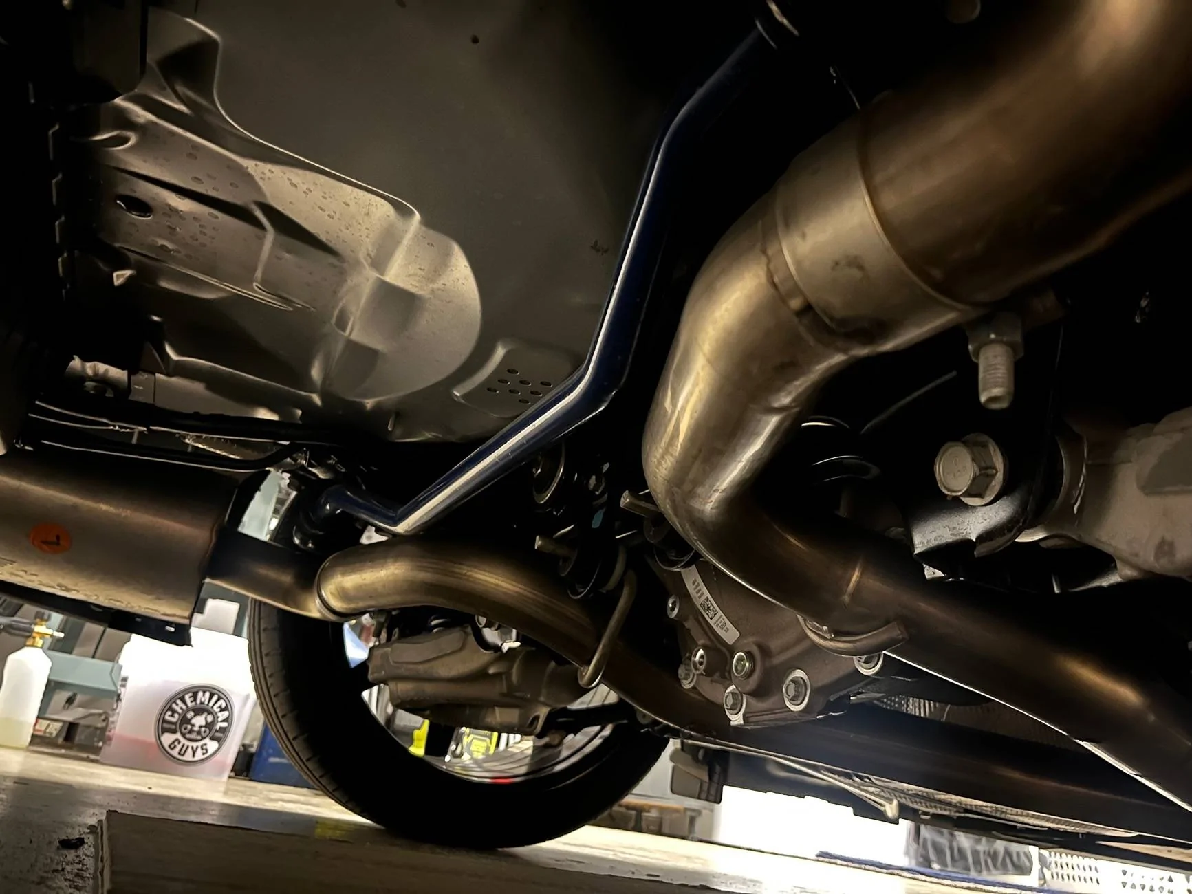

This is my horrible attempt of a picture of my Steeda Extreme G-Trac K member brace. I don’t like the name, I don’t like install even more. Holy sweet baby Jesus that was difficult to get on.
I’ve added a ton of Steeda stuff to my car and the chassis is so stiff now a wheel comes off the ground when I back out of my driveway. It didn’t used to do that. The bigger difference (and more importantly) is in the turns. I love it.
