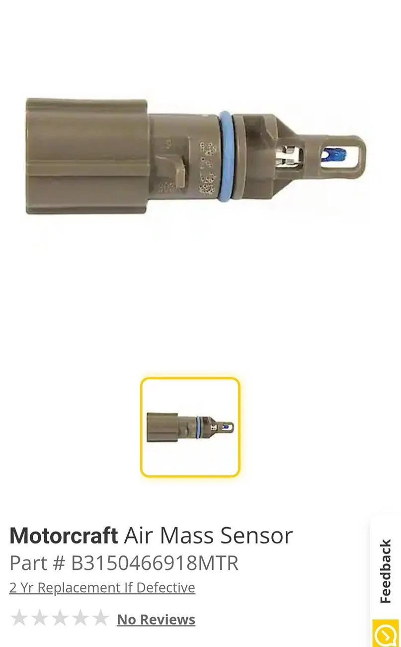

Quick question. New to the EB. Can you tell me where this sensor is?

The Ecoboost Mustang does not have a mass air flow (MAF) sensor. 🤷‍♂️

I still call it a MAF...because I do lol
It's actually just a temperature sensor, but it's labeled incorrectly in many places online. Notice all the other names they include on this page, which are there to help search results when people don't know what the part is called. So, call it whatever, but all it does is measure temperature at the intake. Also, installing it backwards isn't really a thing, since it has one tab that clicks into place. I also don't believe it's a part that would routinely need cleaning. 🤷‍♂️ https://ford.oempartsonline.com/oem-parts/ford-sensor-ds7z12a697a
P.S. Could it still be installed incorrectly? I guess if someone just pushed it in without turning and locking it into position, it could be leaking air and/or giving a false reading.
No it is not JUST a tempature sensor. It has that as a function. But that is not all it is.
Yes it can be installed "incorrectly" typically people didn't twist it in all the way. Thinking the Tight fit in some after market intake was=fully seated. as such, installed incorrectly. Seems to happen largely for people on the metal/aluminum C.A.I.

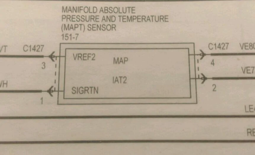

The sensor you referenced in above wiring diagram is not a MAF sensor but rather a MAPT sensor and is located in the top center of the intake manifold not the air cleaner cover or intake tube. It measure intake manifold pressure and temperature but not mass air flow at all. The EcoBoost is a speed density fuel map system not mass air flow system, so it does not care what the air flow rate is just the temp and pressure along with throttle position, RPM, load and many other signals the PCM needs.
MAF sensors do need cleaned at times, MAPT sensor do not need cleaned.

Yes, the sensor on the intake box is just a temperature sensor (IAT, intake air temperature). It looks exactly like the one you posted above. But either way, this isn't helping the OP... I wonder how he's doing?
