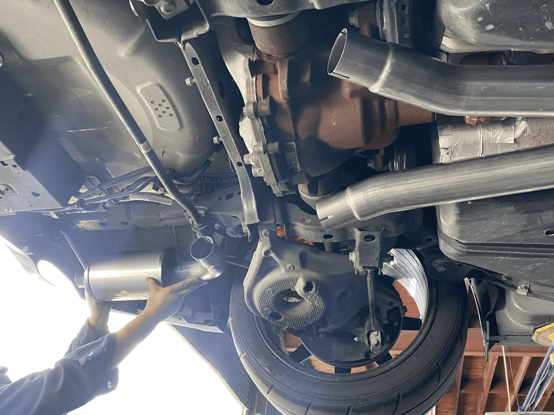

I have a 2017 GT and my mechanic is bolting up the headers w/ X pipe and a pair of Roush axle backs. He called me and told me I was missing a piece and sent me the picture below. I see what he is saying but is my axleback actually missing a piece or does this need to be created? I would think the whole thing would bolt right up but I have Texas speed headers with cat deletes via an X pipe and they don't seem to bolt right up to this. Any ideas? My mechanic said he could create one and weld it up for me but he told me to ask if there is a part missing.

I believe the Roush axlebacks, you have, are like some other companies, you must cut the original pipe before the final bend (90) that enters into the original muffler. Your mechanic must make up a new pipe or cut the old one off the old mufflers. So, no part is missing. Corsa and Flowmaster make axlebacks with the pipe longer, so no cutting is needed.

Yeah the Roush axle backs attach to the factory pipes. You have to cut the factory mufflers off and attach those to the factory pipes.
So you'll either need to cut and use the factory pipes or have him fab something up
this. if you kept oem piping til the axelbacks, it would of been good, but you eliminated it for the middle piping section.
no big deal, they should be able to fab that up like cake.

Thanks everyone else, I'll ask my mechanic to fab something up instead of re-using the factory piping.
