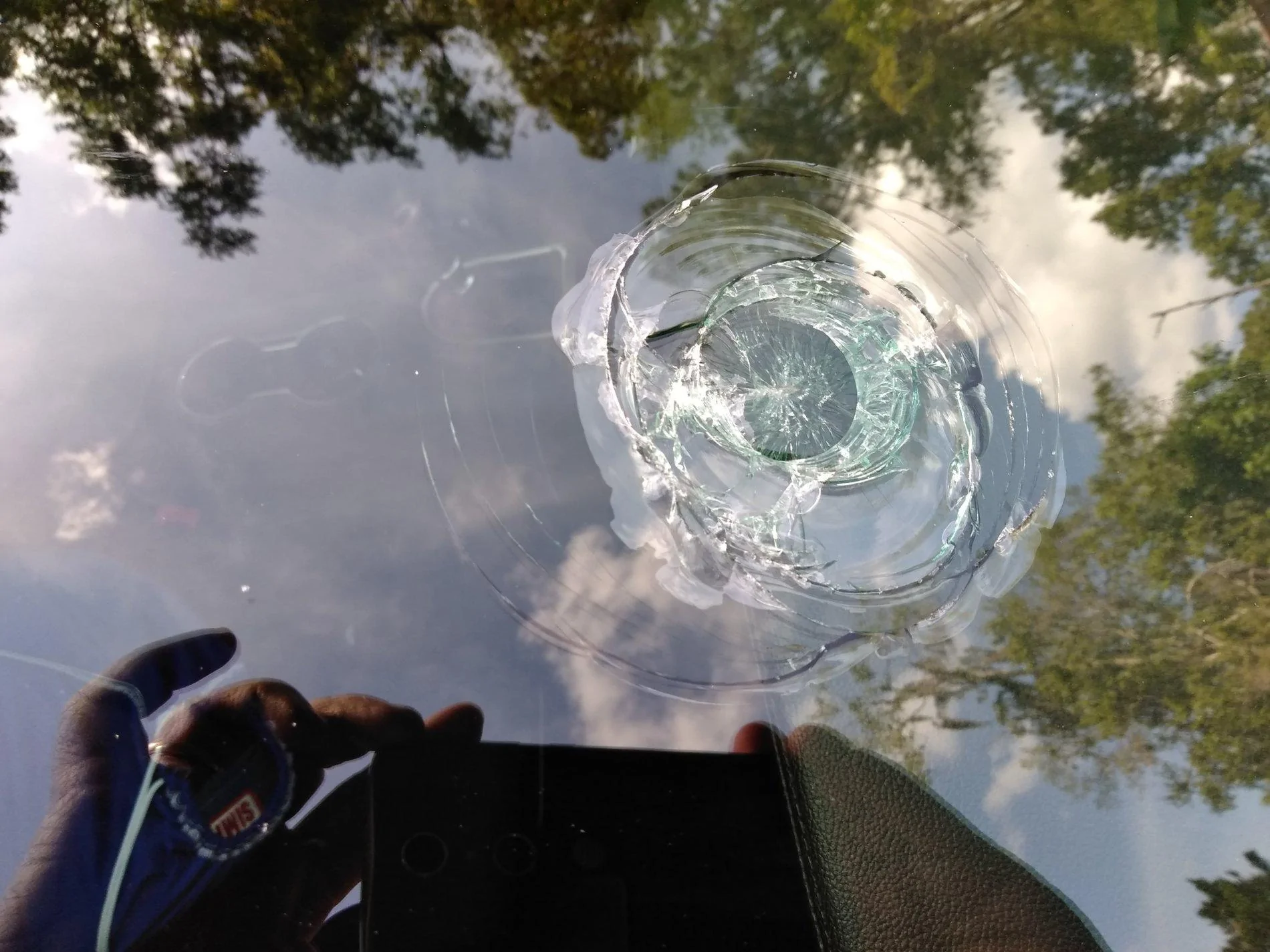

On my last session at Daytona International Speedway Friday, I caught a rock at about 150mph that just about went all the way thru the windshield. Does anyone know if it is a standard mustang windshield or a special order for the gt350?

Some one will chime in but pretty sure I read one time on a forum that it is not the standard Mustang windshield.

When I changed my windshield they never mentioned that the windshield is different, I believe they are the same.

I had to replace mine once due to a crack. Went via Safelite. If I remember well, there were two options.
The original one which has the choice of with or w/o “laminate” which I think is more sound dampening and rain sensor or not. I don’t think GT350’s have rain sensors ? But I might be wrong. I went with laminate and w/o rain sensor. Also has the Ford oval sign. Safelite does offer a cheaper alternative without the Ford oval sign which I assume is non OEM ? I went with this part number FR3Z-6303100-H for my 2016 TP. I think all S550 std Mustang windshields fit all Mustangs, at least that’s what the vehicle fitment info says and worked for me. Good luck with the replacement.

Thanks for that info...that is exactly what I was looking for.

Get the Ford "sounscreen". I'd go OEM. Its a moral call, but in the state of FL, insurance pays for windscreen replacement......... No hit on your insurance.
Maybe this time get some windscreen protection.

..but but .... hold on, the led shift lights display needs special coating in that area to work, it's not just glass over there..... do all mustangs have shift light ?

I don't know about that..... But either way, I'd go OEM. And there is a choice, soundscreen or not, get the soundscreen.

It has to be polarized glass like the one on DSLR filters, to be able to reflect exactly for the driver.... Check if you passenger sees it, I bet he/she's not. I changed my BMW M5's windshield once (that car has all kinds of things displayed on HUD, including GPS) and the idiots installed a regular windshield, aftermarket... they had to remove it and install it again, with an OEM BMW unit.

I think I asked that a few times and the answer was yes. I'll check it again. Either way, OEM will take care of that.

Passengers can see the shift lights perfectly fine I just got mine changed too due to a rock on track but it wasn't nearly as bad as yours. Just make sure you get the "Soundscreen" one and you're good to go. Not GT350 specific.
