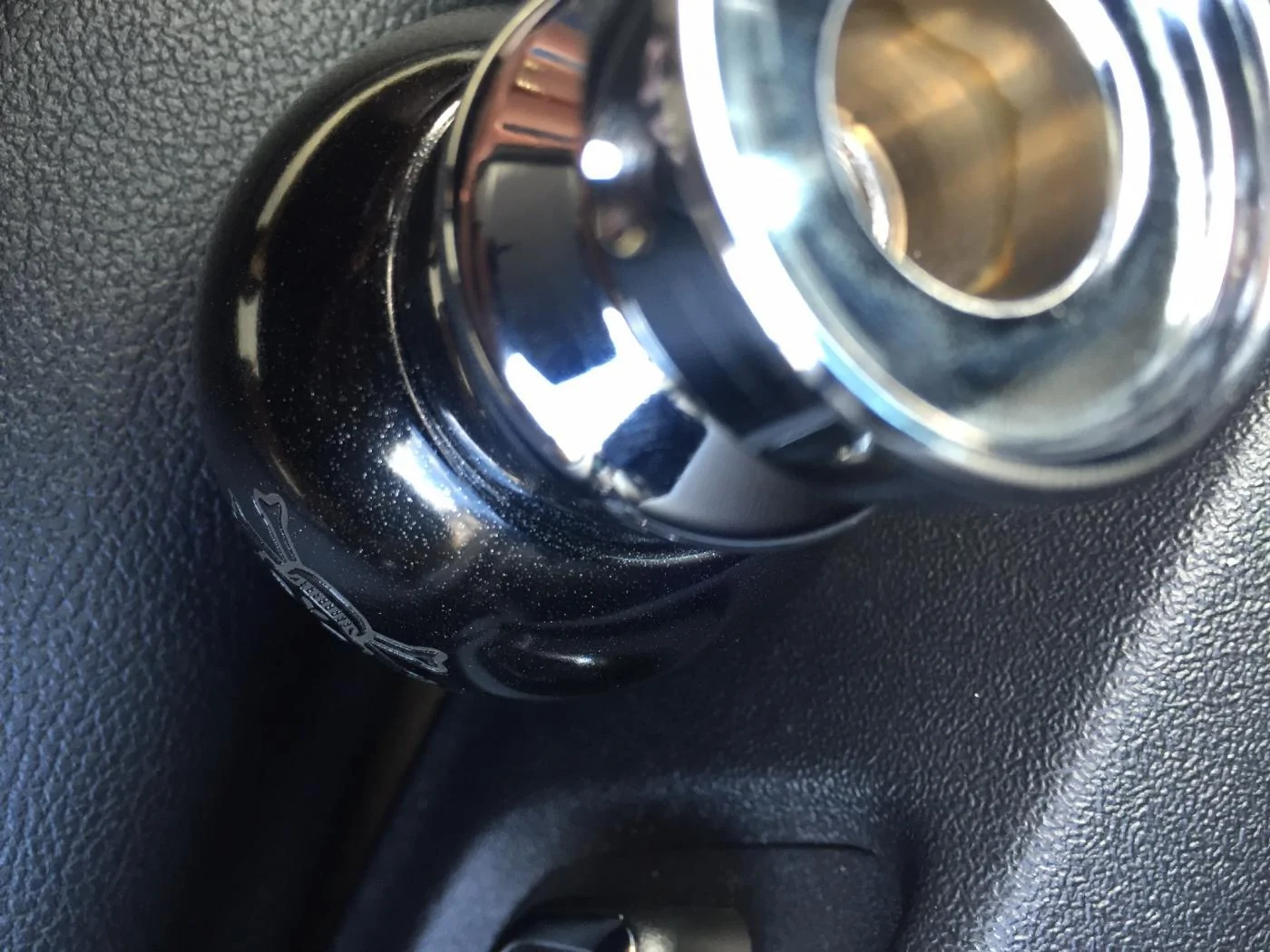

Pic of nut and profile of stock adapter cut down.

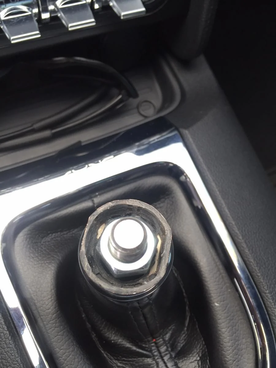

Top view. I used Drexel to cut lip down and then I removed lattice work inside.

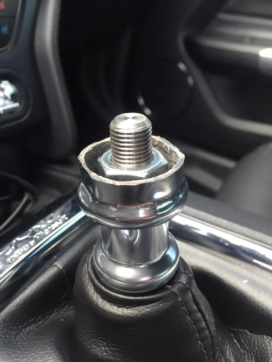

Pics of MGW adapter. Won't fit inside.

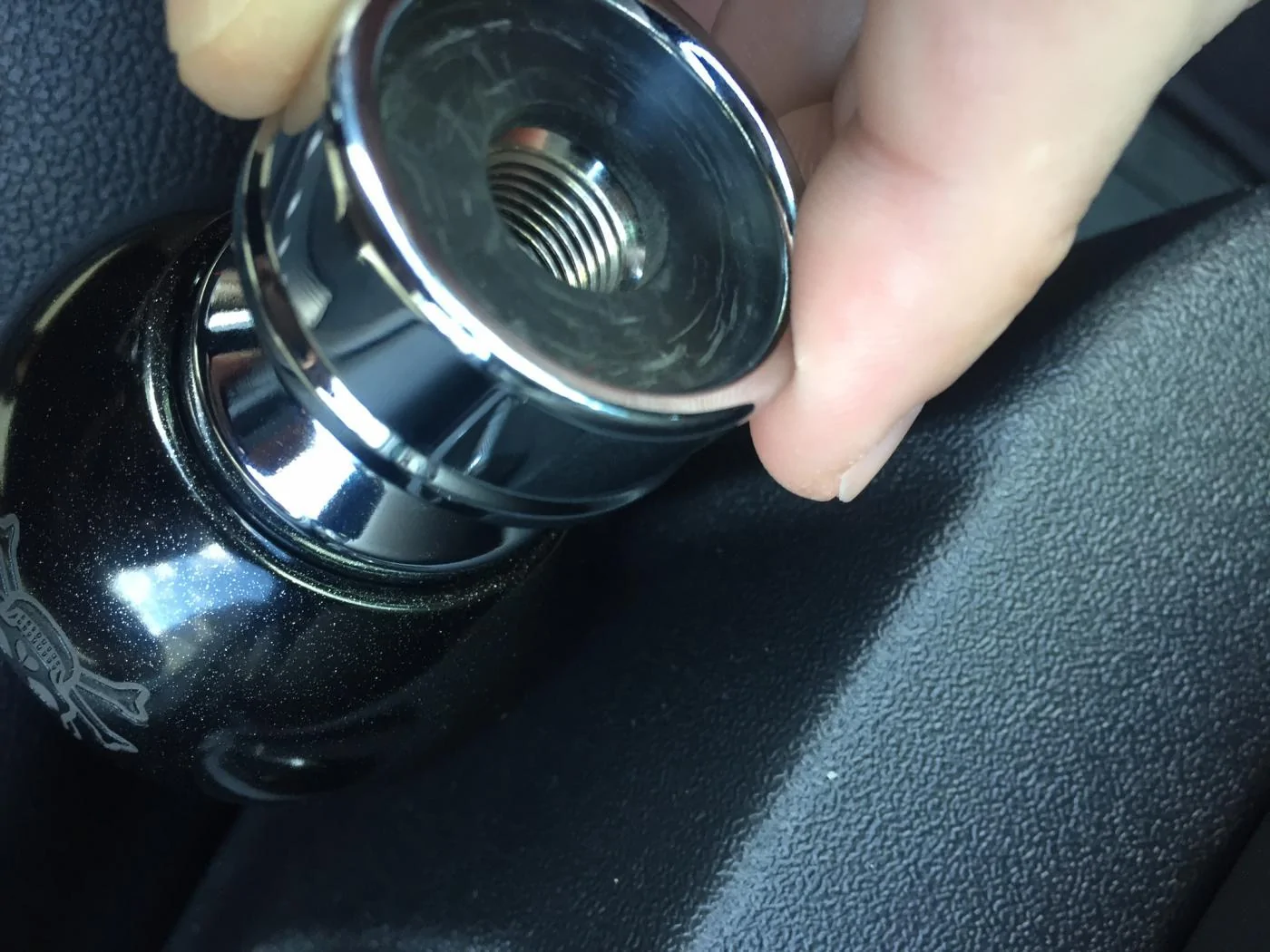

Fits other way but threads don't go down shifter handle far enough to flip the adapter. One idea is the drill out the threads on the adapter. Then it would fit upside down.
