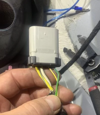

I'll be doing a roadtrip through Europe this August and I want to install a kill switch. I will actually have a can bus immobilizer installed but the company doing it is booked full till mid August. As I will be driving through Italy, Czech, Hungary etc. I want to have at least something to make it more difficult for any carthief as here in Europe these Mustangs stick out.
I want to place a kill switch on the Fuel pump as it's most easy to install and I can route it somewhere in the boot, it's pretty straight forward. The only thing I am struggling with is which cable to use. Is there anyone here that can tell me which cable I have to cut and put the switch in? I read somewhere that one can also pick the groundwire, call me a noob but, electrics don't need a ground wire to be switched on....right? Anyway, pics attached, if anyone could tell me would be much appreciated.
Thanks!

Looks like the small wires go to the sending unit and the larger wires are for the pump motor. If I had to make a guess... I'd probably install the switch in the big yellow wire.
However, I don't like to guess!

Many thanks for your input, I think the thick yellow/grey wire is the trigger - so that should make it the one to cut (I suppose)

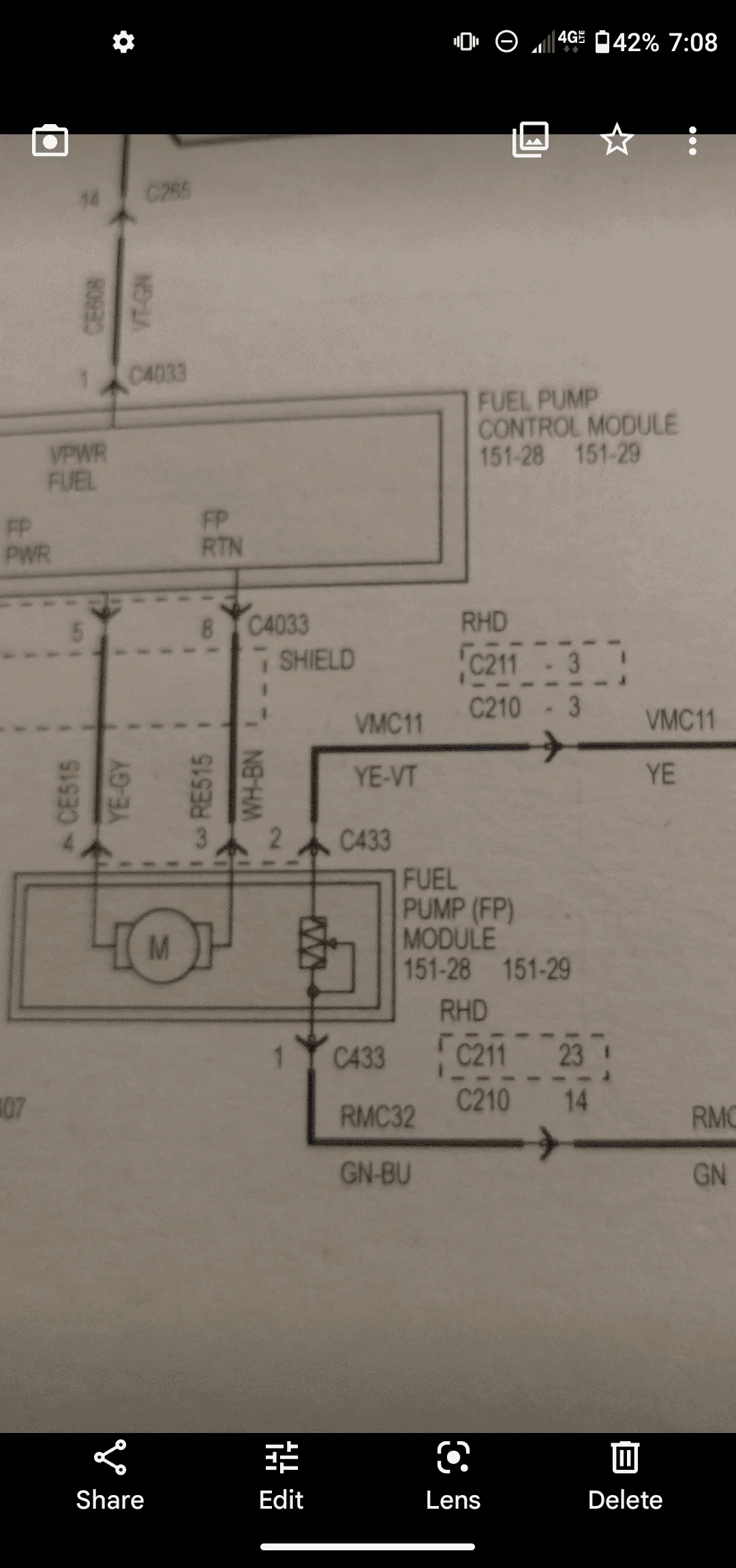

so I went ahead and connected the switch to the yellow/grey wire - turns out it's a ground wire, as the car would even start with one of the leads disconnected. I waited to be sure all the fuel would have been out of the system but it kept idling. Now I have a check engine light which, hopefully will go away. Anyways, not the yellow grey wire LOL .....
