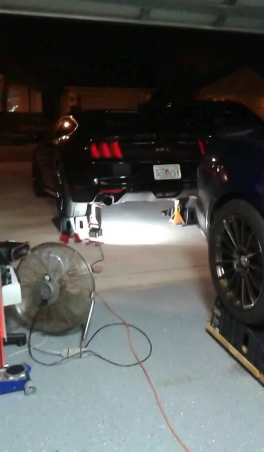

I installed the CB005 yesterday. I saw a few different methods of installation (loosen all 4 cradle bolts) , work side to side and pry cradle back into position, or do front only and then rear.
I didn't want to have to deal with realigning the cradle so I worked one side at a time, while keeping a pump jack with minimum pressure on the housing.
1) Removed the passenger cradle support (front)
2) Loosened the passenger rear bolt enough to slide the front cup in.
3) Tightened the rear bolt up to put the front back in it's original position
4) Installed the new cradle support and tightened all 3 bolts leaving a little wiggle room.
5) Lowered and installed the rear cup and spacer. Tightened with a little slack
6) Did the drivers side the same way.
7) Torqued all bolts to spec.
By keeping 3 of the 4 cradle bolts in all time, the intent was to minimize movement of the cradle.
Seemed to work out OK as I had no alignment issues.
