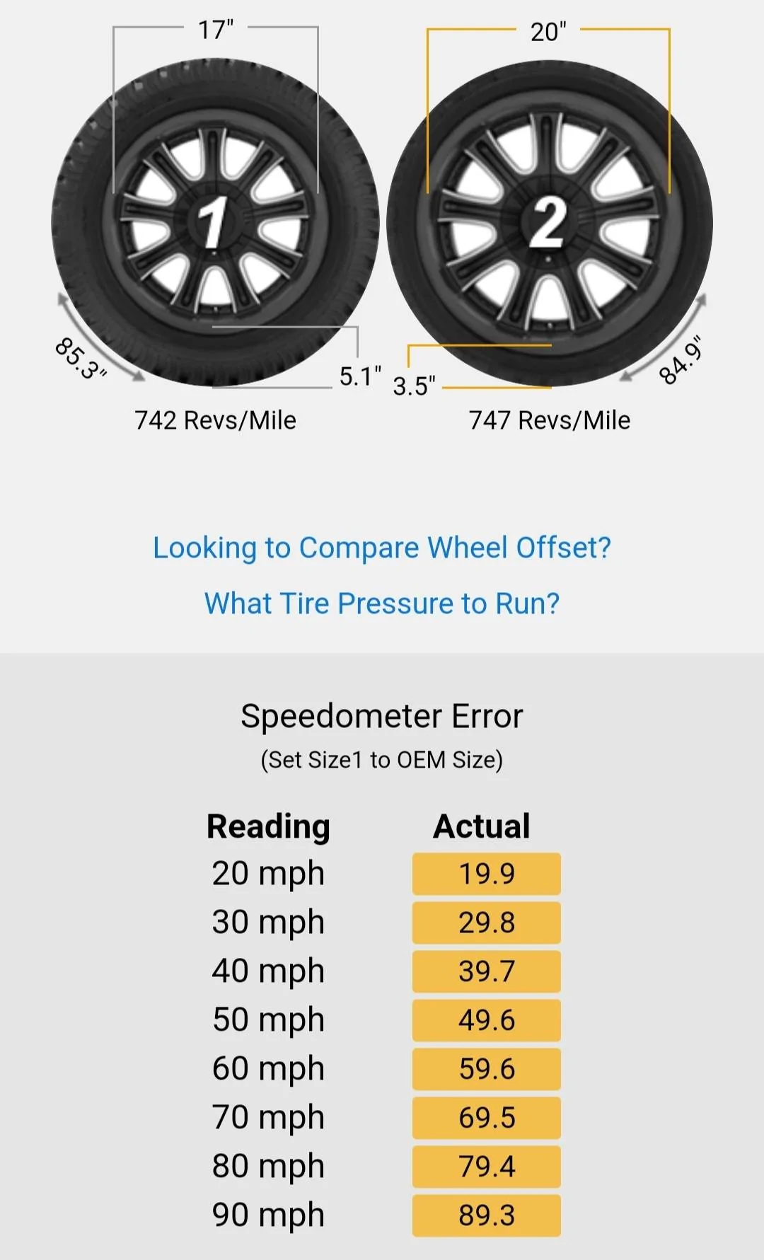

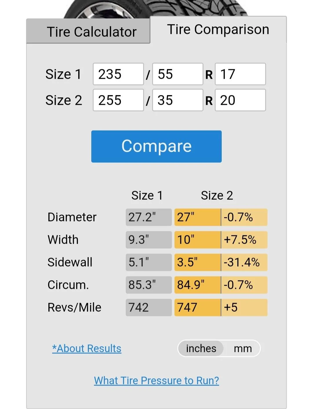

Here are the numbers if you're curious...
There's some handy sites where you just plug the numbers in and they do it for you.
But compprep is correct, there's very little difference.
Cool thanks for the information I appreciate it 👍
