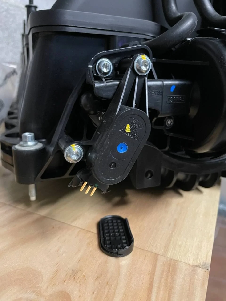

Anyone know if the IMRC valves are interchangeable between a 2017 GT and and GT350 manifold? Just received my GT350 manifold with both electrical connectors at the back and are completely destroyed, so hoping I can just re-use the ones on the GT manifold.

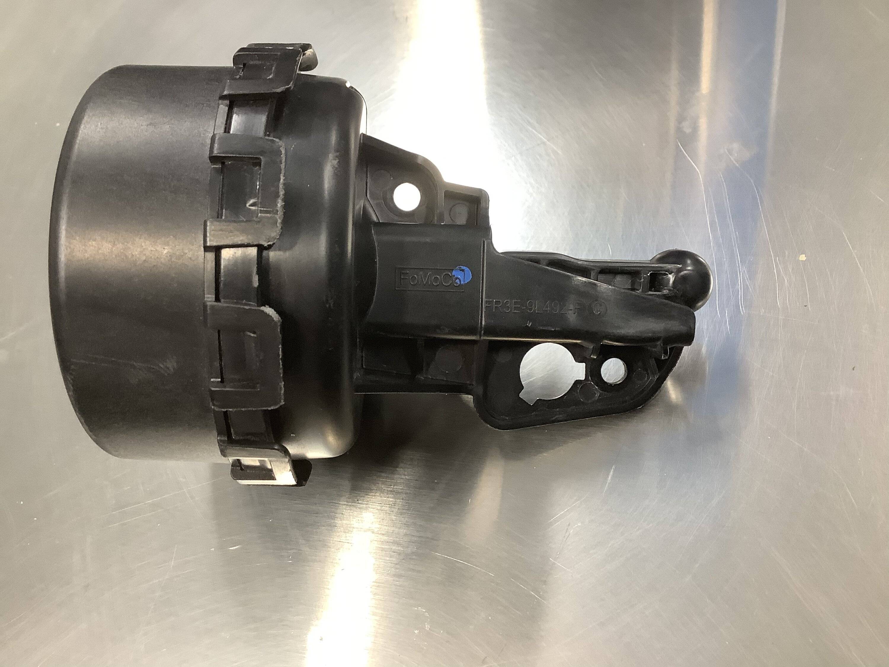

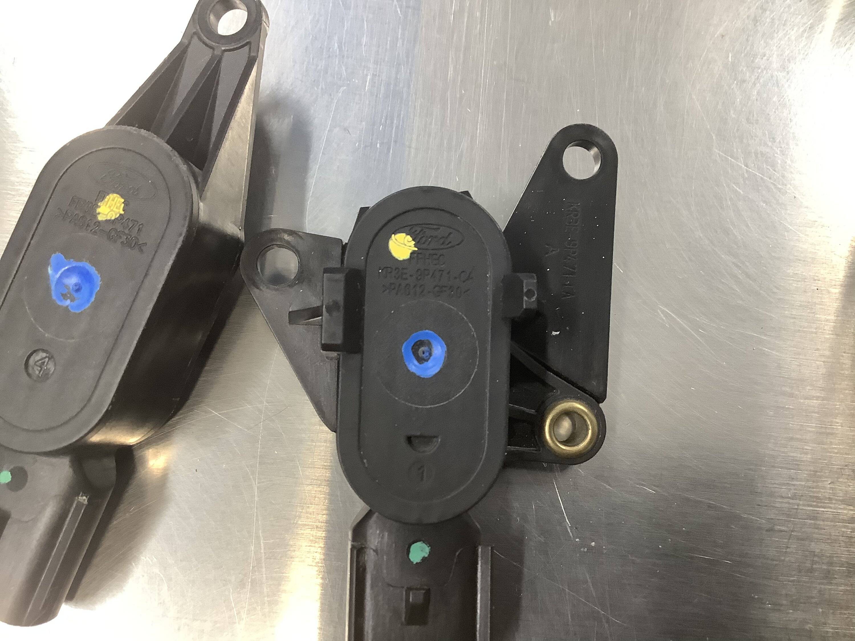

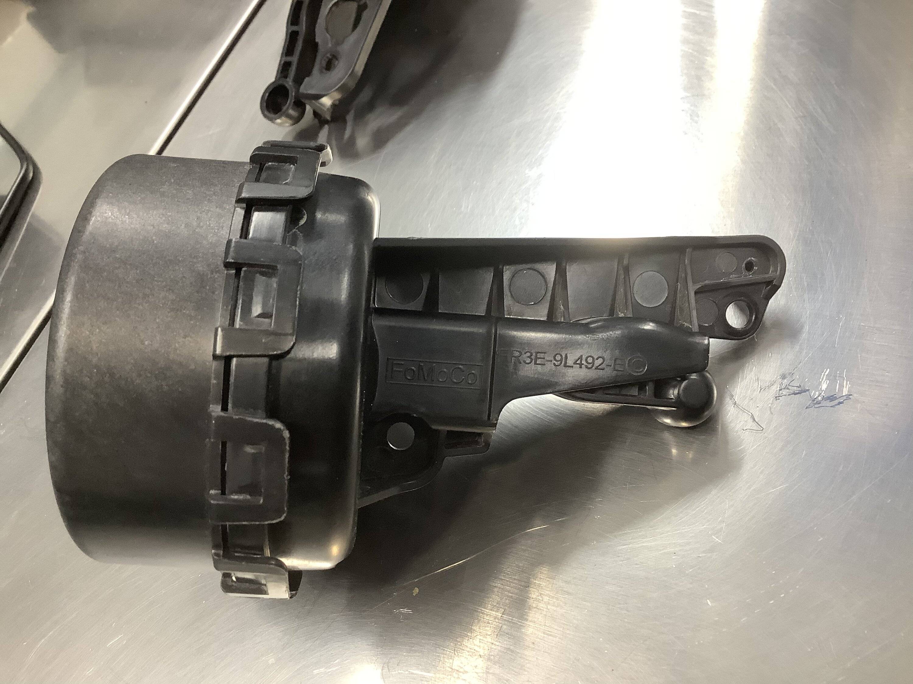

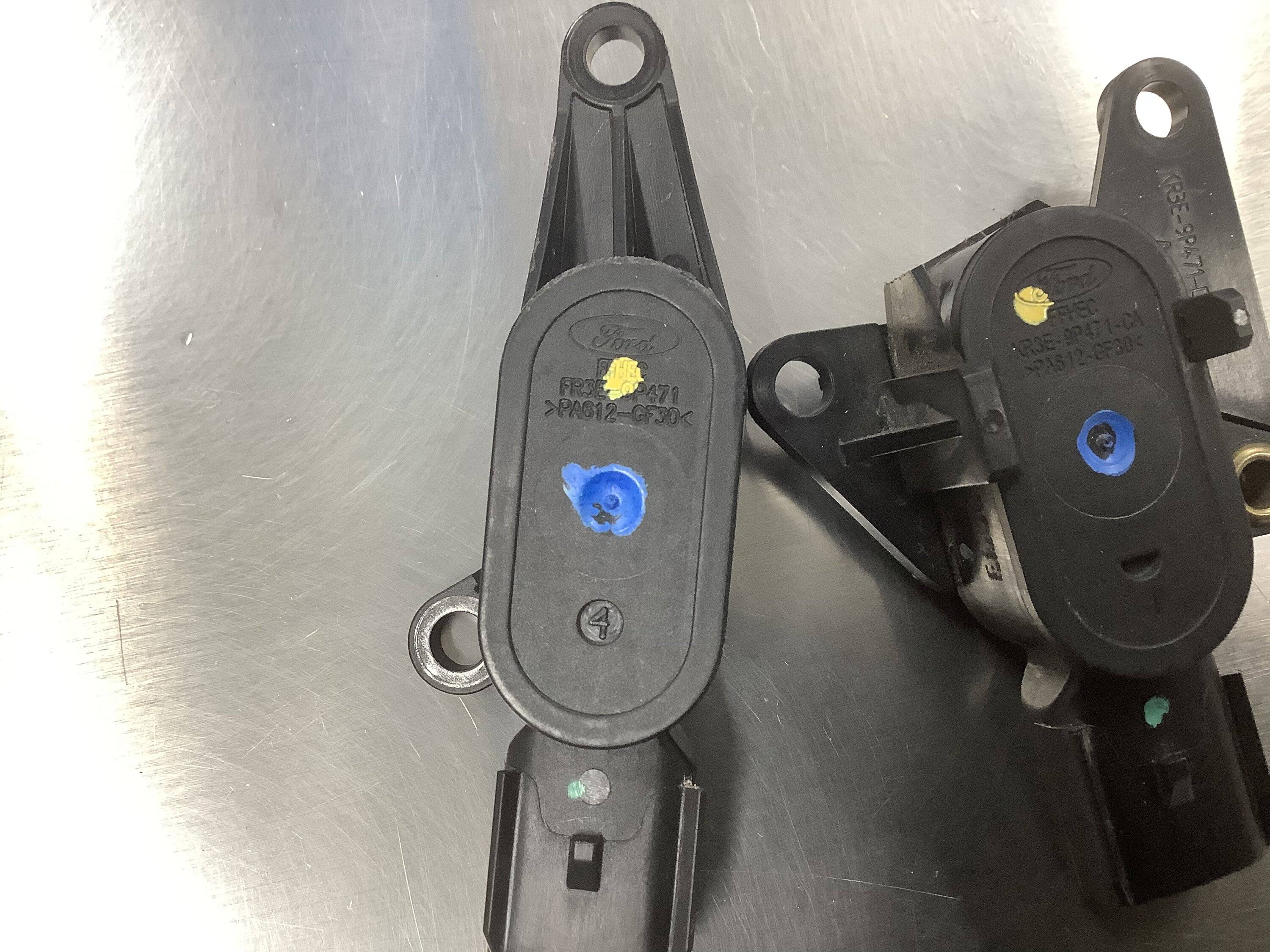

Here are part numbers for the actuators and diaphragms from my 2019 Bullitt GT350 IM. Hopefully you can use them to compare with your GT components to see if they’re a match.

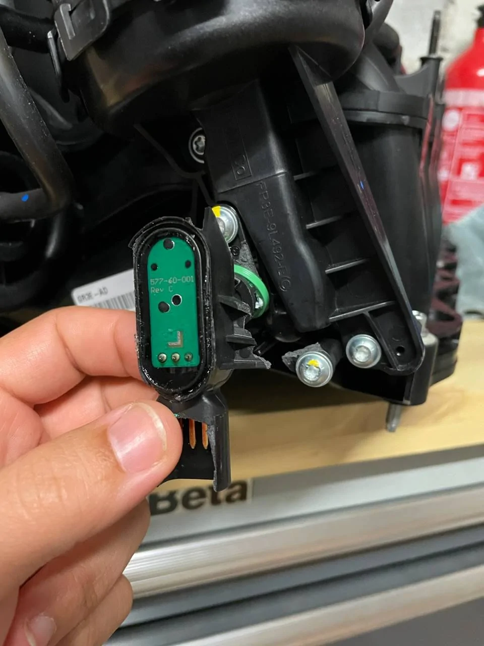

These are what I’m referring to, which looks to be exactly what you posted above, except your passenger side one is different. Everywhere seems to be on back order though.

I’ve already got the PP2 tune on my car, so wasn’t planning on tuning it. Plus, ideally I need to keep them active as they help with emissions, and we get tested every year.
The actuators themselves are fine, it’s just the position sensors, which aren’t expensive, they’re just on back order everywhere, so was hoping they’re exactly the same as the ones on the stock 2017 GT manifold so that I can get the manifold swapped over this week.
