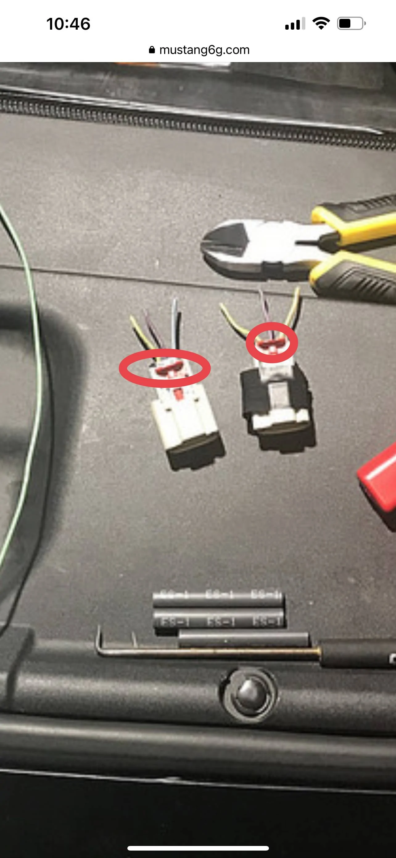

Anybody know the part number for these red locking tabs? This is for the bottom IMRC connectors on a 2g Mustang GT. Thanks!

Not serviced , Even the replacement pigtails do not com
Pigtail Kit Part Number WPT-1261
Connector Image
Service Part Number: CU2Z-14S411-MA
Gauge:16
Pin material:Silver
Cavities:3
e with them .
