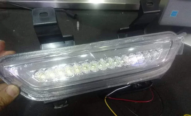

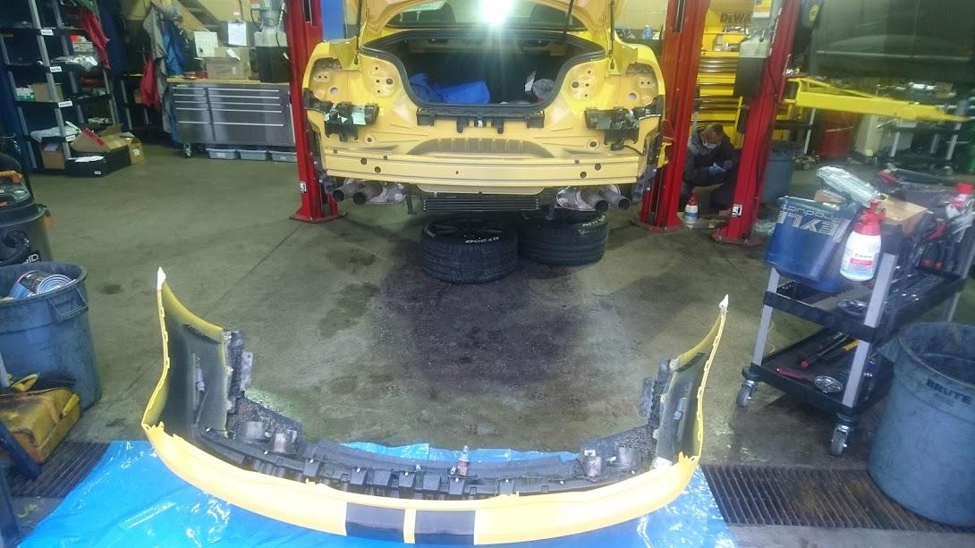

I got bored the other day so I actually installed it.
Couldn't find enough space underneath to undo the top two screws holding the assembly so I took off the whole bumper...
The thing is, the rear valance doesn't go around the assembly. It actually covers the assembly a bit. So you can't see the top of the red surrounding LED unless maybe if you're lying on the ground?

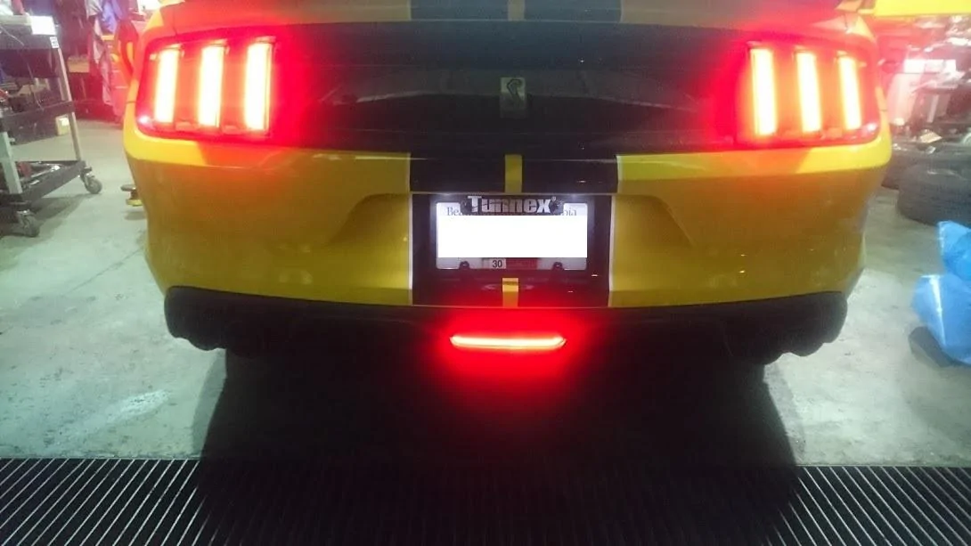

Oh wow liking this so much more than the that lame DD bulb! Quite the job though..strange that ijdmtoy says it doesnt fit; evause of the balance? Looks good to me:)
vancitygt350
New Member
Jan 23, 2017
Vancouver
2016 Triple Yellow GT350 Track Pack
They say it doesn't fit probably because they haven't really tried and the rear valance covers some of it.
All you see is the U shape red fog, unless you're faaaar away then you see the original red fog pattern.
How is the fog light controlled? Is it always on?
Mine is a Canadian vehicle so my headlamp and rear running lamp is always on (I literally can't turn off my low beam; Canadian DRL rule is different than states), which also means my rear fog lamp is always on.
For US vehicle, this new rear fog light will come on when your low beam turns on.
