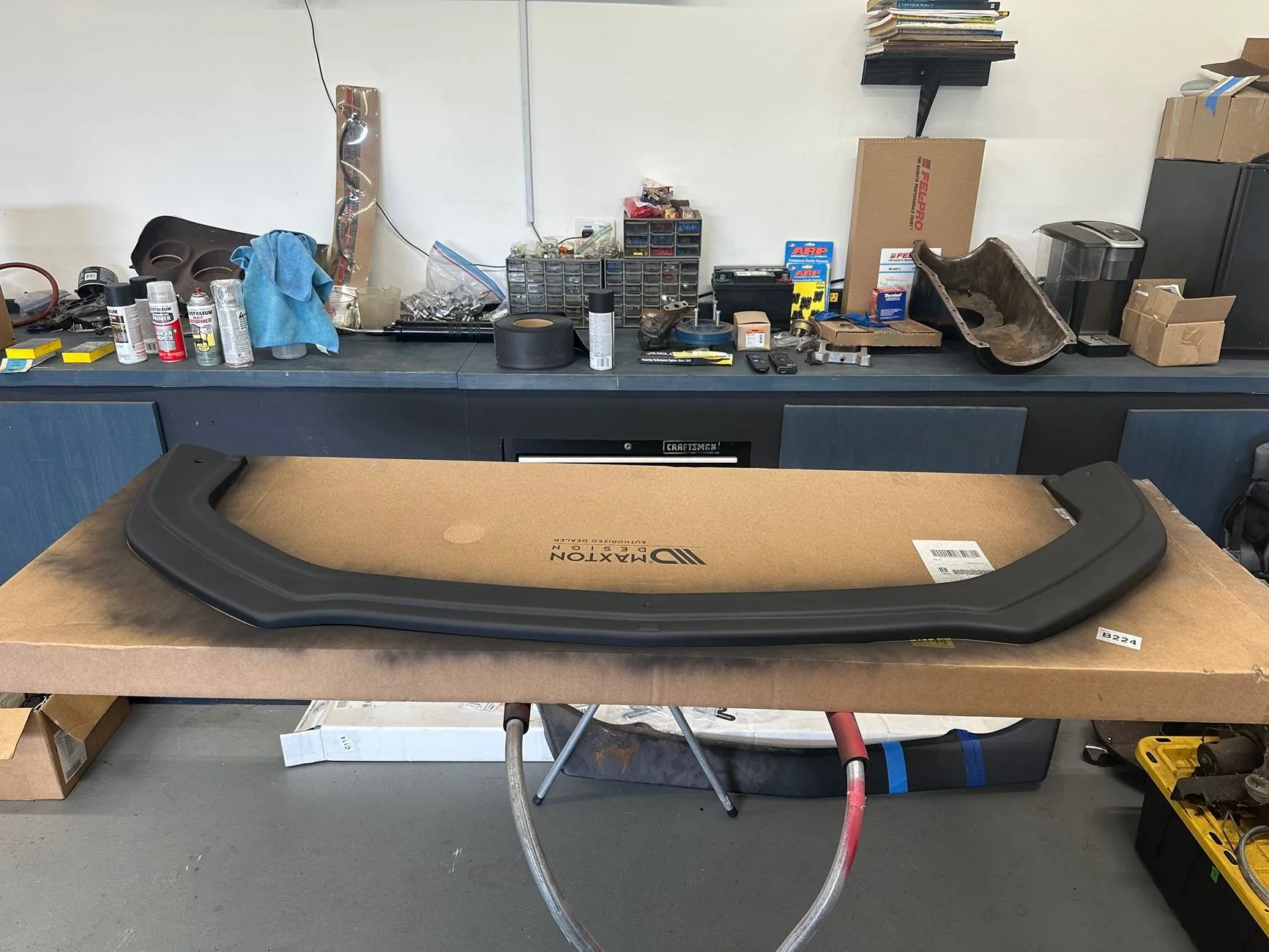

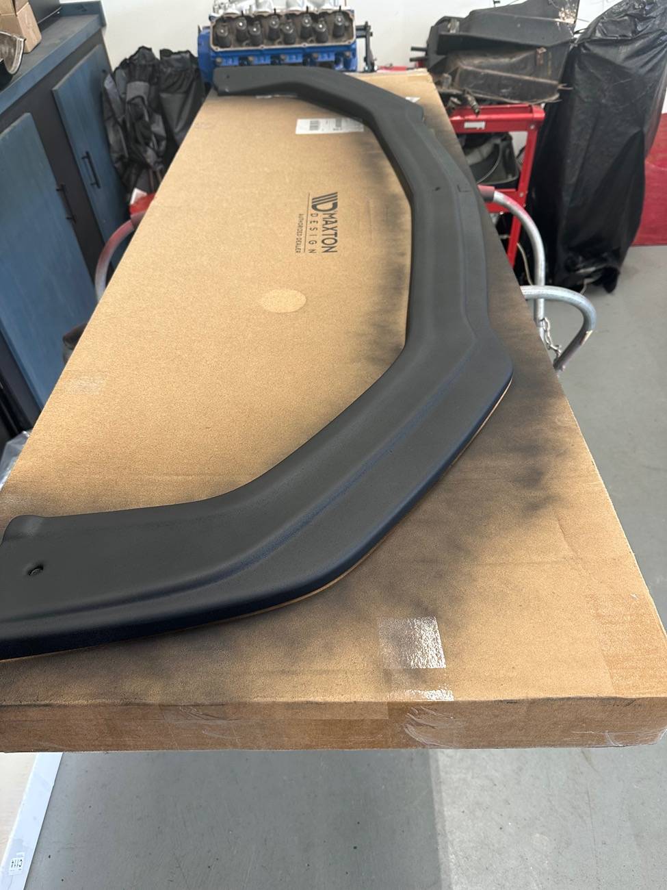

Definitely made my life a bit more DIY, but who doesn’t like a challenge! I did a full write up on another post on this forum about how I accomplished the finish. And I agree even mounting this is a bit DIY, I wish they found a way to incorporate it into the car without having to make it impossible to remove the splash shield. It’s not something you remove all the time, but if you need to this definitely makes it challenging! Below I’ve added some photos of the finished product after using some paint products to make it more like the OEM texture opposed to gloss black!

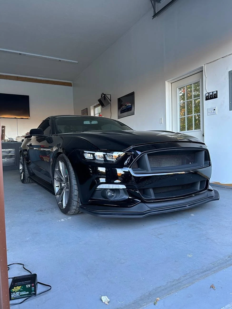

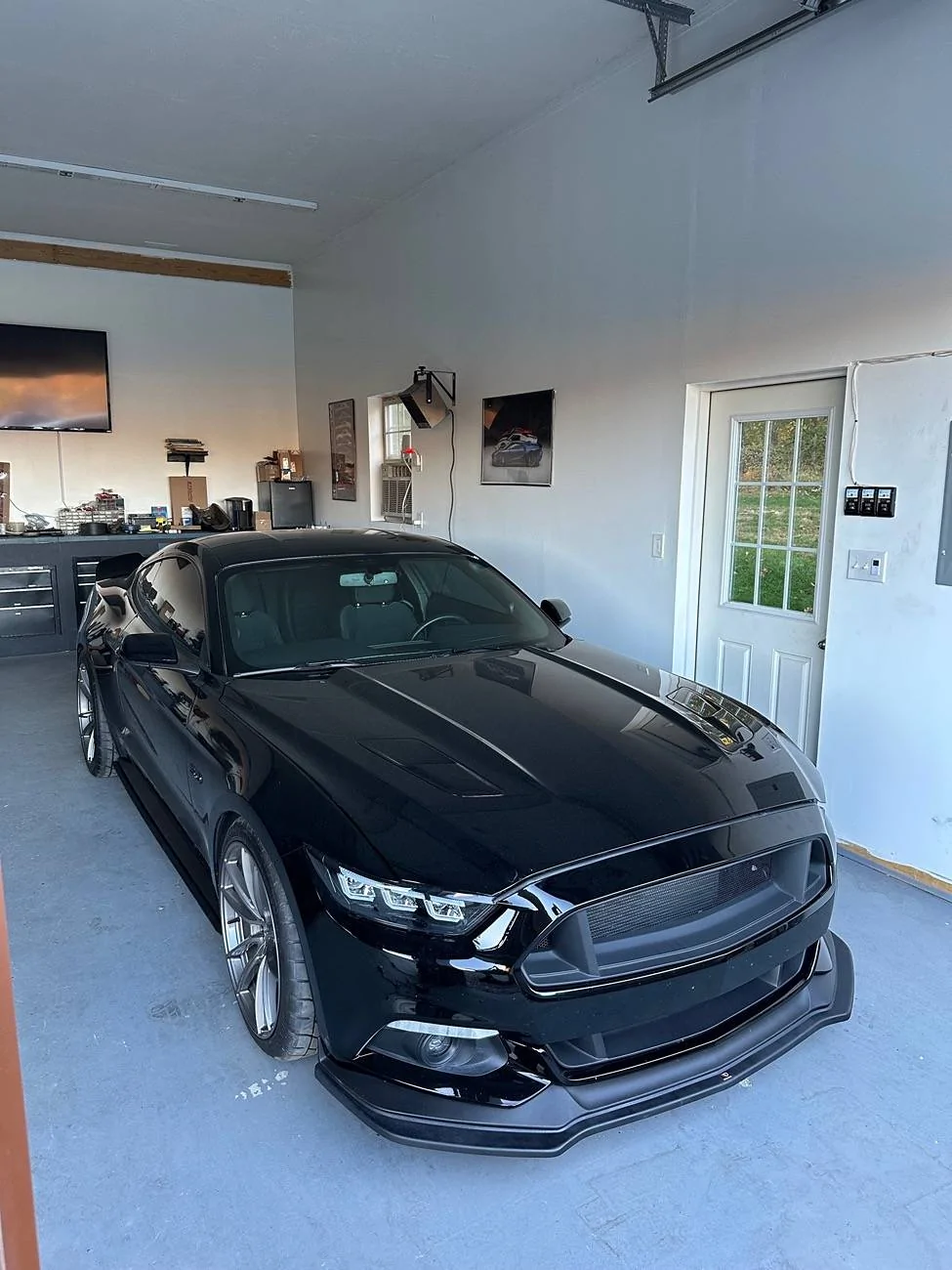

Suspension needs to settle after being on jackstands but everything is on! Love how it turned out and I feel the RTR side splitters match up perfectly to create a uniform body line. Check out my other thread to see how I painted it to match the OEM textured finish. Overall I’m super happy with the outcome!
