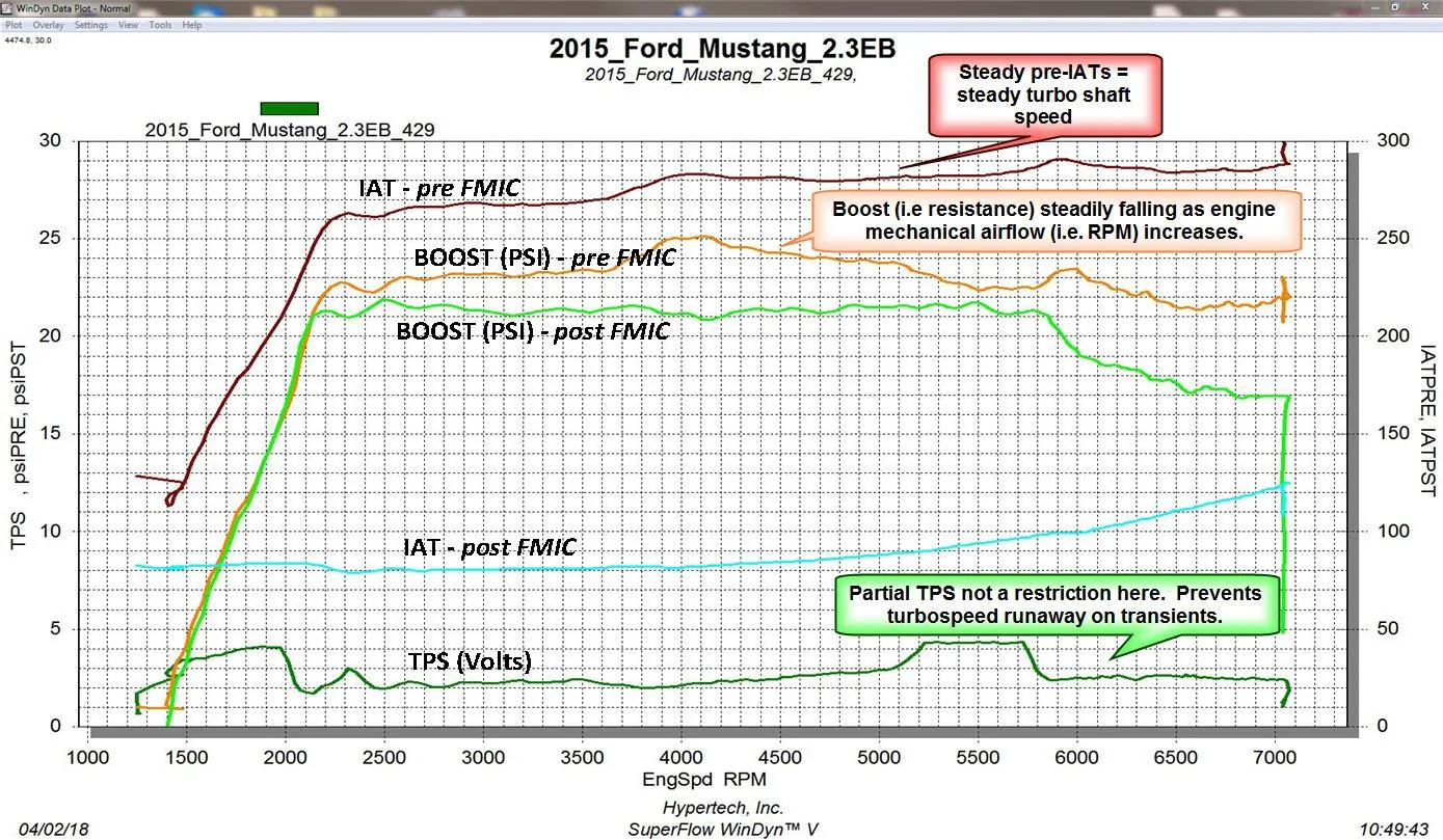

CustomS550, here is the answer to your PM you sent me...We wanted to leave it open here for others to see as well....I hope this answers your question(s) you sent me....
[FONT=Times New Roman,serif][FONT=Calibri,sans-serif]Question: Why doesn't the Hypertech tune hold boost, and keep the throttle wide open during Full Throttle to redline?[/FONT][/FONT]
[FONT=Times New Roman,serif][FONT=Calibri,sans-serif]I realize this goes against conventional wisdom for tuning cars, so give me a chance to explain why we didn't tune this car to do that. If you'll give me the benefit of the doubt that we didn't just spend 2 months tuning this car like total morons, there is probably a [/FONT][/FONT]
[FONT=Times New Roman,serif][FONT=Calibri,sans-serif]First, let me tackle the throttle closing conundrum. When we started tuning the EcoBoost Mustang we recognized that the throttle was closing during the dyno pulls. We assumed that this meant there was power to be had by manipulating the calibration to force the throttle to stay open. What we discovered was that the power difference was almost negligible. We had a few discussions about this, and realized that the airflow is under pressure and thus a throttle body that would be too small for a naturally aspirated engine is clearly fine under boost. But we didn't want to disregard the idea that full throttle is best, so we saved that tune to compare with on the street. When we hit the street we compared partially open throttle, and the wide open throttle and found that they felt the same at wide open throttle, but drivability was much better on the partially closed throttle tune. [/FONT][/FONT]
[FONT=Times New Roman,serif][FONT=Calibri,sans-serif]The reason for this goes back to the torque model. All of the engine controls are based on the torque model; power, economy, traction control, transient power, boost response, etc. If the torque model is wrong then the drivability and controls suffer from these inaccuracies. We came back to this when we added FMIC, piping, air intake, downpipe, and exhaust, and saw the same results. The throttle not being wide open isn't a restriction, and allows for linear power delivery because the torque model is correct. This really becomes evident when you drive the car with these altering methods back to back.[/FONT][/FONT]
[FONT=Times New Roman,serif][FONT=Calibri,sans-serif]Now let's dive into the boost curve. What do most car guys say when you tell them you're Mustang is turbocharged? Almost without exception it's "How much boost are you running?" If you've ever looked at the stock boost curve on the EcoBoost Mustang you'd have a difficult answer because it comes up in the lower RPMs and then slowly drops towards redline. We've seen similar curves on just about every boosted gasoline engine we've tune over the years. We dug into this in detail when we tuned the Mazdaspeed 3, and it made us rethink what thought we knew. The problem is we were thinking about the engine, and not about the turbocharger. Everybody knows that the engine is and air pump. It sucks in 2.3L of air every 2 revolutions. Yah, yah, yah. But how much air is the turbocharger pumping? If you've ever dug into turbo chargers you've seen a compressor map which shows you the efficiency of the turbo in relation to airflow and outlet pressure. These maps all have shaft speed lines on them, and those lines drop sharply as the airflow reaches the maximum of the compressor. That's to say that if you hold a steady boost level and keep increasing the airflow the shaft speed will increase dramatically. So, the reason the stock boost curve starts high, and then drops off is to maintain the turbocharger shaft speed. If you want the turbo to live, this is how you have to tune them![/FONT][/FONT]
[FONT=Times New Roman,serif][FONT=Calibri,sans-serif]Another thing we've found is that a partially closed throttle near redline helps boost response after the shift. With the throttle fully open there is no resistance to the turbocharger, and the boost curve is maintained by wastegate alone. By adding a little resistance the wastegate can response quicker to the post-shift boost level because it doesn't have to move as far. Plus, after the shift the throttle can open up and the turbo can bring in the lower RPM boost much quicker without overspeeding.[/FONT][/FONT]
[FONT=Times New Roman,serif][FONT=Calibri,sans-serif]<<see pic for this part>>[/FONT][/FONT]
[FONT=Times New Roman,serif][FONT=Calibri,sans-serif]When we tuned the EcoBoost Mustang on our dyno we outfitted it with extra thermocouples and pressure sensors and datalogged those on the dyno during pulls. We measured IATs and Boost out of the turbo (pre-FMIC) and after the intercooler (post-FMIC). This let us monitor the efficiency of the turbo and the intercooler to determine the optimal boost curve to provide power without shortening the longevity of the turbocharger.[/FONT][/FONT]
[FONT=Times New Roman,serif][FONT=Calibri,sans-serif]You can see that the IAT - pre FMIC (aka post turbo) curve is almost totally flat. This tells us that the turbocharger is running a steady speed. Notice that the air temps out of the turbocharger are climbing to 290F by redline! The resulting boost curve at the engine (post FMIC) is relatively flat until about 5700RPM which correlates to around peak HP. After peak HP the turbo engine's mechanically increasing airflow (aka RPM) causes the boost curve to drop from here to redline because if finally wants more airflow than the turbo can provide without destroying itself. Remember, boost is just a measure of resistance to the airflow provided by the turbocharger. To hold boost steady above 5700RPM the turbo would have to increase the shaft speed tremendously! The result would be shorter turbo life, and less efficiency. Those IATs out of the turbo would skyrocket with 20PSI at redline. Yes, an upgraded intercooler will knock the temps down, but it won't keep the turbo from overspeeding. Speaking of the intercooler, do note that the IATs out of FMIC are much better on the road where there's much more airflow than possible on the dyno.[/FONT][/FONT]
[FONT=Times New Roman,serif][FONT=Calibri,sans-serif]I know that's a lot, but I wanted to shine some light onto why our tune is doing what it's doing. On the surface it may not fit the standard mold for a tune, but there is a lot of work and outside the box thinking going on to develop what we have. It took us over 300 tunes to get it right for the Max Energy 2.0, so we tried a LOT of stuff to figure this all out. That's not to say that everybody else is doing it wrong though. The ECUs in these cars are very complicated, and there are lots of smart guys with happy customers making tunes for these cars. I am not here to downplay anybody else's tunes or their methods. I'm just telling you what we did, and what makes sense from what we saw along the way. I don't assume we have the only right answer. We learn more every time we tune a new vehicle which is great for our customers and fans. We loved tuning the EcoBoost Mustang, and hope you love what we've done to make you enjoy your car even more! [/FONT][/FONT]

Thank you, fellas, for the wealth of information. By no means was I questioning your ability as a tuning enterprise, and I think that there's a misunderstandings here. I see that the above graph shows post-FMIC boost pressures of around 20-17 psi, however in my case the turbo shows nowhere near the pressure numbers as the graph above. I only see a max of around 17 psi as a spike if I full throttle below 4k rpm, then it falls down to around 14-16 psi for the rest of the rpm range. Everything else, like the throttle response improvement and the part throttle fuel enrichment are working as advertised. I did about 10 different full throttle pulls, and have gotten the same results over and over. I tried the previous tuner to make sure that there isn't a fault with a sensor or two in my engine, and right away the pressures were holding strong and flat @ 20psi all the way to 6k rpm, and the rear tires breaking loose in second and third gears (wet pavement) :)
Thank you!
