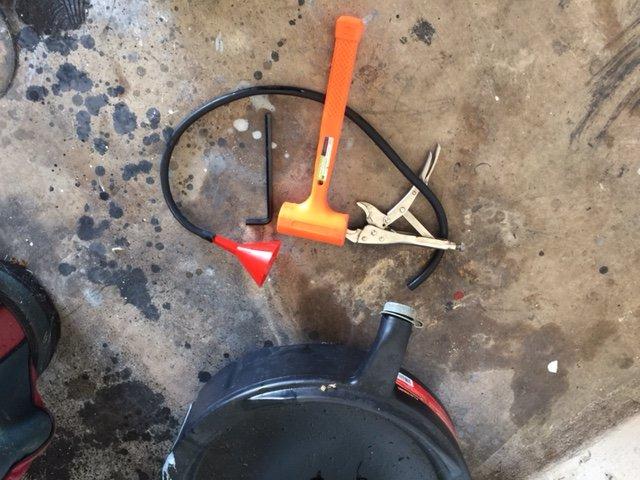

TOOLS REQUIRED
8MM ALLEN WRENCH
Vice grips
Dead Blow Hammer or Rubber Mallet
1/4 Vacuum Hose 3.5ft
Small Funnel
Chanel Locks
and 3QTS of Your favorite Trans Fluid. I went with Royal Purple Synchromesh

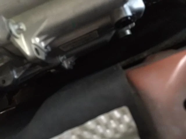

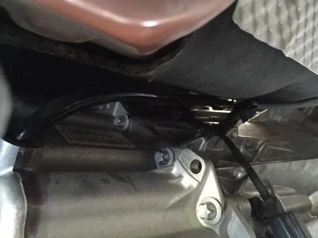

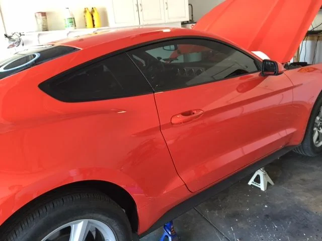

1) Jack up the car and make sure car is level. Be sure to push against the car before ever crawling under. This way it doesn't fall on you.

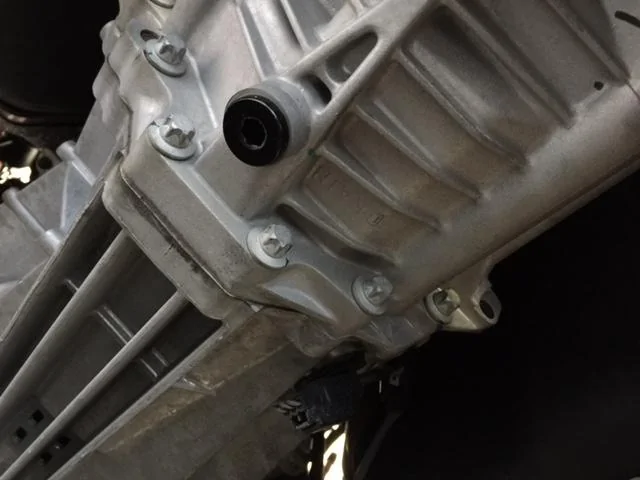

2) Locate the fill bolt on the passenger side and use the 8MM Allen Wrench to loosen. You may or may not need a dead blow hammer to tap the allen key so the bolt can come out. My worst fear is stripping the allen keyway and so I used the dead blow so I could focus on keeping the allen wrench straight.
3) Grab your oil catch pan and place under drain hole. loosen drain hole similar to the fill hole and let the trans drain for 15 min

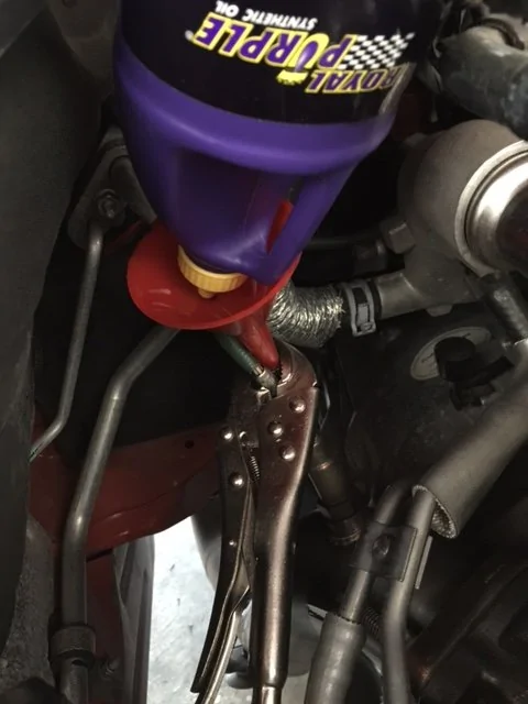

4) Next replace the drain bolt and use the funnel and 1/4 vacuum hose to fill the trans. run the vacuum hose along the trans tunnel up towards to the turbo.
5) With the funnel attached to the vacuum hose. Use a pair of vice grips and lightly clamp the funnel to the o2 sensor to prevent the funnel from spilling while you pour. Do to the size of the funnel and diameter of the hose this will take about 20 min to use all 3 qts. by clamping the funnel it reduces the amount of fatigue and allows you to step away to grab the next qt in between fills.
6) After you have filled the trans replace the fill bolt and lower the vehicle. Please note you will have some trans fluid run out of the fill hole this is normal as the trans req slightly less than 3 qts.
