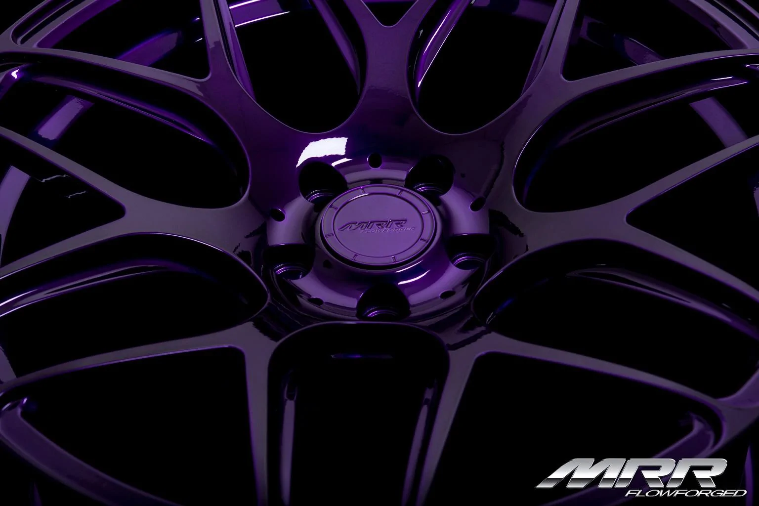

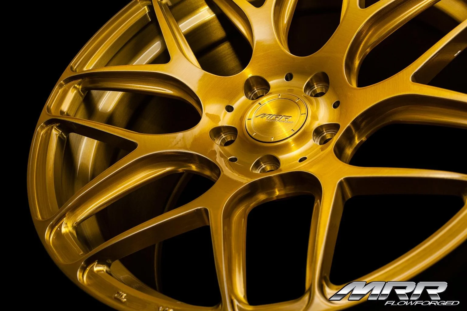

By the way dont miss out on our Pre Black friday . Here are just a few color samples.

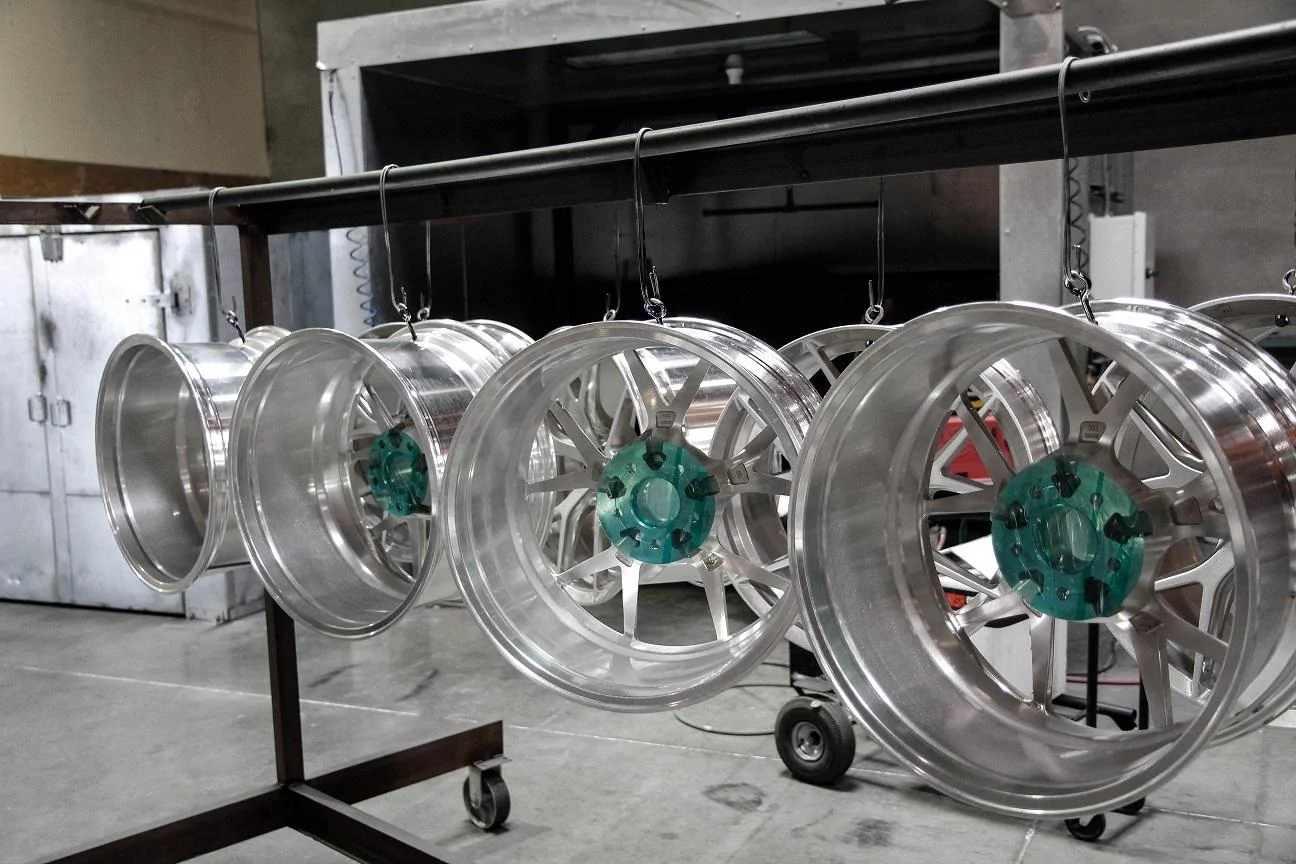

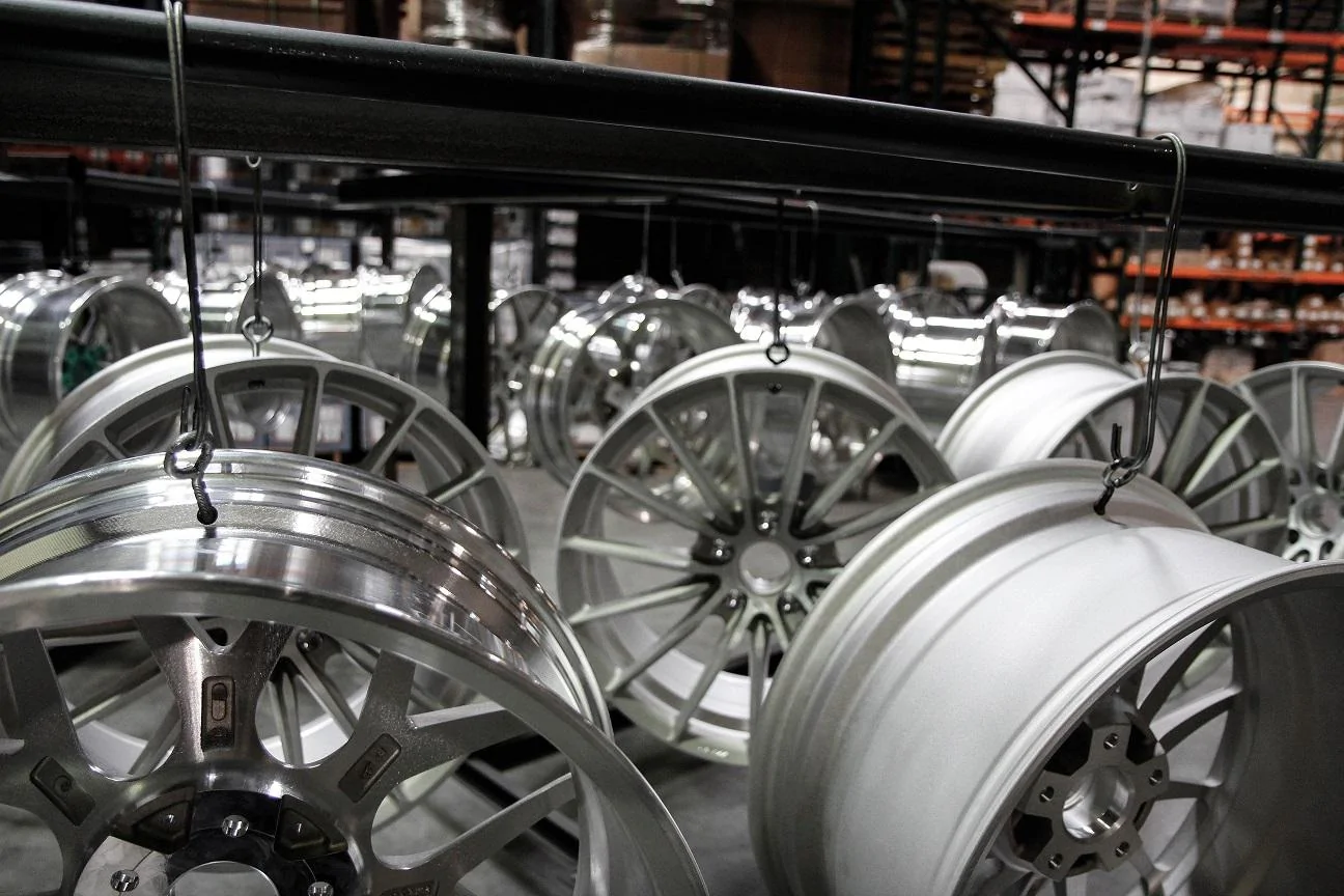

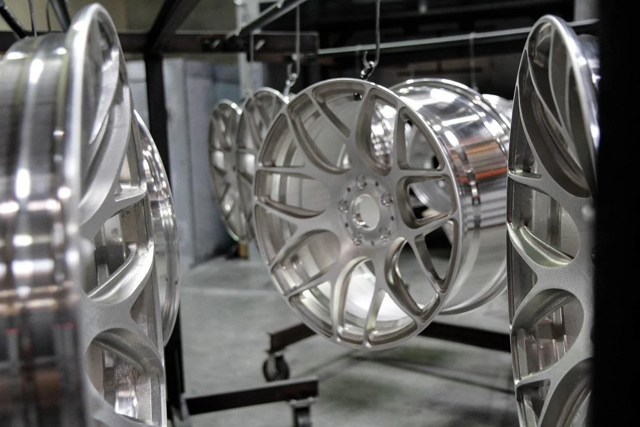

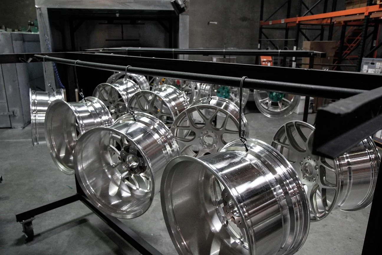

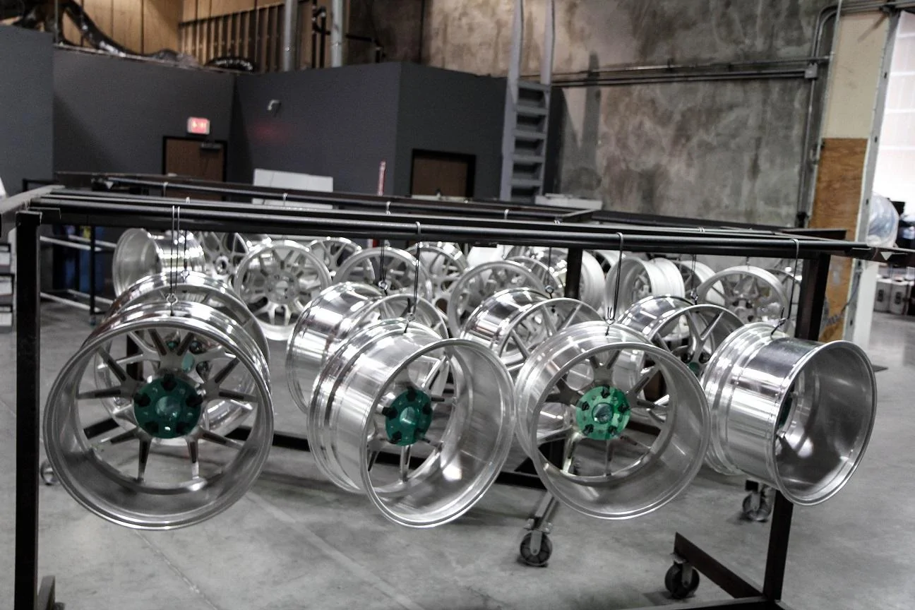

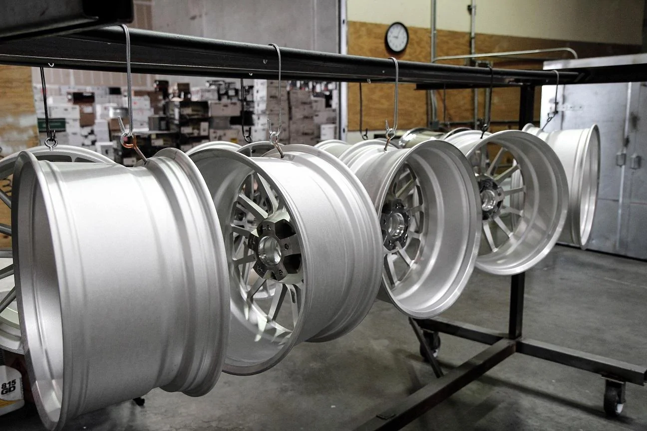

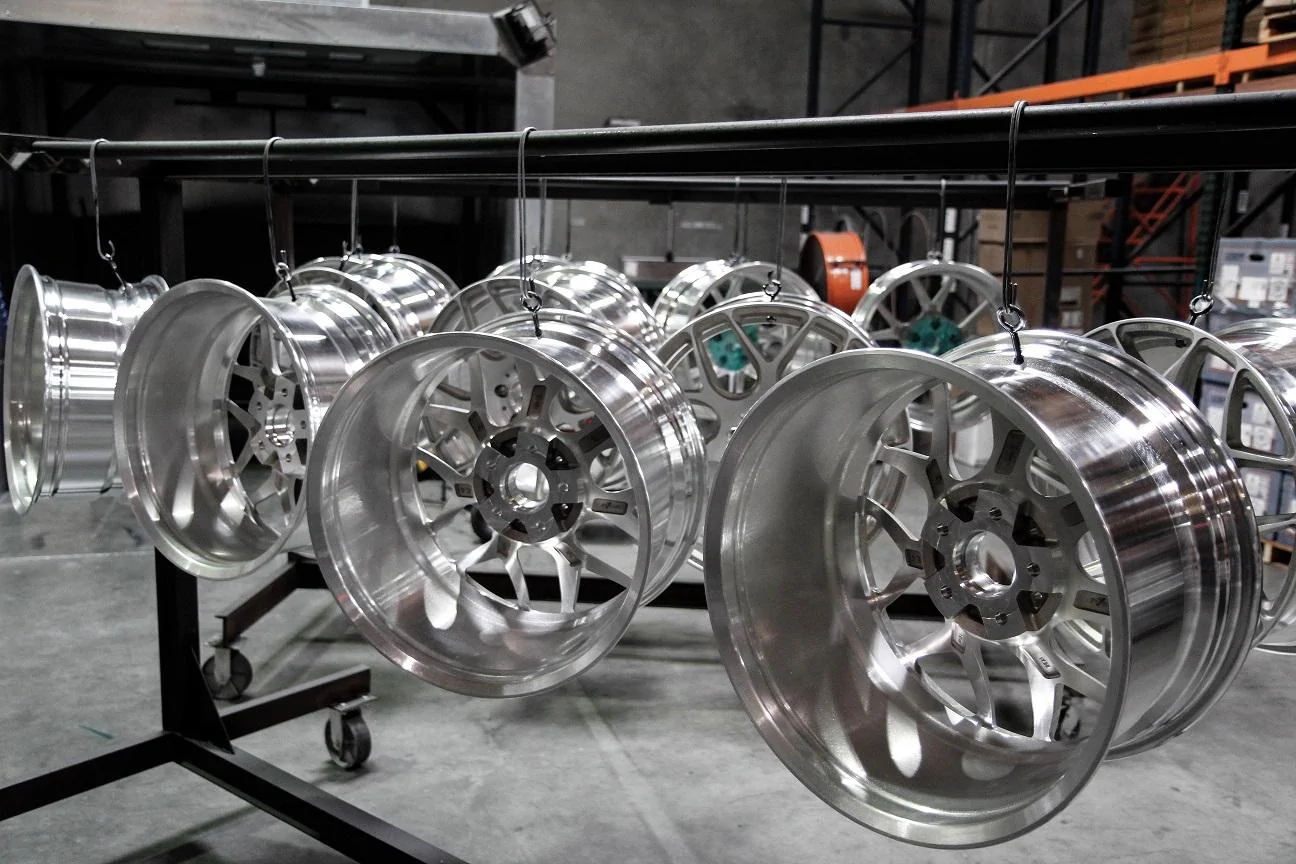

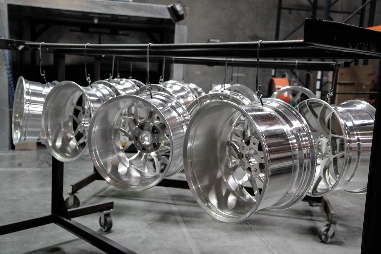

Todays work flow
Here is a quick look at todays work flow, we are talking about a total of 6 sets on the hangers and 2 sets inside the oven this is over 25 grand in wheels and custom finishing.
Aside from our work flow it shows how polished out many of our wheels need to be in order to start applying powder some have brush affects some are transparent colors and others are standard Gloss finishes.

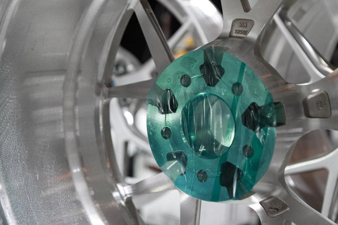

you can also see a set of FS06 and FS01 that currently have the Special high temperature tape on each center bore and back pad and will be added to the center bores, this eliminates any possible paint to land in this area which can cause trouble ones on the car.
