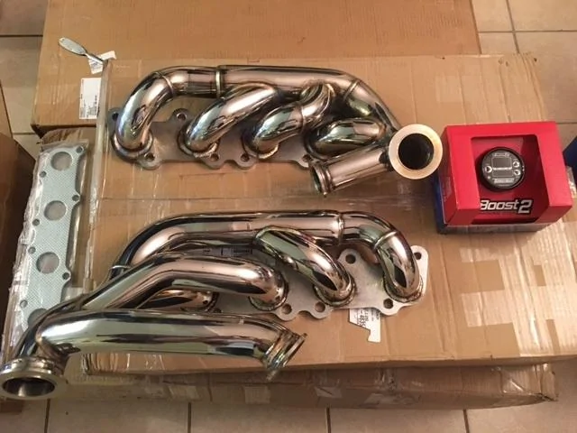

Cant wait to see your results, did you go with 62's? I assume Ken is doing the tuning? Should be a beast!
Yessir, 62's. Ken B tune is loaded, going to start data logging and hit the dyno/strip asap.
