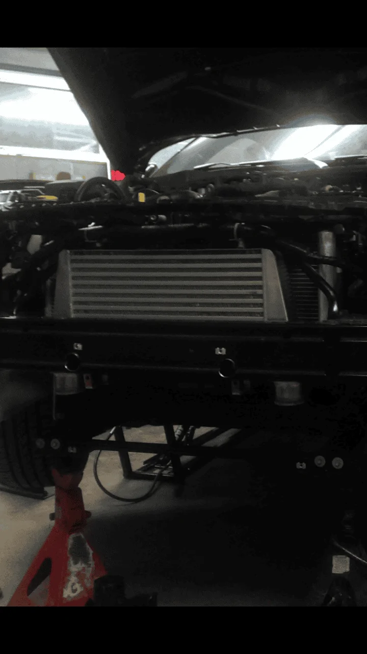

I have a eb non performance pack, so small radiator. Would I get much benefit tossing a ford performance radiator in it? Or any aftermarket ecoboost tafiator
How much of a pain in butt is it? I assume remove belly pan, unbolt the intercooler hopefully be able to slide the radiator up after intercooler is loose.
Or does intercooler have to come out? What panels are required to remove for radiator swap?
Is there any programming that needs done afterwards or nothings changed? Any pros cons to swapping from baby radiator to ford perf?
thanks!

There is a lot of room under the hood of your Mustang. My radiator reservoir, air intake, and factory intercooler have relocated. But they came out easy and should go back in just as easy. This will give you enough room (to make any modifications if needed) for a better performing radiator and fan!

Sounds like I am going either CSF or mishimoto, my car honestly stays in green, but during summer when im doing some hard playing, it'll go up into the yellow and I have to drive it for a minute or two to get it back down to green.
That worried me really, so I figured a better intercooler would be better. I like the idea of the mishimotos intercooler attachment arms, I could in theory...
toss car on lift, use a cutting tool, cut the stock plastic radiator arms that hold my aftermarket intercooler off, and pull radiator right up out without removing intercooler.
then put the mishimoto down in there, and I can attach the little intercooler mounting arms, from the bottom, just put it in same spot as the original, and use the 2 bolts and tighten them to radiator while under the belly pan.
make the job a lot easier, it was tight to shove my CPE stock spot intercooler in without removing the bumper, Lol and I don't really want to remove it ever. I think I could do this easily with mishomoto attachable intercooler arms and leave intercooler where its at. just gotta cut the brackets off though to be able to detach it from intercooler to lift OEM out.

Removing the front bumper is easy, just (4) bolts and a dozen screws, belly pan comes off easy and you can pull the intercooler out with a little push and pull. Worth the effort!
The 15-17 bumper removal is not as easy as the 18 up models, there are tabs in there that easily break (been there).
