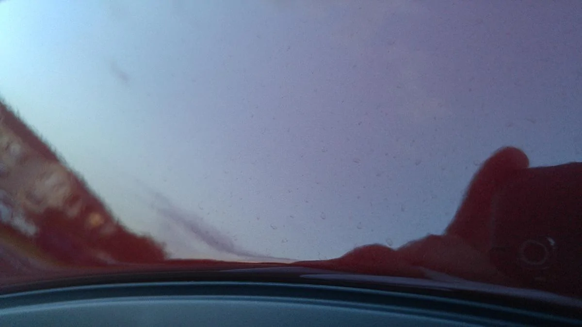

I was calling it polish because I use Zaino and its not simple wax like Turtle Wax. Nevertheless, its not working.
I washed it today (in the shade, kept it wet, then dried with chamois and microfiber towel) and treated one side is all I had time for. First I did the clay bar, lubed with some vinegar/distilled water mix, then applied Zaino Z2. After wiping it off the finish is very smooth and clean but this is how the spots remain. I had to try different angles with the camera to get it to show up. The larger dark streaks are reflections of clouds.
I don't know what to do for this. :(

If I read the product description correctly, Z2 is a jeweling polish with sealant (like Menzerna Powerlock). It has no cleaners or abrasives so I'm pretty sure you won't get anywhere with it. You could try 2-3 passes of Menz 3500 with a light cut/polishing pad and then apply Z2 for protection.
From Zaino application instructions: "2. If your car's surface isn't in optimal condition, take the necessary steps to correct any imperfections before applying Z-2 PRO... Z-2 PRO™ contains no cleaners, and no abrasives, therefore the surface must be in good condition before you apply Z-2 PRO™."
Another thing you could try if your paint has no defects except for the water spots is some cleaner wax like Megs #20 or Mothers. No abrasives but would probably get those spots out and offer a layer of protection. Then after a couple of washes apply Z2 for durability. An effective accessible solution and cheaper than a bottle of Menz 3500.
