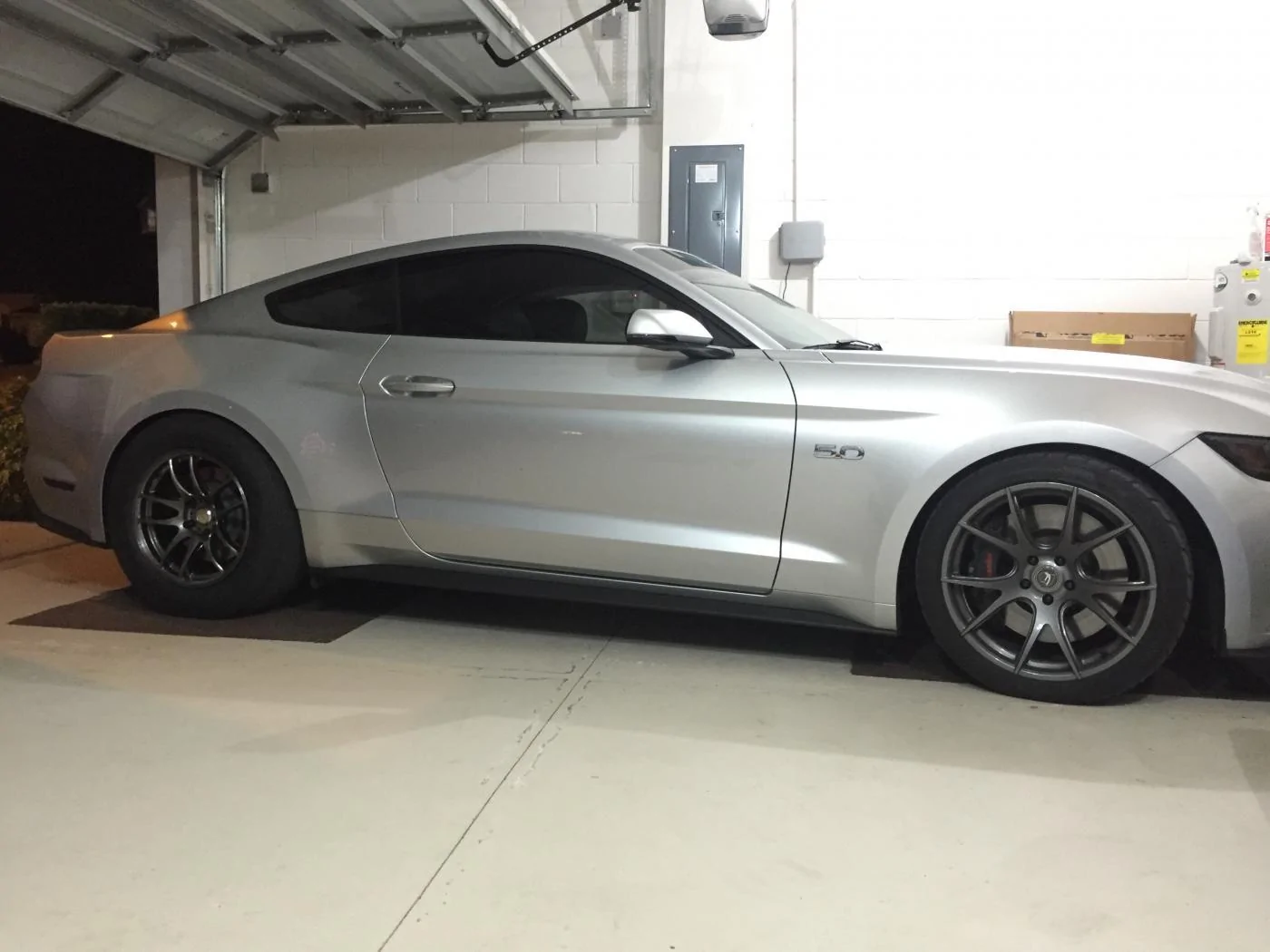

Perfect fit on GT/PP

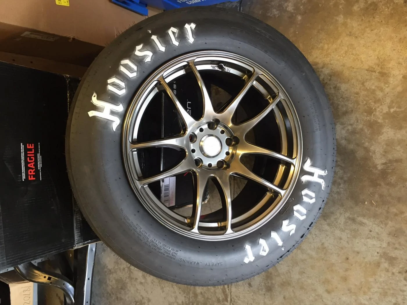

caustin69
Nov 27, 2014
535
146
Curtis
2020 Iconic GT500/ 2021 F150
Which tires are you using? I've been trying to find some besides the MT Street R's cause they're sold out everywhere.
E: just noticed you're a manual car so I guess I can't really compare!
Hoosier 28x10x17
caustin69
Nov 27, 2014
535
146
Curtis
Are you running tubes with your slicks? Did you balance them? And what tire pressure are you running?
No tubes, no need to balance since tires will probably spin on wheel. So far on the street I have them @20psi.
