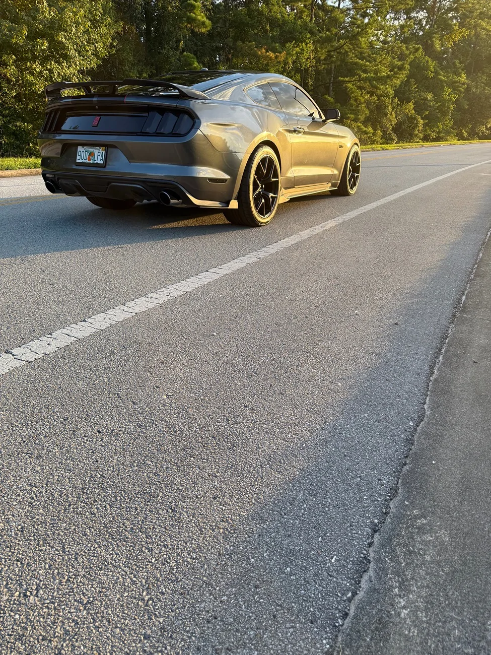

Hey everyone I have a 2015 gt premium on lowering springs not exactly sure what kind but for some reason the rear is higher then the front on the front there is about a 1 finger gab from tire to fender but on the rear it’s about a two finger gap and a little room just wondering why this is and if the rear was installed improperly

you think so? They are 35s front and back it might look like that because previous owner put spacers in front and not in back I’m about to take off

19s front and back too on stock suspension just springs

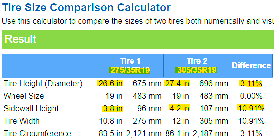

Are the front and rear tires different sizes? The "35" is the ratio, so a wider tire will have a taller sidewall.

305s in rear 275 in front 50 offset rear 35 in front
If your tire sizes are
F: 275/35/19
R: 305/35/19
then there is going to be a tire height difference, as you can see in the table below:
