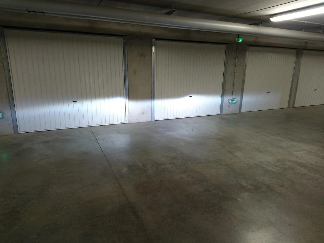

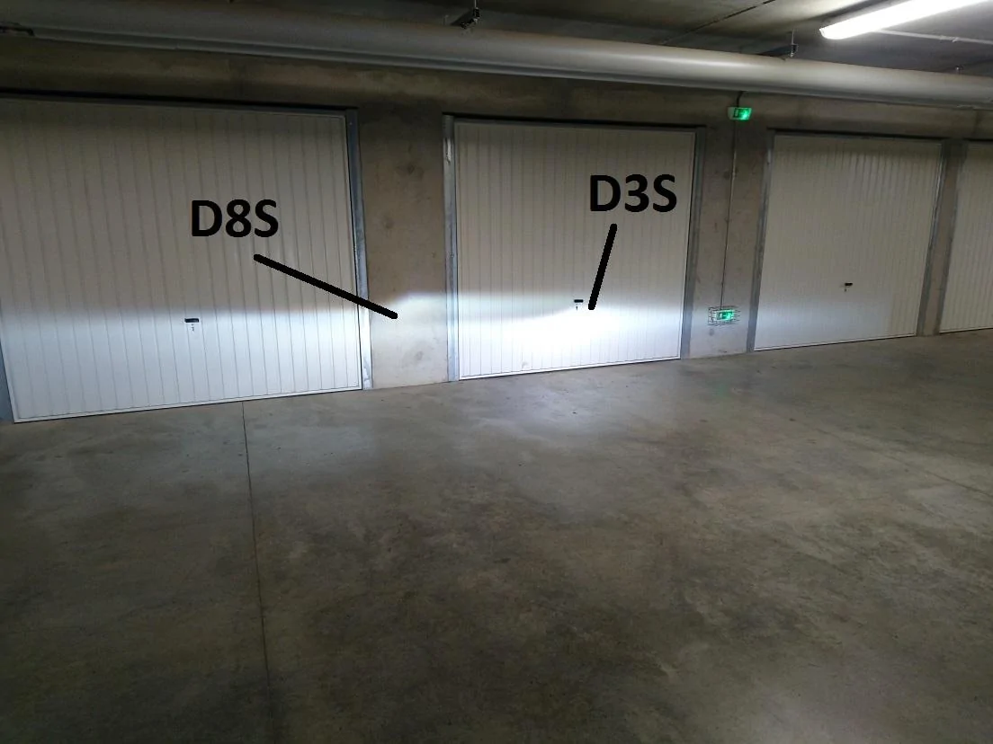

Not easy to replace. You need either to modify the D3S bulb or the headlight to have them fit in place.
I did the swap on my car and the light output is much better, not as great as a designed LED headlight, but really better as our D8S 25w HID :thumbsup:
D3S :
