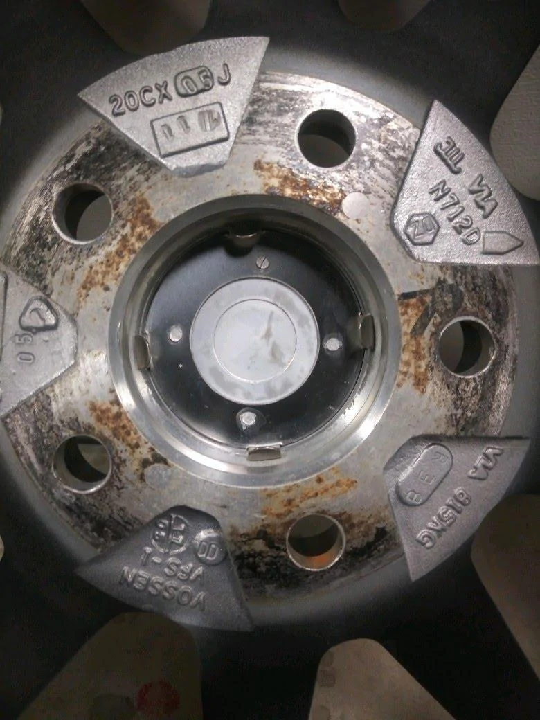

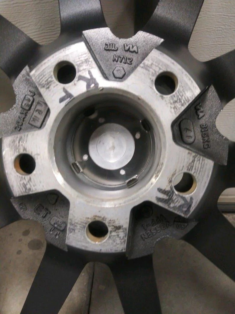

Found some Vossen VPS1 wheels but the guy doesn’t know the offset etc. and want to make sure they’ll look right before purchasing. They came off a 2017 Mercedes G350 he says. Can anyone read the fitment off the back of the wheels? Any help would be great. It’s a staggered setup.

If they are off a Mercedes G350. That's the wrong bolt pattern. So they won't work without adapters.
The bottom one looks to have a +32 and I can't really figure out the offset of the top. Maybe +50
Either way without knowing the widths, it makes it a little harder to figure out if they will work.
But again they will be the wrong bolt pattern if they are off a Mercedes

Ok, that will be the same bolt pattern then. The next problem is if they are hub centric.
Nissan/infinities have smaller hub bore's than we do.
So I would check that first.
But back to offsets. I can't figure out the first one. You might have to do the measuring yourself.
Do you at least know the wheel width?

So the fronts are 9 and the rears are 9.5.
