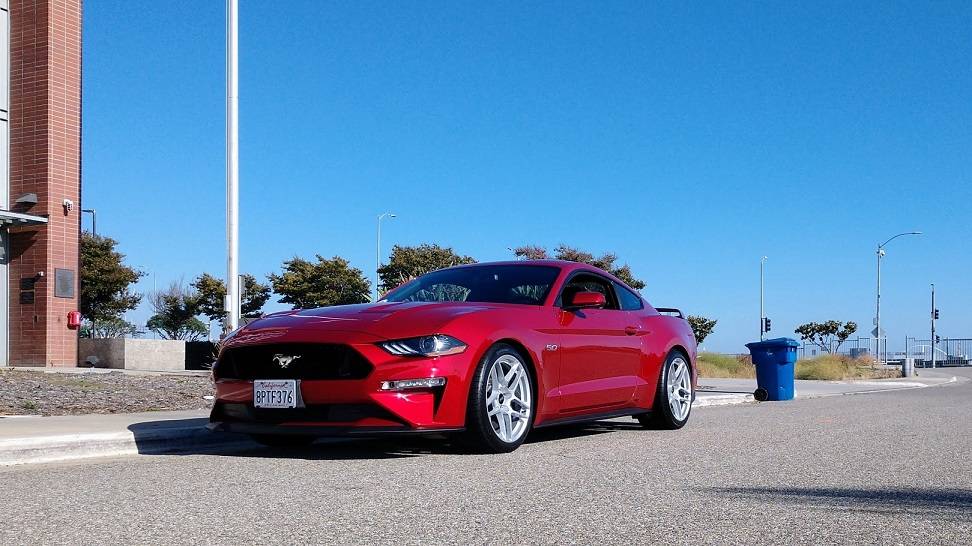

I went with the FRPP Track kit. This is the way the car should have been from the factory. A tad stiffer than a PP1 but much better control especially in mid corner control with undulations. Only lowered my car .875" front and .75" rear. I liked the fact its still Ford branded.

Stangtime, thank you for your input the the Google doc. The data will help me make an informed decision. Steeda Ultralites are looking like a solid middle ground, but the drop in the front may be too much.
Dave, your stance is phenomenal and I’m thrilled to hear you’re enjoying the Track Kit. That comes with progressive springs, correct? For what I’m looking for, I’m leaning towards linear springs for overall predictability.

Tristan I like the FR struts/shocks over the Steedas.
Dave, would you mind measuring the height from the ground to the fenders on your car? I do like the stance. I have the same wheels and running the same 275/40R19 tire size so wanted to replicate it. I just got my Bilstein B16s, but it seems to be way too low, so may need to get some spacers.

Dave,
Will do, won't be until tonight. I am running 275/35/19 front and 295/35/19 rear.

The Track kit is what the GT350 was based on without the Magnaride. If I recall the fronts are linear while the rears linear with helper part as it uses a big rear bar. The front spring rates are over 240 if I recall.
