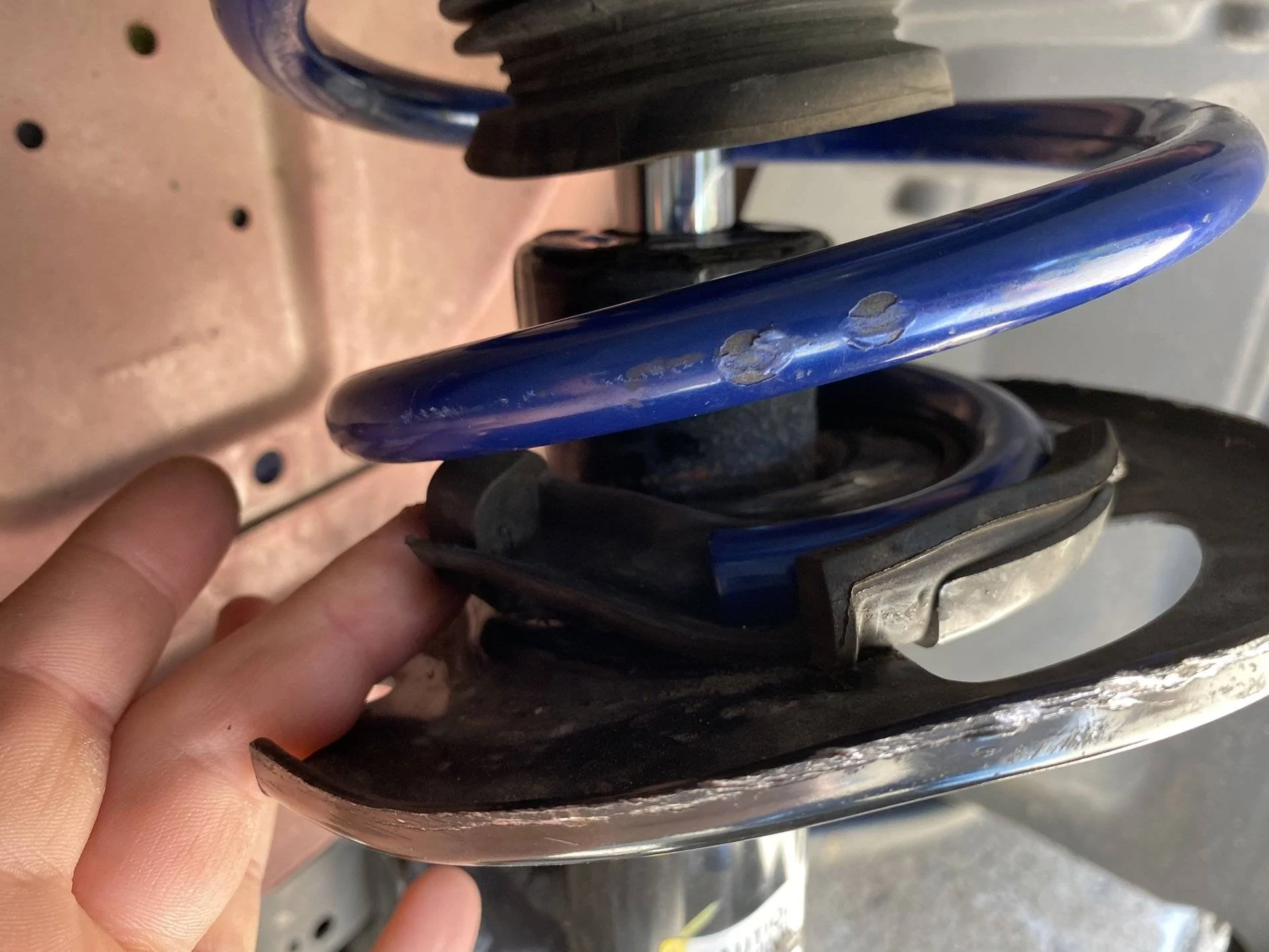

I have a clunk coming from the front left on sharp right turns. Lifted it up today to notice the spring has come off the rubber seat and is not seated correctly. The rubber has a slight tear to it so I want to replace it but cannot find the lower rubber seat! What is the "real" name for this? Or a link to where I can buy them? Ordering Koni yellows to go with it since I noticed some play in that strut anyway, but don’t think they come with it.

Spring seat.
https://www.cjponyparts.com/kyb-front-coil-spring-seat-2015-2020/p/SM5820/

Yeah i can find the top everywhere. The bottom is almost none existent. I’ll probably have to call the dealership tomorrow.

I’ve got something similar going on as well. On mine though, the the little nipples that go through the strut spring seat tore. So without it being located, it pushed itself out from under the spring. Perhaps I didn’t have it fully centered when I installed them. Good find!

On second look, it's actually pretty visible how much the isolator has slipped. It looks like it's moved a good half inch or so in the picture.

Pretty sure thats what caused mine to tear. The grommet wasn't in the hole all the way and it allowed the spring to move.

Yeah it moved about an inch. I pulled it and reset it, its sitting pretty normal just has a tear in the insulator. Ordering the new ones and new struts. Thanks for the help.
