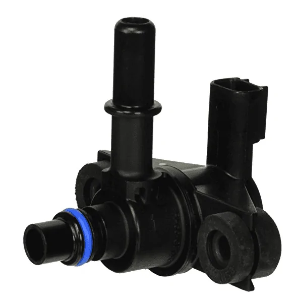

Update #2:
Brought my car to Ford and they heard the pinging noise (Thank God, For one time I was able to make them hear the issue!). It just comes and goes at idle (Or while driving). Apparently they said 1st it was a shot injector. After that, they said nevermind the injectors are fine and no code were even thrown in the ECU. Then, they came to the same conclusion as I thought last night... It's the EVAP (Vapor Canister Purge Valve / Solenoid) ! My question is could it really be it? Would that cause my bad MPG? I don't really have a rough idle or anything... They wanted to charge me $175 for the job and part. (I have $100 deductible before my warranty goes out). I looked it up online while he was checking around on his system and I found the part for less than 20 bucks :lol: (They wanted to charge me $50 + tax for this sh*t! :headbonk:). Anyways, for what it's worth... I'm probably gonna order it today. I just wanted to check with you guys if you think it could really be the problem? (I just fixed my exhaust leak this morning with 2 new clamps)
PS: After reading a few forums it does seems that it would affect the MPG. I just went ahead and ordered the part. I attached a screenshot of the part I'm talking about.
Thanks again! :cheers:

Update #3:
I just caught it on video! I stopped at my wife's parking garage at her work and I had 171miles to empty. I disconnected that that stupid EVAP and after a few minutes my mpg went up. 198mile to empty! No more lose of power. I hope it'll hold like that. I will check on my way to the house tonight. However, one thing worries me... My check engine light didn't come on! W*F ??? Anyone has an idea why?

The light will come on,usually takes a couple key or drive cycles but it will come on.
Came on last night while driving :D I've never been so relieved to see a check engine light lol. I thought my ECU had a problem or something. Usually when the car is running and you disconnect something like that stupid EVAP it should've popped the CEL. :shrug:

5/8 spark plug socket. You'll want an actual spark plug socket as it has a rubber insert inside to hold the plug while you remove/install. And you'll need an 8mm I believe for the coil-on-plug bolts. The back left plug near the battery is the hardest one. I use two small extensions to get in there but it's a pain.
Evap probably didn't throw a code at first because I believe it is only activated on startup. It lets the gas fumes that build up in the vapor canister after you turned the engine off last to be drawn into the engine.
