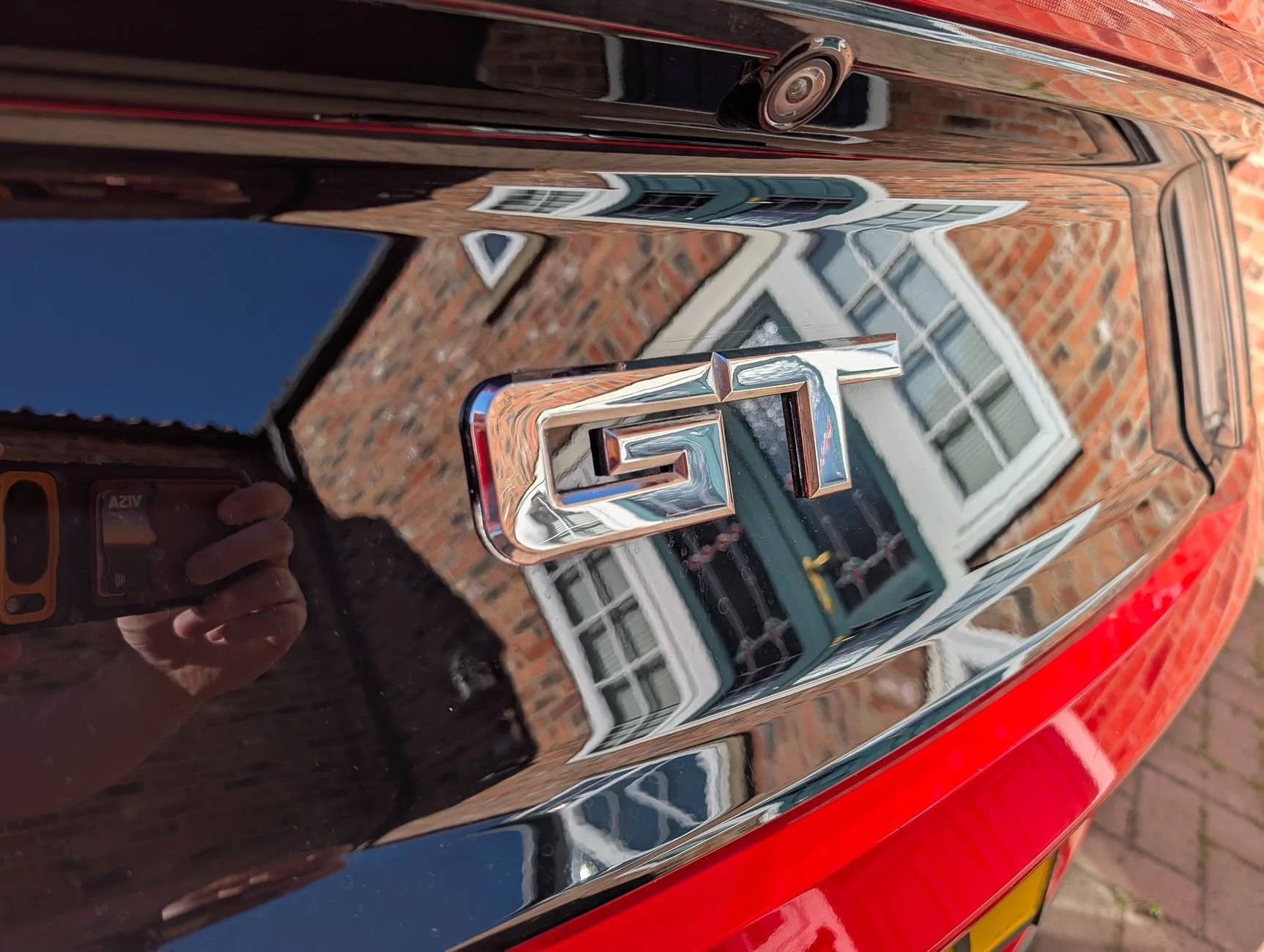

I can happily send a pic of the finished job. I dont think I have any pics of the lugs but I will look. Will send after breakfast :)
Word of caution... I ended up getting the GT lettering from ebay. TBH the quality is good and its cast metal and not plastic.... but it wasnt curved like the decklid is. I had to use heat and pressure and patience to curve it by hand to the shape of the decklid (before sticking it on) I did look at the ones from Nemesis UK but they had the prongs on them and I didnt want to try and cut off. So far so good and the one I have installed is staiyng put (even after a jet wash) but it was a bit of a pain.

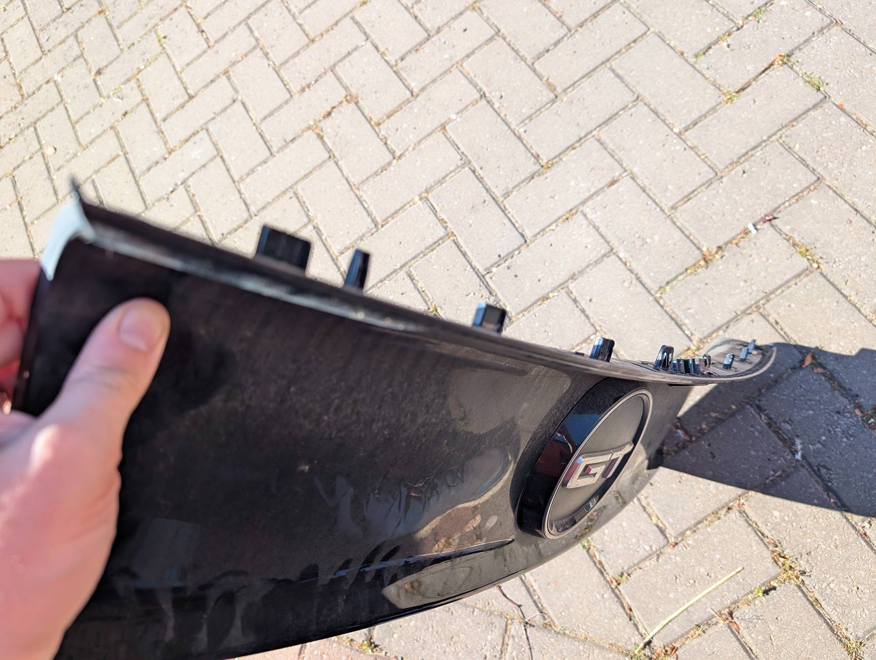

Here's the new panel fitted. And also the old panel showing the clips at the top. I remember the new panel was identical in terms of clip quantity and location. Mine is a pre facelift.
Looks really smart. So they are 8. I think mine are going to be 6 (face-lift) so that may be a bit of a bugger ha ha. The face-lift also has a raised line (speed line I think they laughingly call it) which I have only ever seen with 8 clips so that is another conundrum ha ha.
Thanks :)
Yeah I'm kinda happy with it except the scratches you can see just above the GT where I was cleaning with a micro fiber cloth. That's how sensitive these panels are.

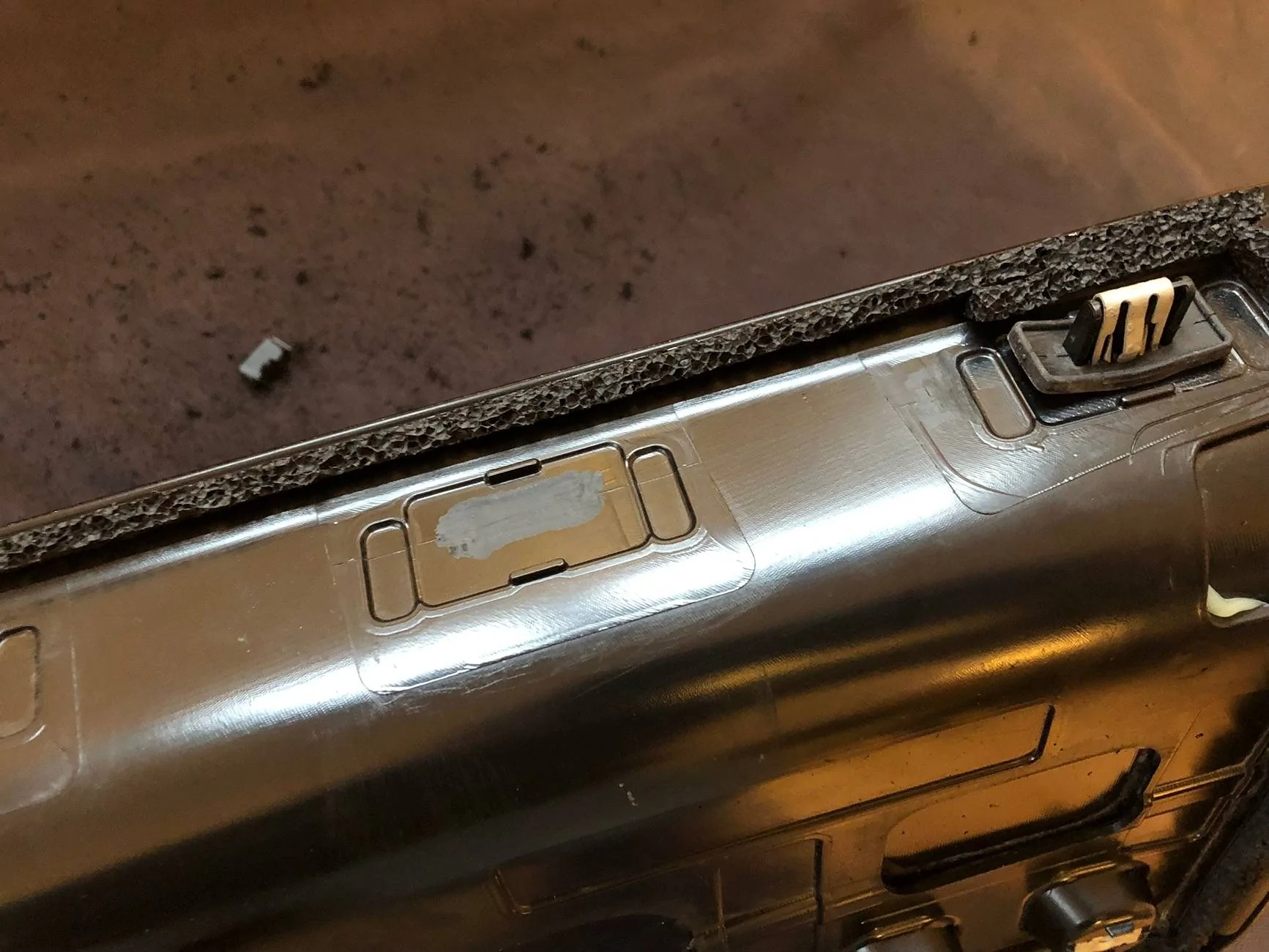

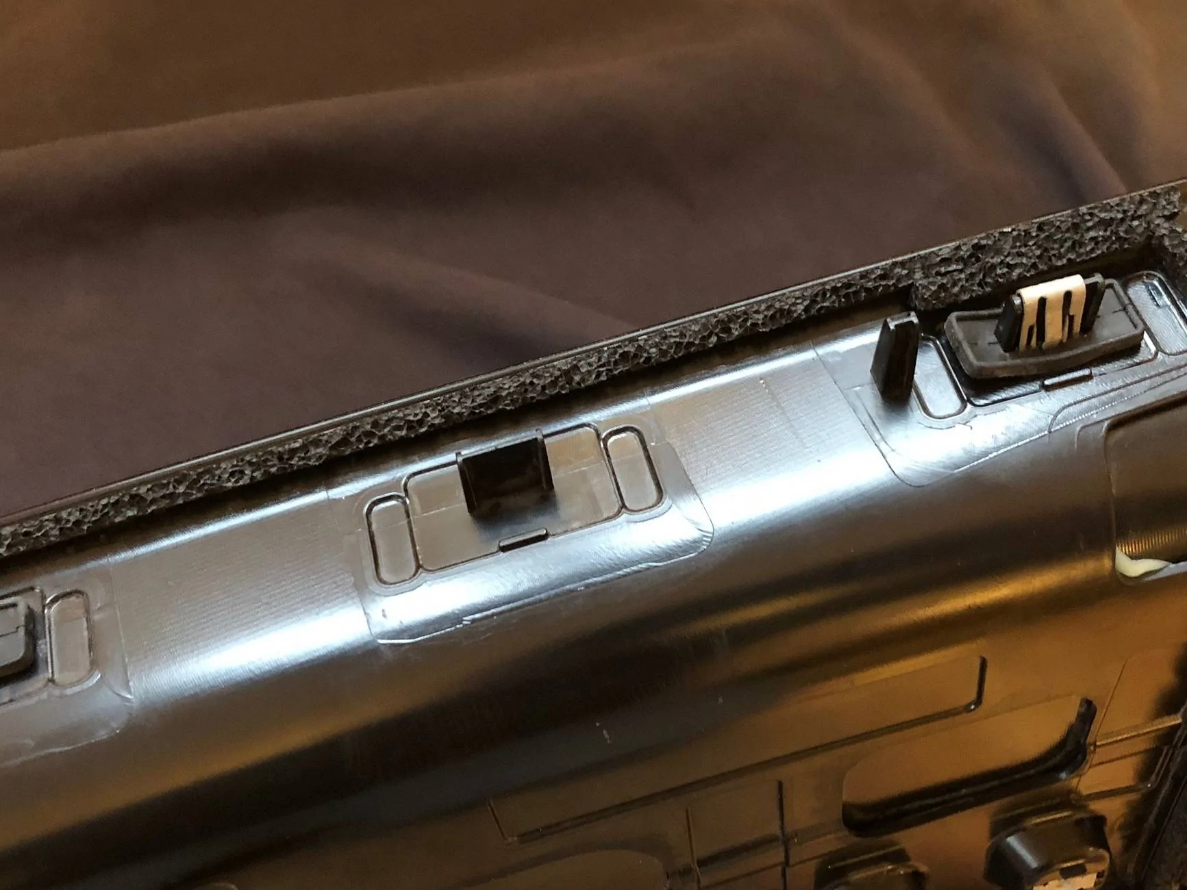

That’s exactly what I did (I have some photos somewhere).

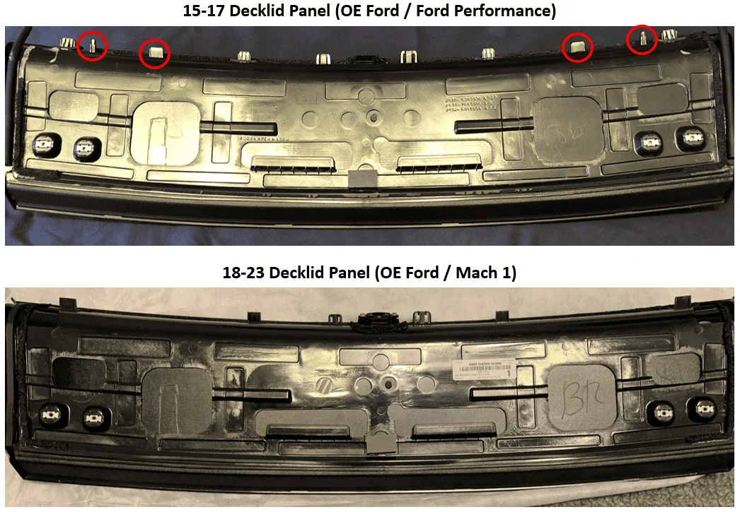

I know the 15-17 decklid panels have some extra locating tabs when compared to the 18-23 decklid panels :
But do I need to cut them off, or will my 2020 trunk lid accept an earlier (unmodified) panel ?
I don’t want to cut them off if I don’t need to, but if I do need to cut them off, I would rather do it before the panel goes to the body shop and before I get part way through the swap, and then realise that I need to get the Dremel out … lol
