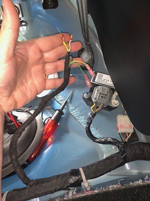

2018 gt, So did my hellion low mount install and fore return fuel system. Got my start up tune from lund and car wants to start and on a few tries it has ran for like 5 seconds or so, enough time for me to verify that i have fuel pressure at the rail, right around 50 psi. when the car is starting its dumping insane amount of raw fuel. Codes I'm getting are P0627 fuel pump "A" control circuit/open, P061B internal control module torque calculation performance, and P162F unknown OEM DTC, most of the time its the p0627 and the unknown one. I have reloaded stock tune and tried that just to see how it acts and car seems to react the same way and i get the same codes, reloaded lund tune, same thing again and again, i have checked all vacuum lines and the only thing i have changed with that is per. hellion instructions. I think the tune might be corrupt or something. I hope its something easy i have over looked but can't seem to find anything. Only thing that seems different from others i have seen is the fuel pump wires, The stock hat has 4 wires going to it, two smaller gauge wires are for the fuel level sensor, and the other two are for the pump, one ground and one power. So i cut that plug off and used the two smaller ones for the level sensor and the yellow wire with grey stripe triggers my fore controller. Seem like all the info i can find online people are teeing in the wire right off the fuel module controller, i think thats what its called, right next to the hat, kind of looks like a low voltage transformer. Check out the pics, but i have sent a log to lund but its the weekend so i won't hear anything till tomorrow, just hope its something I'm over looking. Any help is appreciated.
