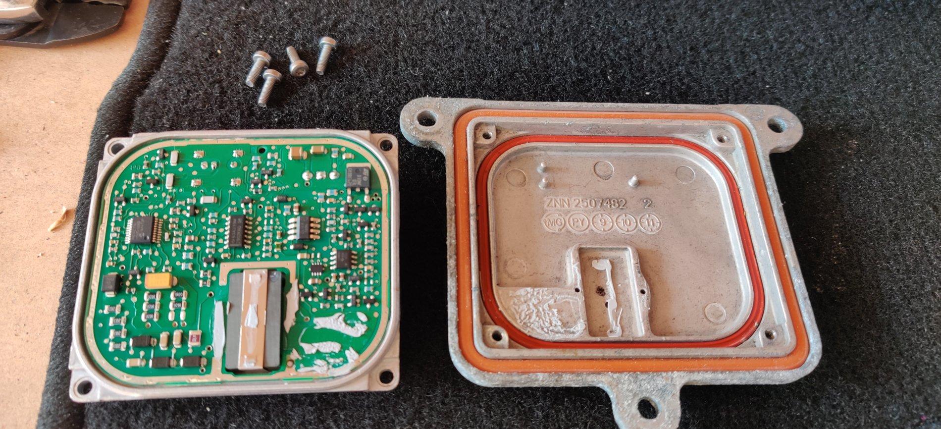

I've upgraded to stock 35w which makes a big difference,
If you do a search on eBay for osram ballast and bulbs you just swap the circuit boards over into the mustang ballast, I've not got 6000k but a jaguar 35w 4300k set up when the bulbs blow I'll replace with 6000k but 6000k is actually dimmer than 4300k it's just a colour change
Similar to this... https://rover.ebay.com/rover/0/0/0?mpre=https://www.ebay.co.uk/ulk/itm/323768558336
You have to make sure you have the cables with the bulbs as the cables are different. You can do this on the car but it's really difficult to get access to the ballast.
Note the mustang has a 4 bolt base plate not the 3 bolt plate but the inner circuit board is the same just higher output

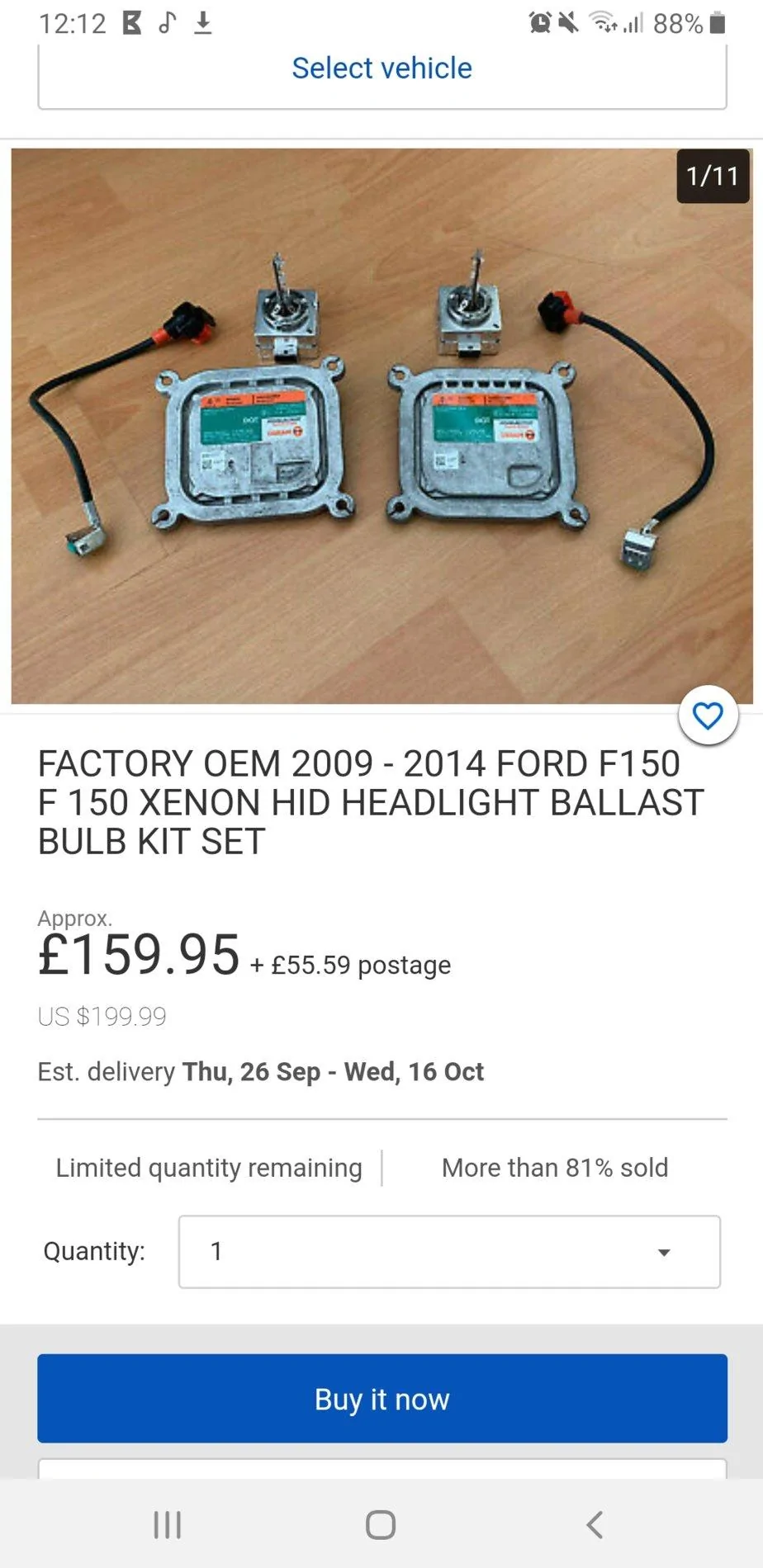

I have been thinking about replacing mine with these but not sure if the loom is capable of supplying the power
You would want to clean off and replace the heat sink compound or you risk premature failure
