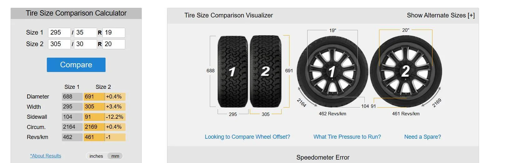

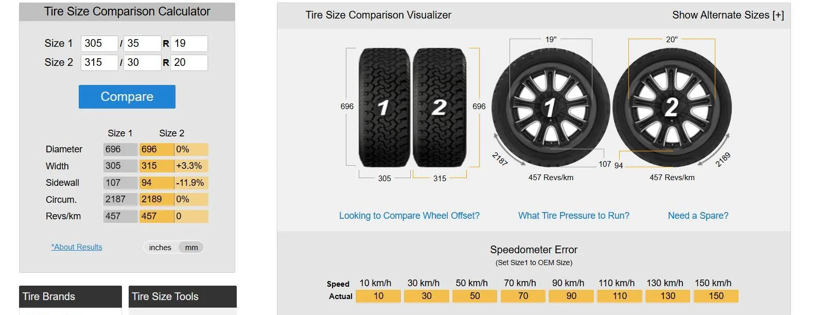

This might help.
Tire comparison sizes are very close to 295/35/19 front and 305/35/19 rear.
Front would be the only concern, as its so close to the 295/35 size I doubt you would have any issues.
