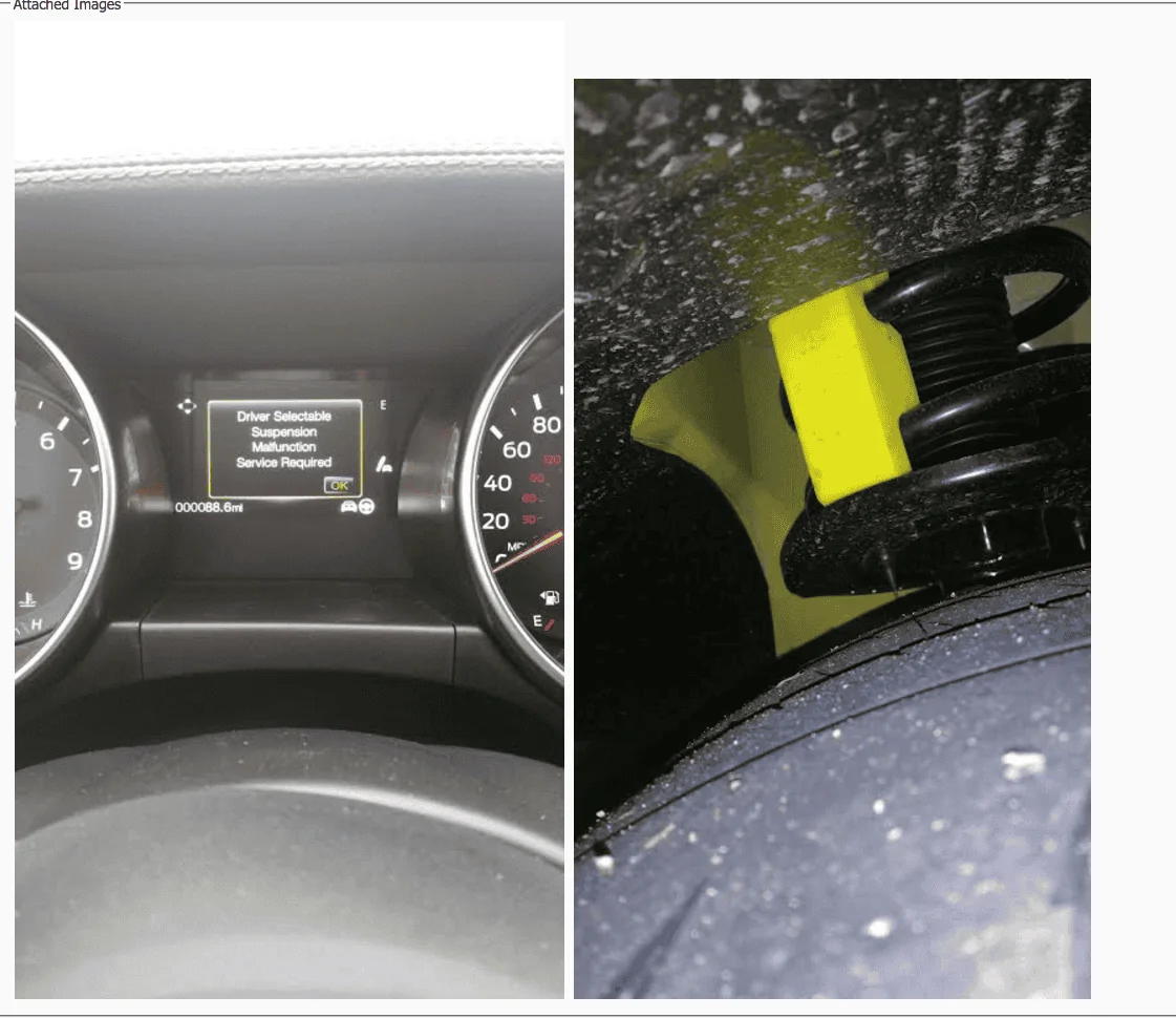

If this is the error you are getting the little yellow "thing" in the suspension is causing it. You might want to let the dealer take them out re. warranty etc. but it's quite easy to remove them yourself. In some cases they have just fallen out on their own.

That's it. I knew this was the correct place.
