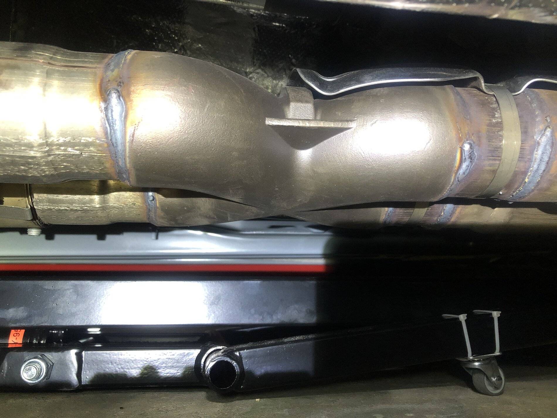

I had a brain fart the other day and for some reason thinking I had an H pipe on my car I ordered a LTH X pipe. Low and behold when I get underneath I find that theres an X on it... ( I guess my bullitt had the H..) anyways looking at the one currently installed Im not in love with it, seems like it would be restrictive as both pipes intersect. The LTH in more of a "merge" where both pipes are along side of one another vs totally crossing paths.
Anybody have any input on if theres a benefit to swapping out to the LTH? And any difference in sound.... Cheers
this is what's on the car now

I know the difference between x and h pipes.
Im talking about 2 different kind of X pipe designs... one type (the more common apparently) is where the two pipes run parallel and merge into one another. The other is an actual X where the exhaust literally has to intersect.
Ive been searching around and I can't find anyone that sells an x pipe that looks like the one currently installed on my car. In fact the closest I could find is what appears to be the x thats factory installed on the "R"... Maybe the one on my car came from an R?

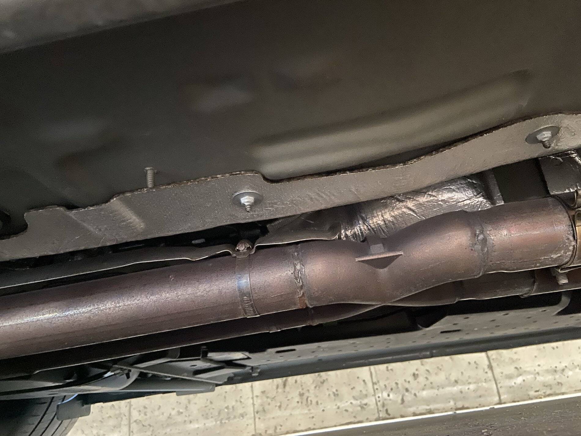

I have a 2020 R. Let me see if I can get under it and get a pic.

Here’s mine. I hope it helps!

Much appreciated! That looks exactly like mine.... no wonder it sounds so good lol. Looks like I’m going to return the LTH.
She sounds good! Glad to help and enjoy!

A previous owner has already deleted your resonators and welded in straight pipes, like the R. The R pipes are 2.75", I'm not sure what size yours are but they look fairly similar, might be 2.5". Definitely don't go changing that, I think you have a good setup. You can see they have also re-attached the heatshield with worm drive clamps. The original securing of the heatshield is with metal ties.

Ahhhh I get it now.. the 350 came with an x pipe from the factory with 2 resonators. The resonator on my bullitt was a big rectangular muffler looking thing with 2 in and 2 out. I just assumed the 350 would have had the same thing stock.
So considering the stock resonators were simply removed and straight piped the only thing I should check is if it’s been done with 2.5 or 2.75 tubing. If it’s the smaller pipe I might still be inclined to swap out to the LTH... I could probably benefit from a little more flow with the whipple pounding air in the other end.

I don't think the 2.5 vs 2.75 for that short amount of piping will have any negative effect power wise. I mean the internal diameter of the factory resonators are 2.25", you have an upgrade over that. The factory resonators are also smaller than 2.5" ID. I'd just leave it personally unless you are not happy with the sound.
In talking about sound, you will notice a difference in sound between 2.5 and 2.75 pipe though.

I measured the pipes and they are 2.5”... this leaves me torn on whether to swap out to the lth or not. The car sounds incredible the way it is and I’m definitely not lacking in power (789whp).... but still if there’s anything to support any improvement (marginal as it may be) with the lth it’s just not in me to leave it alone.
