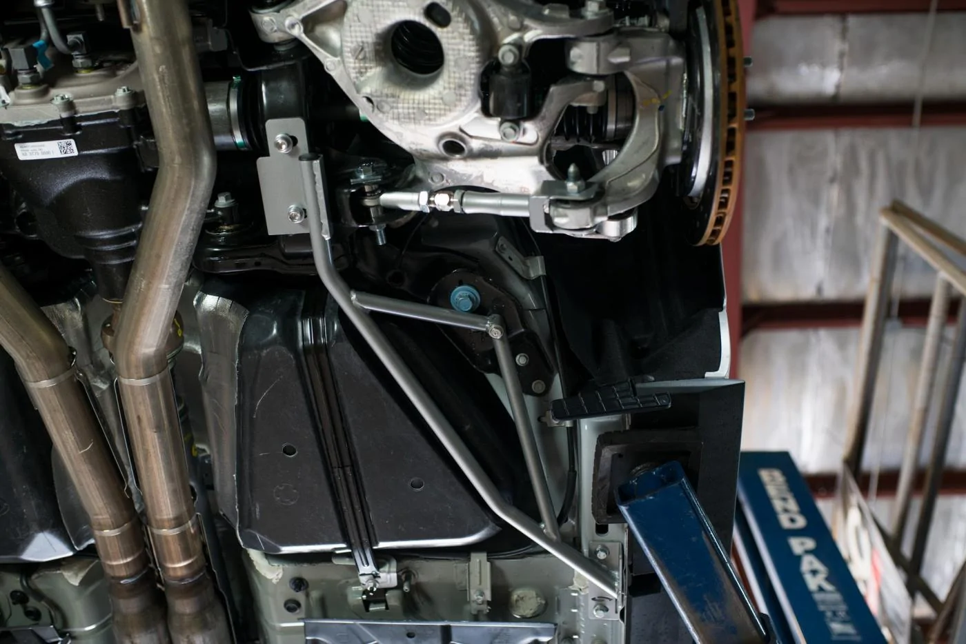

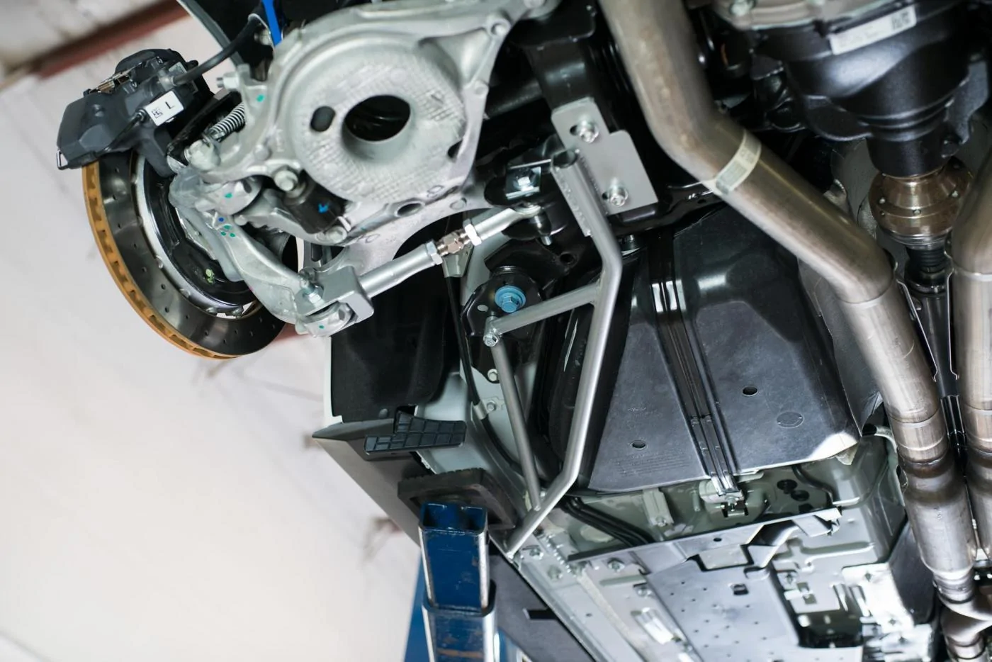

I installed the Steeda parts to make the rear much more planted. Never really had wheel-hop, but wanted a more solid feel.
You will be surprised at all the rubber/mounted in rubber in the rear IRS. Using the lock-out bushings for the subframe and diff, etc. didn't change the NVH characteristics at all. Wasn't the easiest install, but not too difficult. Some videos FYI:
Note: Unless Steeda has updated their kit, the rear lower aluminum "collar" won't fit the GT350. The rubber bushing has a different shape and the collar is simply too small to fit over the bushing.
