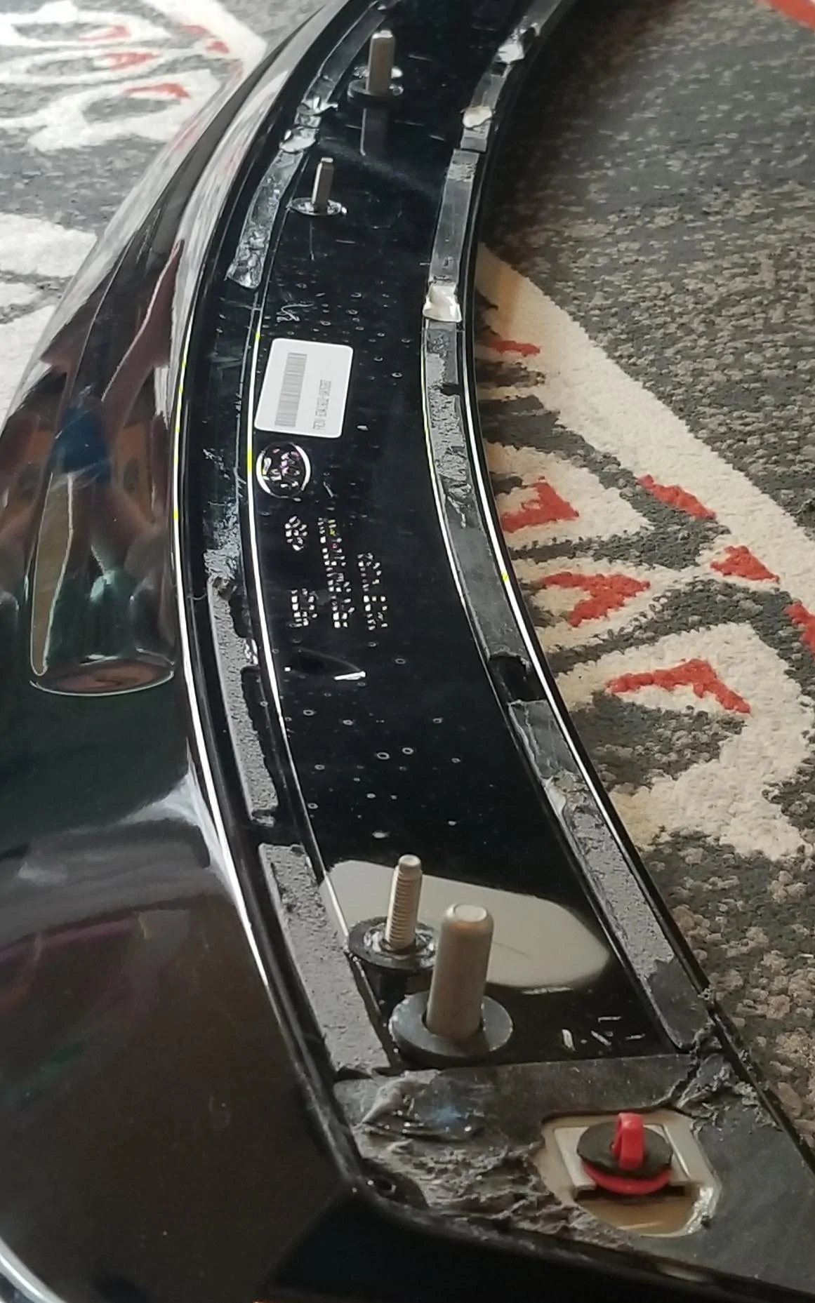

So this is what the mounts look like for it has anyone seen anything like it? Is this what the bottom of the spoilers look like on the non gt350 mustangs? I'm gonna cut the big locator things off and just have the studs. I really need an installation guide though. I've also considered selling this and just buying an aftermarket one since this is an oem gt350 one. Any thoughts anyone?

Your car doesn’t have a factory spoiler if it’s a 15-17 Performance Pack GT. They have a smooth clean trunk lid (spoiler delete). So you’ll be drilling holes to mount this even if you only want to use the threaded studs to put nuts on the inside of the trunk. You can drill extra holes for the locating dowels if you want or just cut them off and don’t worry about them.
Many guys are getting the track pack spoilers and mounting them with no drilling at all. Remove all dowels/studs/clips, clean trunk lid and spoiler with alcohol, apply adhesion promoter, cover most if not all of the flat surface on the bottom of the spoiler, line it up and stick it on the car. Set some bags of rice or sand on it for a few hours and you’re done. The spoiler ends up attached so securely it’s quite difficult to remove from the trunk later on if you try to (but it can still be done, and you won’t have holes in the trunk lid). This is the route I think I’ll end up going.

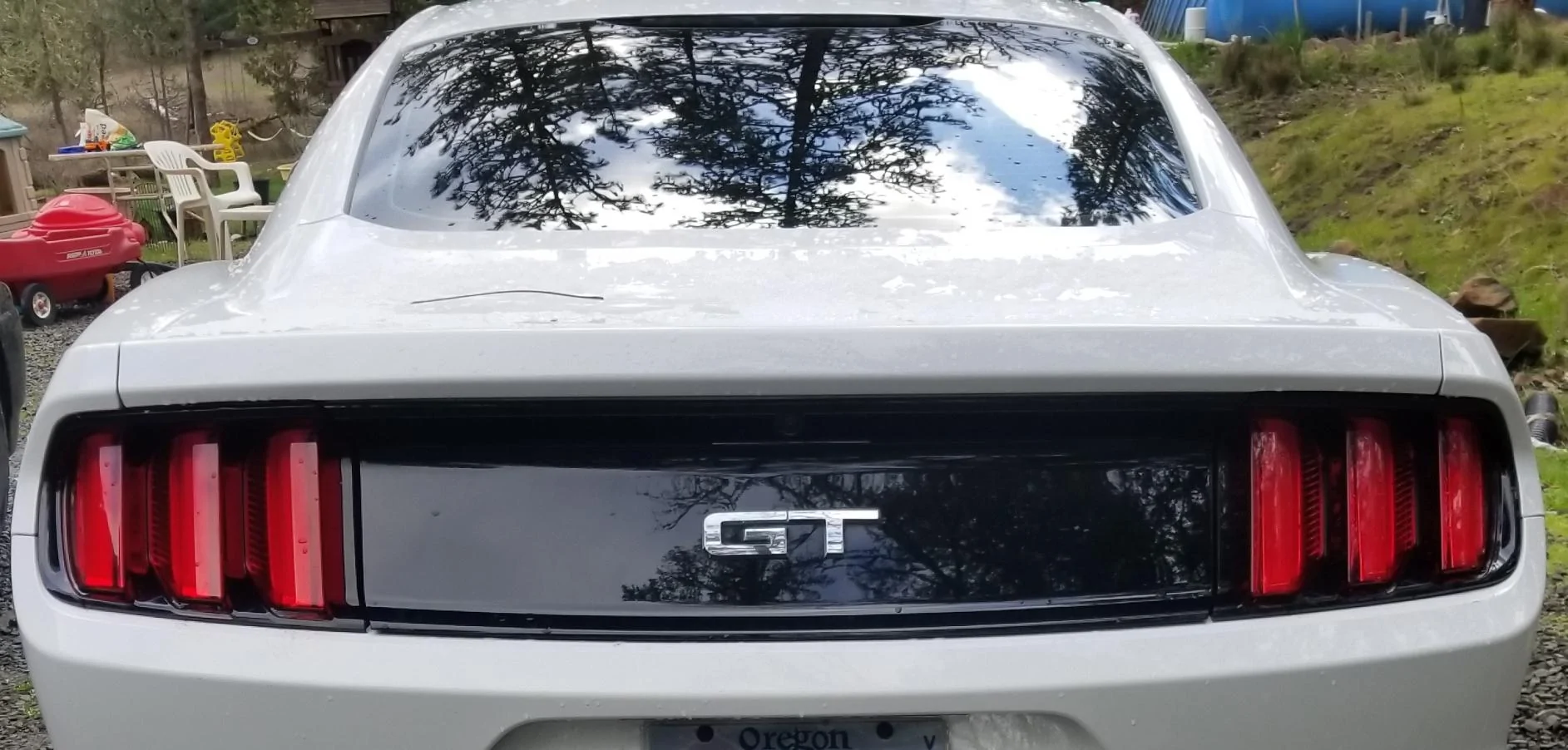

Yea my car has no holes that's my dilemma. Do they come off easy with glueing them on? I don't mind drilling I just wanna make sure I don't drill in the wrong spot. I also wouldn't be opposed to glueing will it pull the paint off when I try to remove it?
