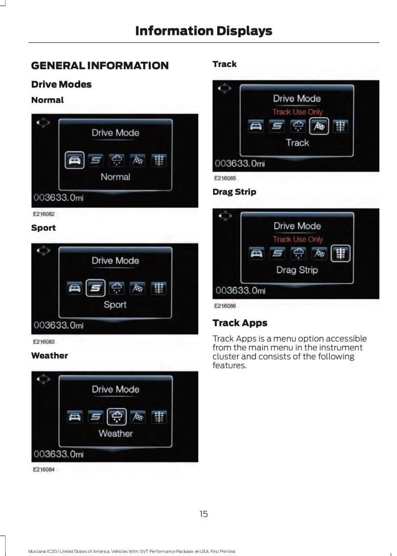

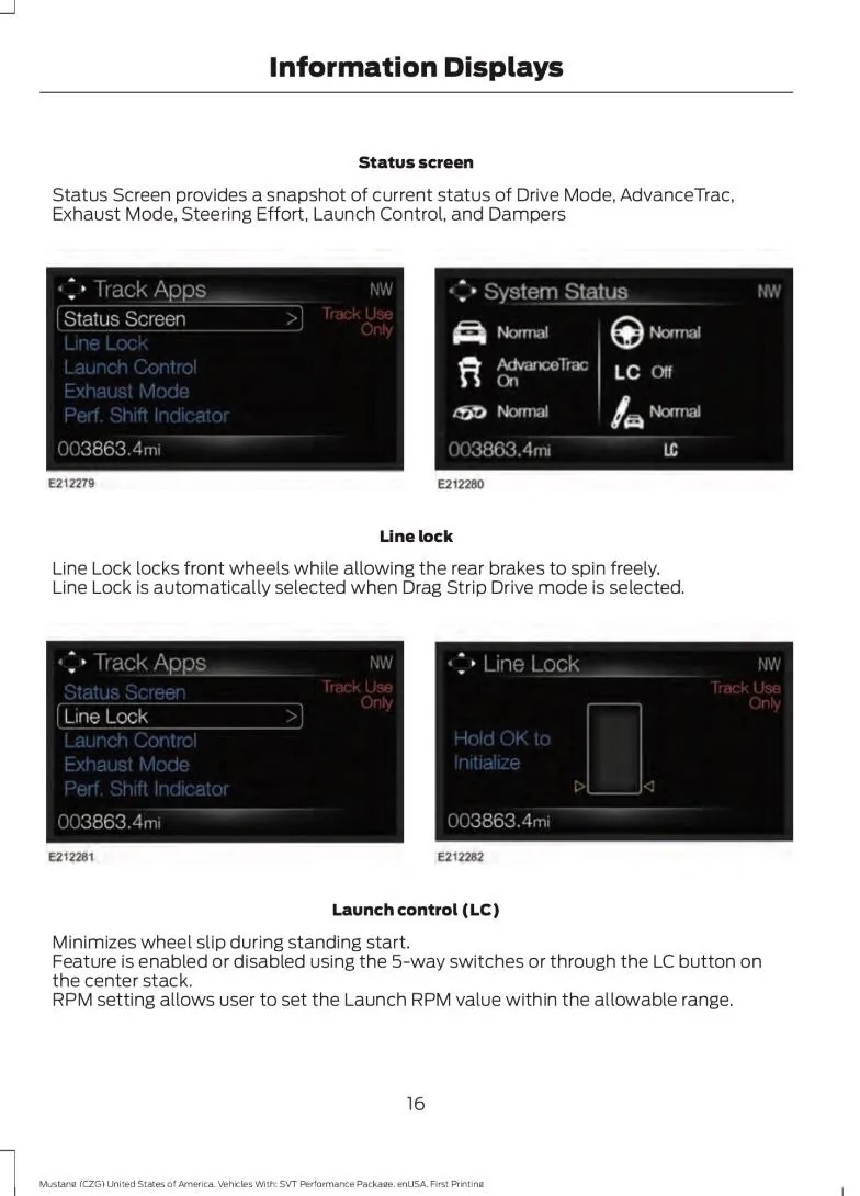

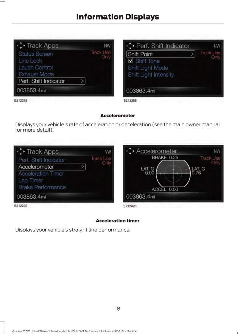

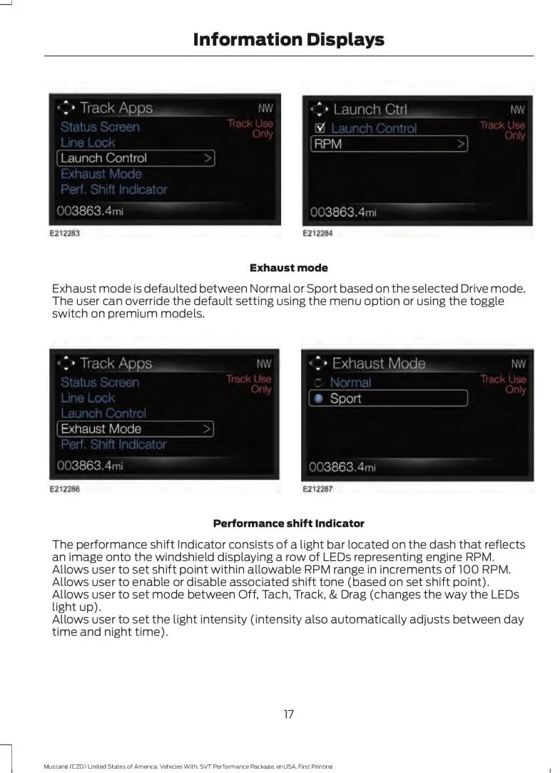

From the Photos, you can see they can be Controlled and Slected by the Arrow Switches, so you shouldn’t need the Mode Switches on the Wheel.
