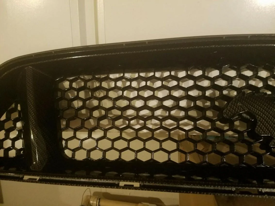

Looks way better and breaths just fine ..you can even Hollow out all the holes like I did

Yes I did it and I definitely didn't have to use a Dremel or routing tool..i used a small belt sander from the back..and the honycomb just fell out ..without any chance of damage
