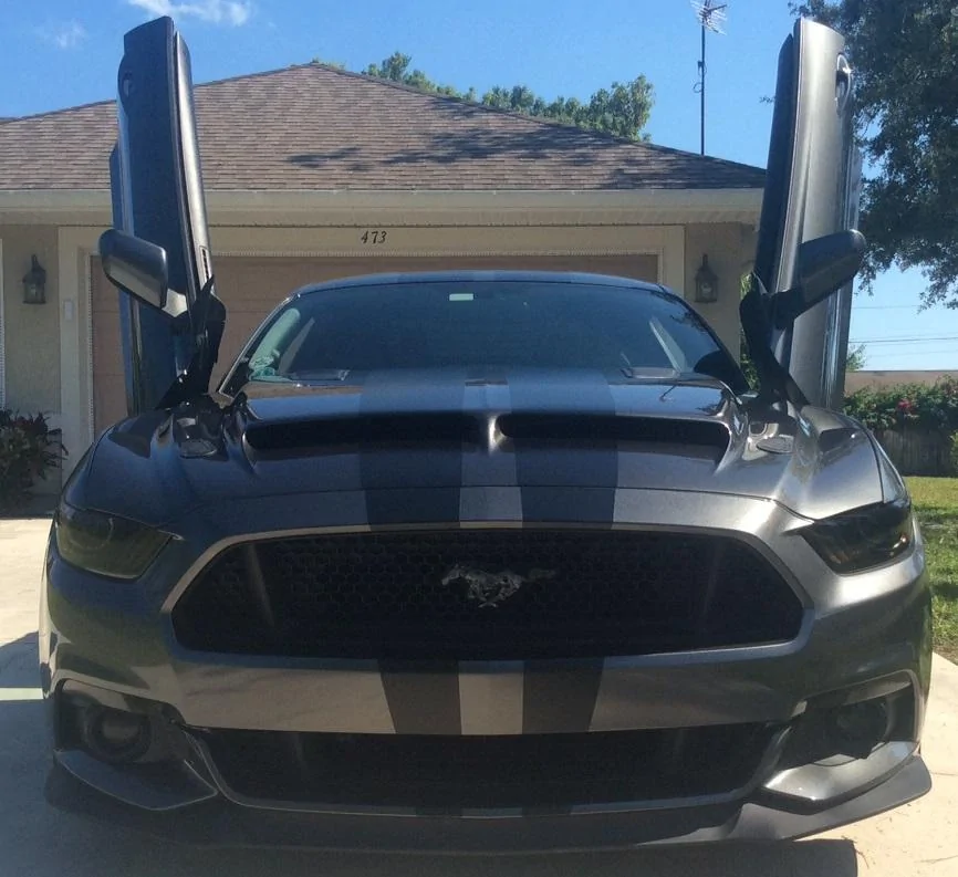

Here is a pic of the 2015 EcoBoost I had with GT grills installed.

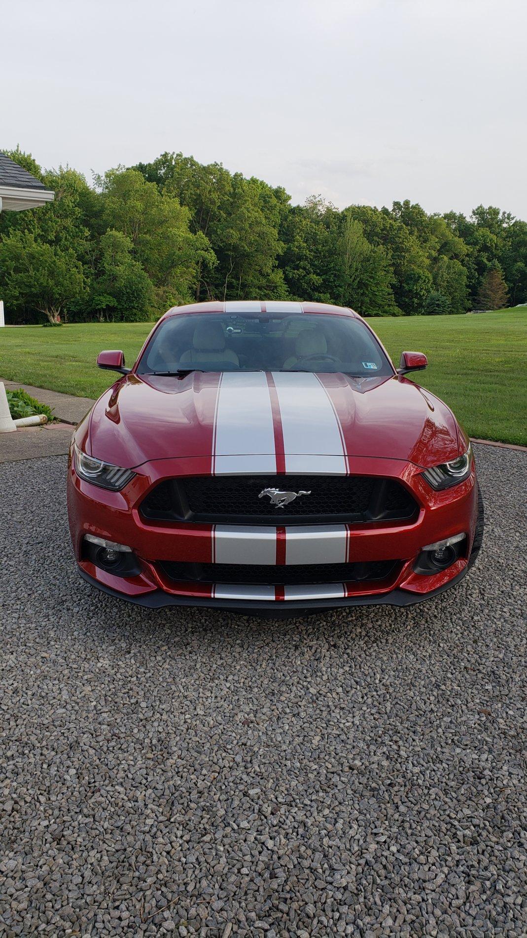

My ecoboost just got the grille on today. They didn’t say anything about fitment issues. So a okay
