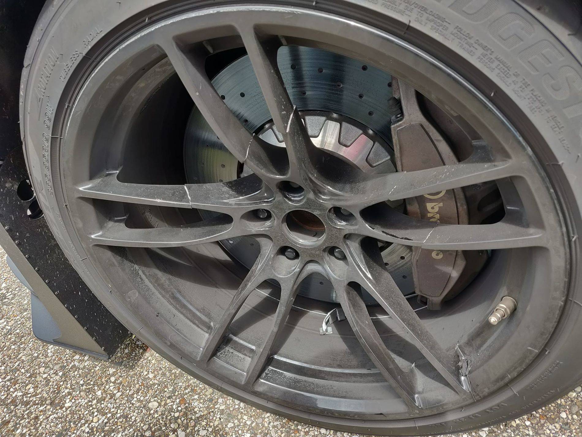

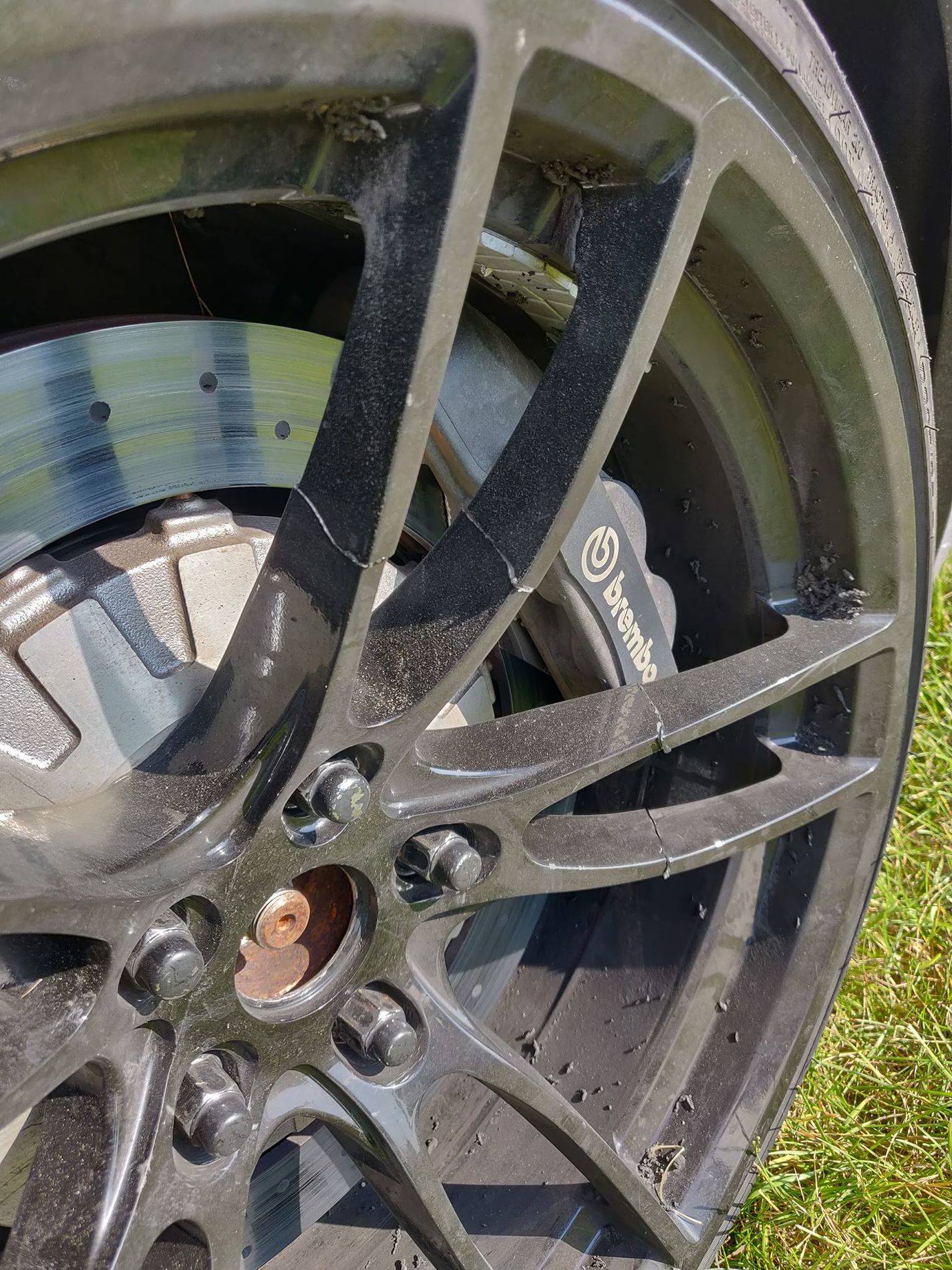

p51's look fantastic, but i've seen a few posts about them cracking online and have a friend that had a set crack as well... track use, and he is FAST, but no thanks.
cat=111&_nc_ohc=yF63Y1vz7jMAQkW9TAF_htABhGMR_jqS7Jh3ii737hClgJuiqqfzSs-5A&_nc_ht=scontent-ort2-1.jpg
That is MOTHER FRICKEN scary...
EDIT: And what's crazy, it was the REAR wheel that cracked?! Yikes.

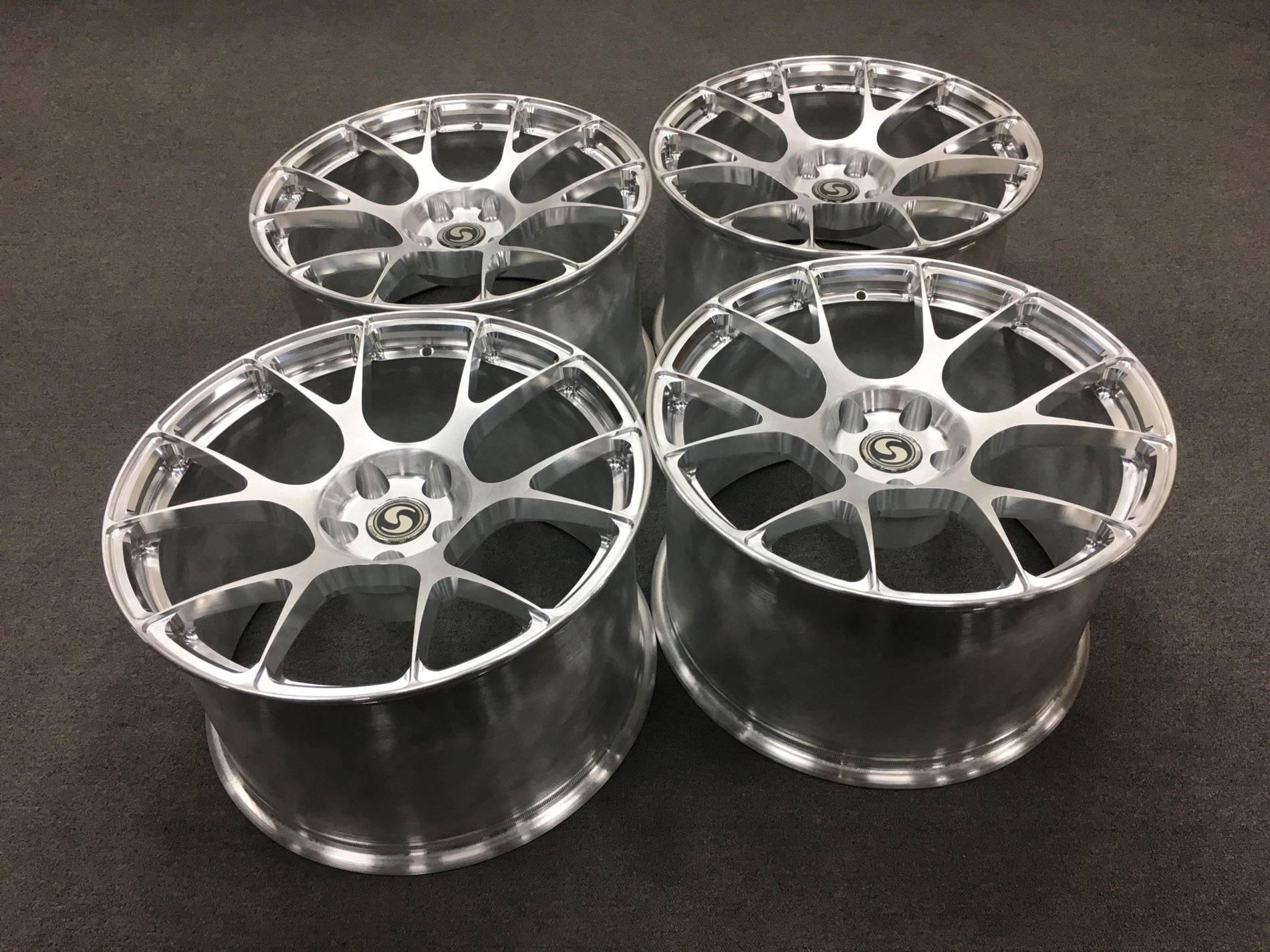

For anyone interested I have these freshly built and ready to ship. You choose the finish as therse are raw aluminum fresh from the CNC machine. Direct bolt on with no spacers or rubbing.
Track Series SV503
19x11.5 square
Anti slip bead knurling
Deep drop cup
approximately 22/23 lbs

Are the offsets on all 4 are the same?
