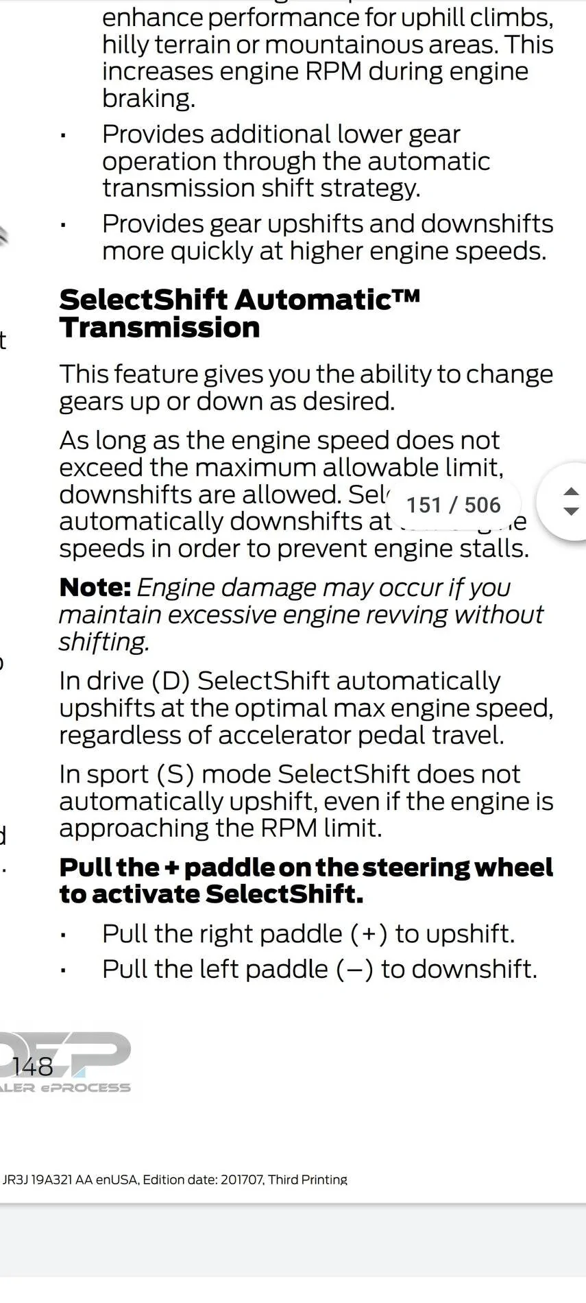

If you are on D if you hit the paddle you keep accelerating and it will automatically start shifting on its on but if you are of S and you hit the paddles then it will be manual but eventually it will shift but at a very high rpm
In S mine doesn't upshift even at redline.
From the owners manual.
