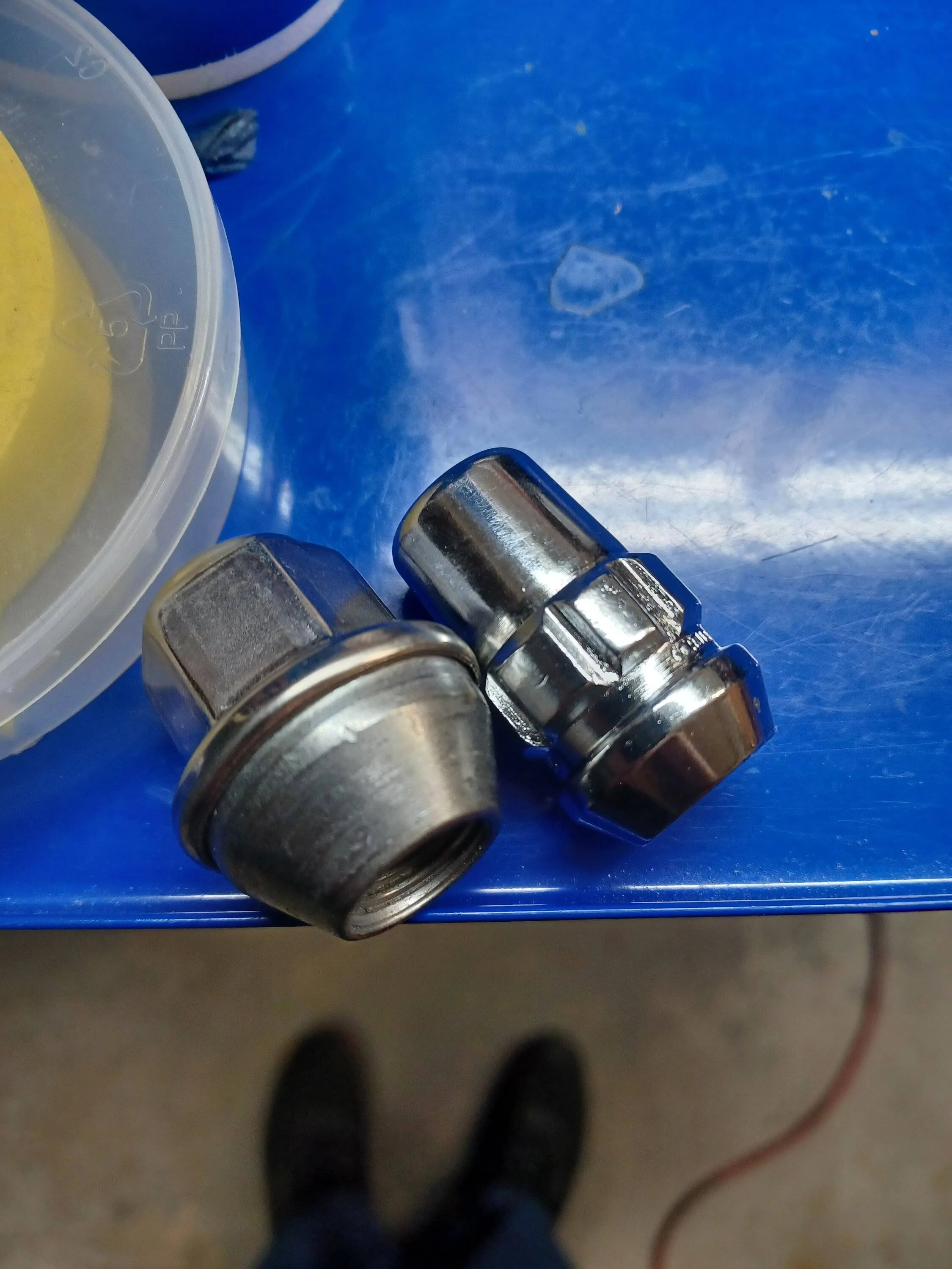

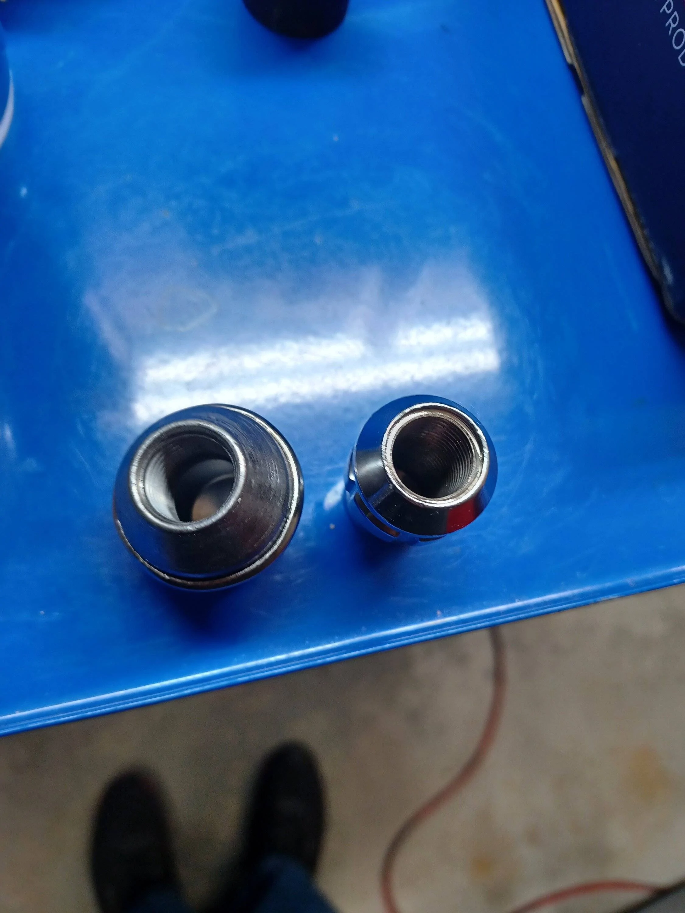

I went to install the locks and based on the seating area compared to the factory lug nut and find it unacceptable. For steel wheels, sure, but on the factory aluminum wheels, no way.
Are the Ford locks a copy of the seating area of the stock lug nut?
Maybe one would be fine but I see bad things if all the locks in the set are used. The other suck is that an extra key was already ordered.

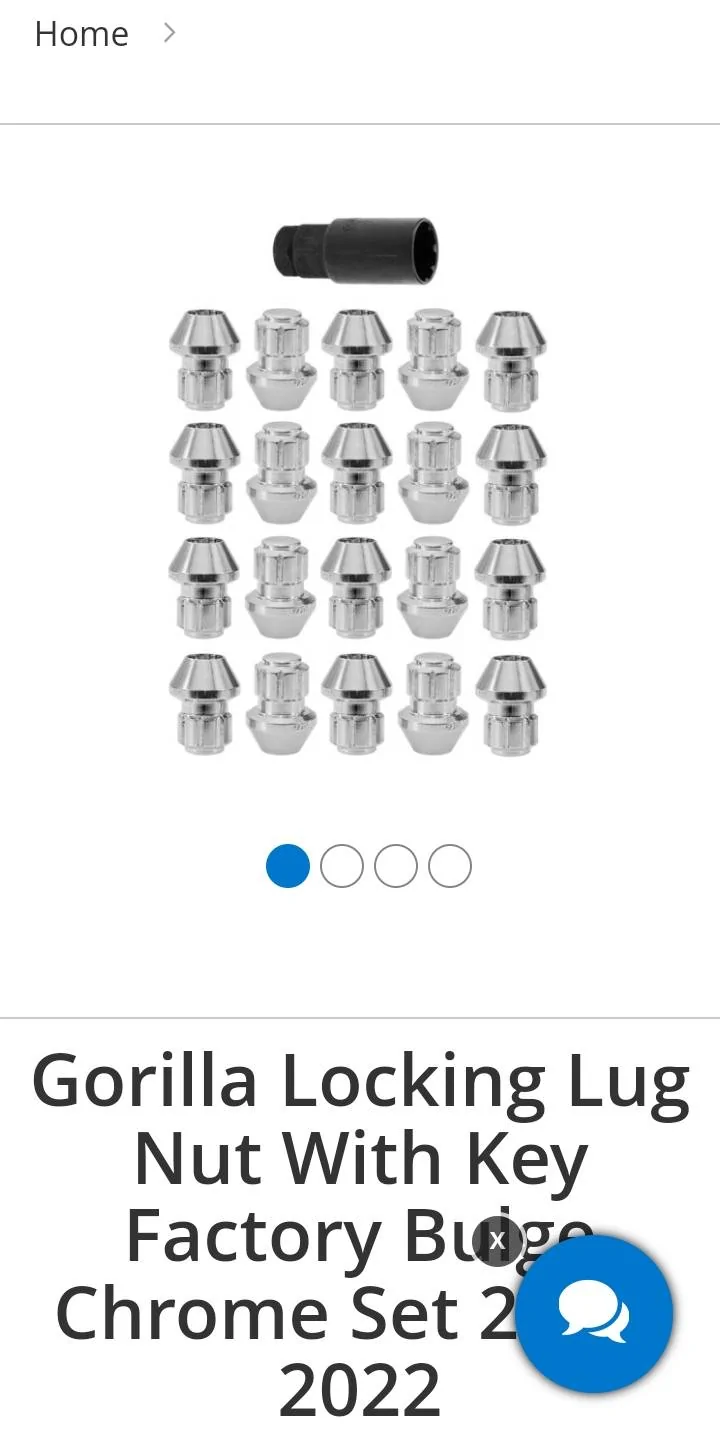

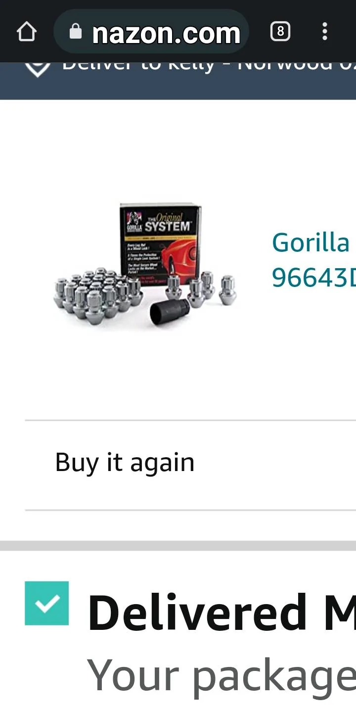

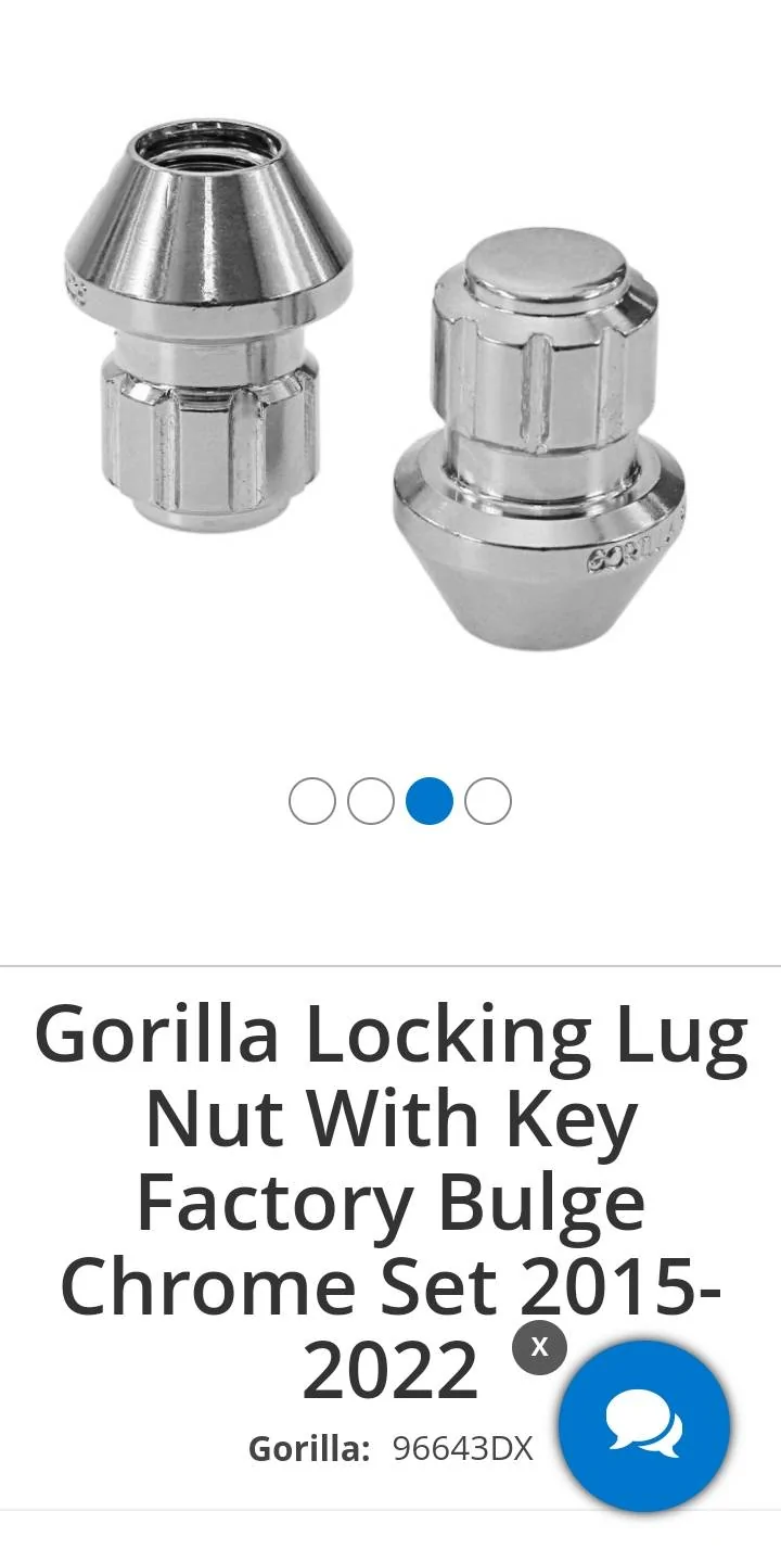

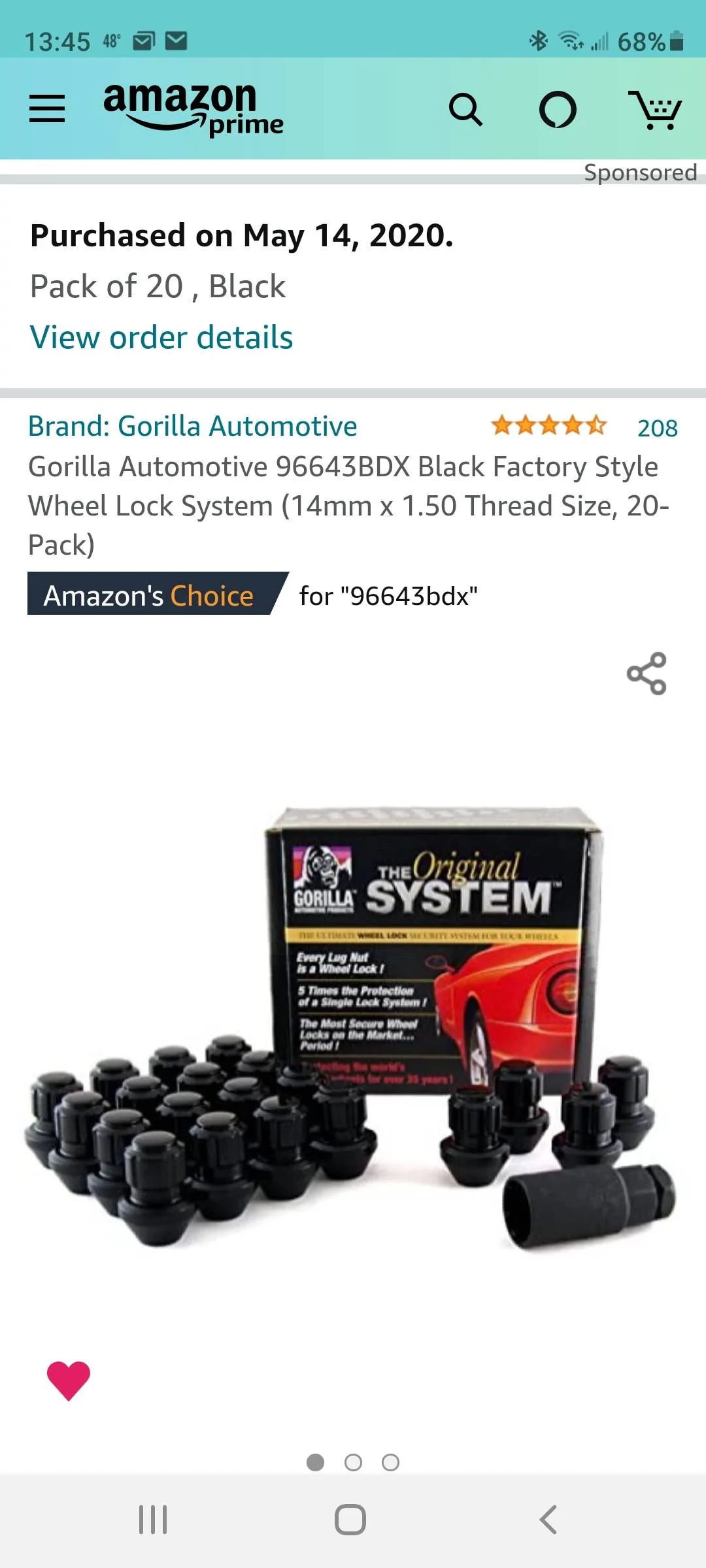

Those are the ones. Thanks, I never thought of amazon.

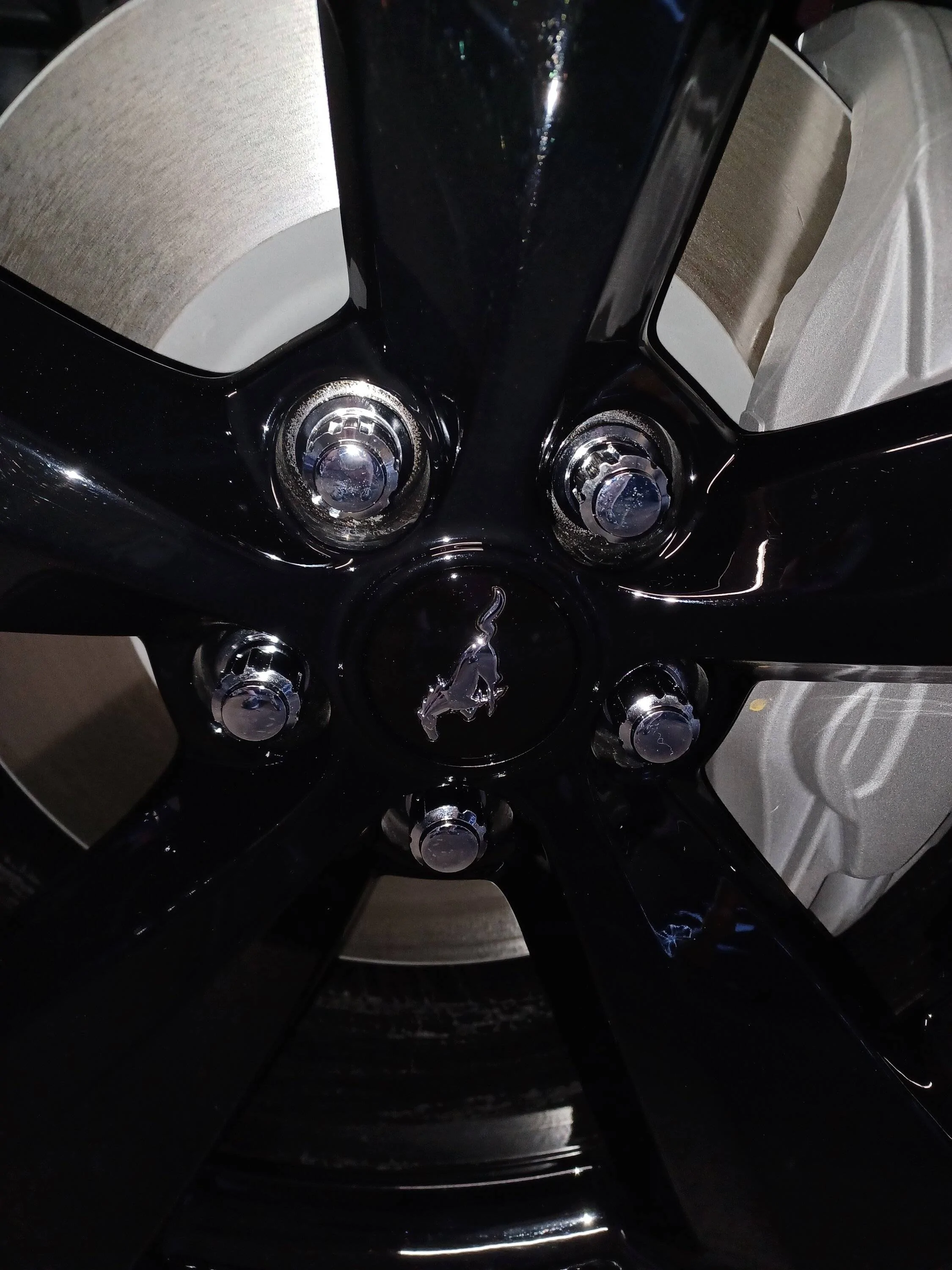

I am replacing one lug at a time in the star pattern to #150. New lugs will be here Friday.

Put them on today after Cars and Coffee at Grieco Ford in Raynham. I had forgotten how nice new cars are to wrench on.
