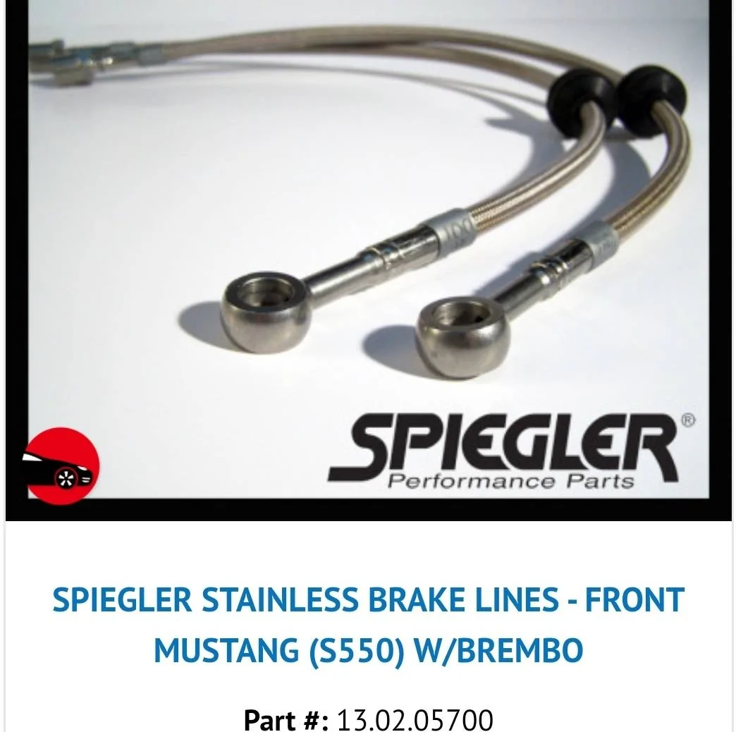

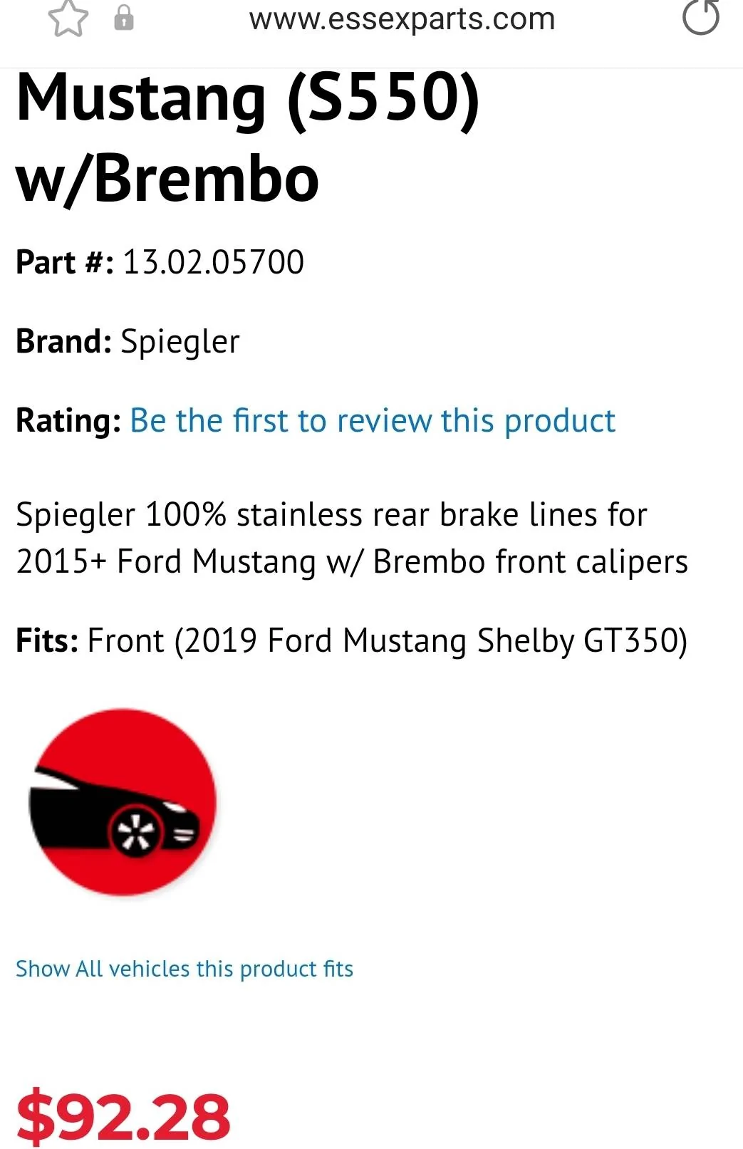

Hey Jim, here is perhaps another option for you to consider. Spiegler from Essex Parts. IIRC there was issue w/fitment of earlier design from Goodridge and a change was made. This was few yrs. ago when looking for S.S. lines for my '16 GT350. I now do have frt/rear Spiegler lines for my 2020 GT350 but not yet installed. I was told by trusted source these Spiegler do indeed fit.

Now whether or not braided S.S. lines are actually 'needed' or will yield dramatic improvement to brake feel is certainly questionable; I get that. A prudent upgrade though perhaps?
