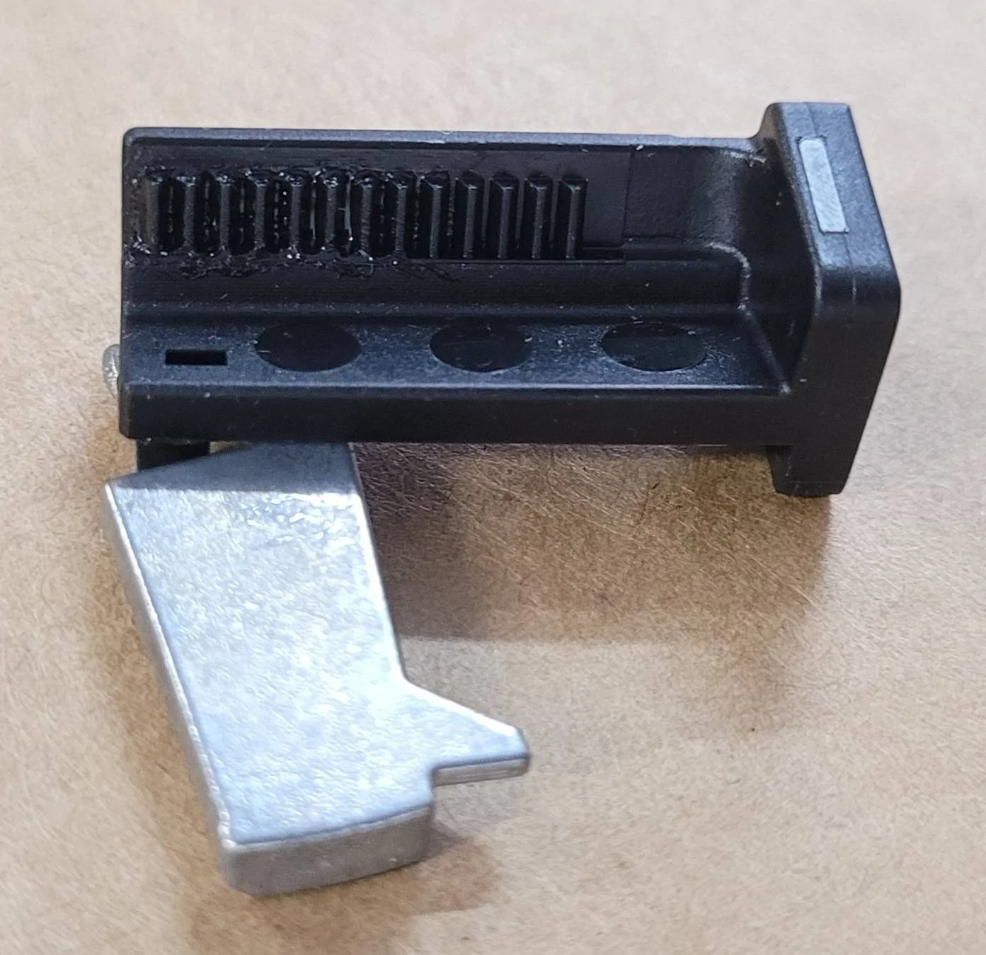

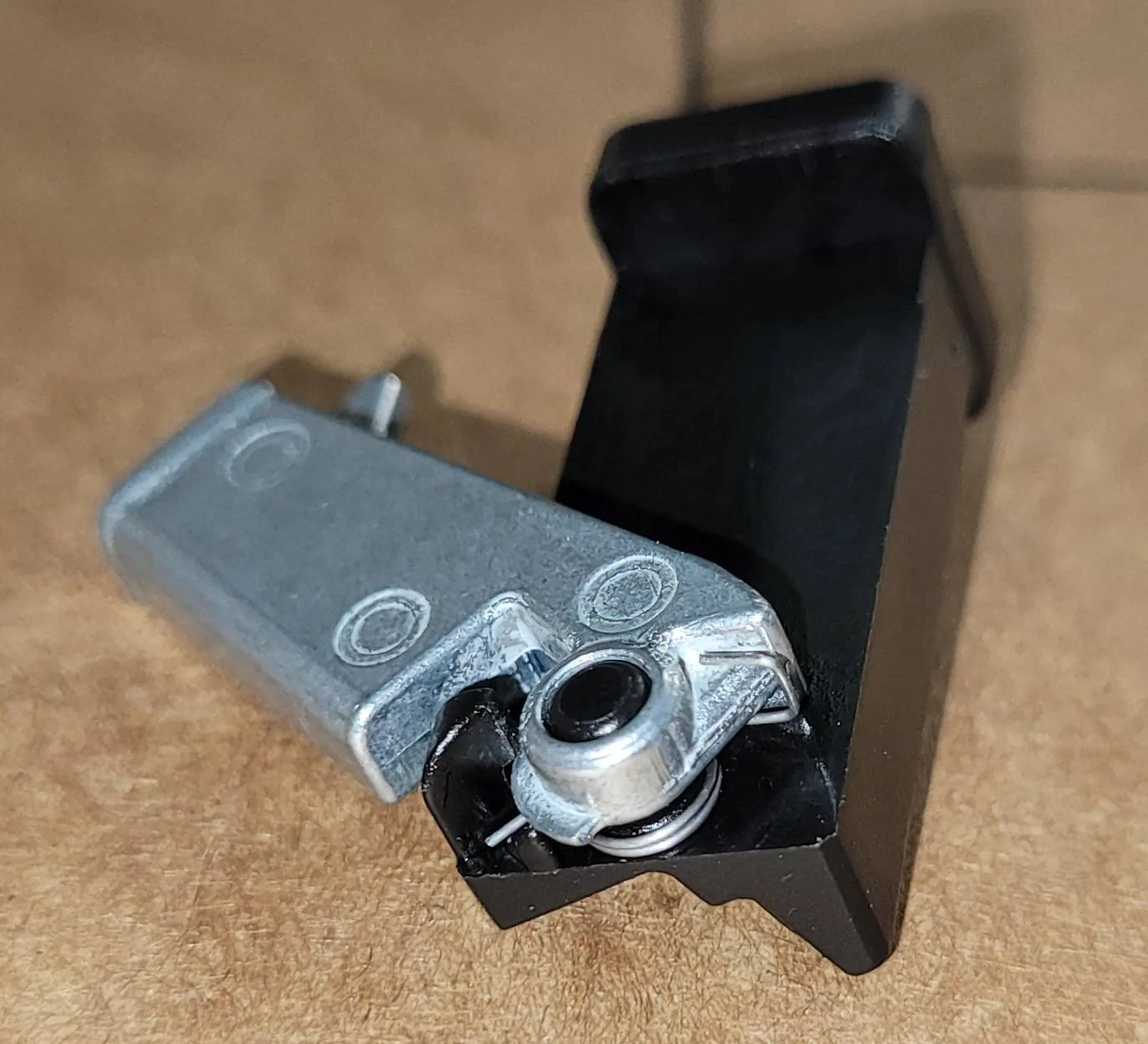

I had a problem with my glove box : I could not close it anymore, then I found the little thing which you can see on the pictures below.

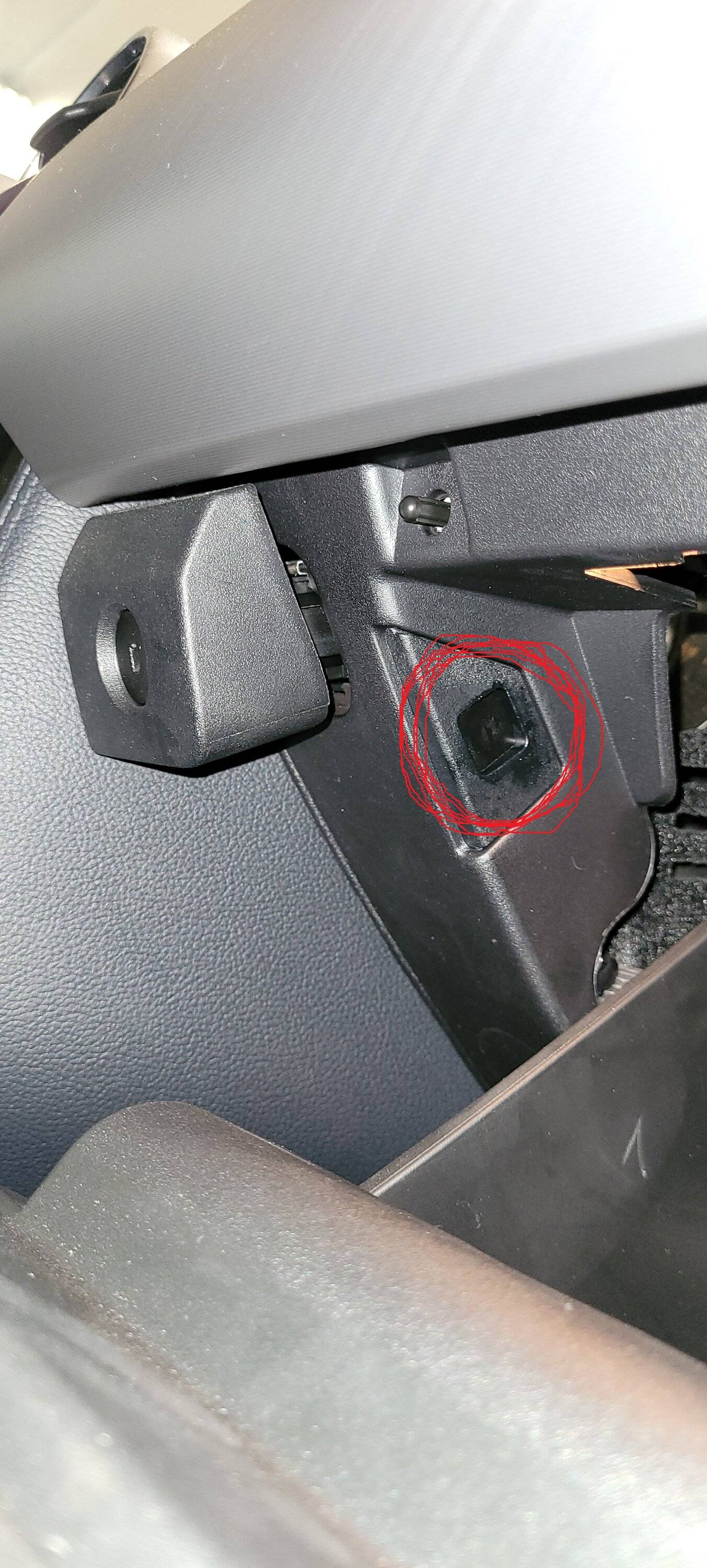

I figured out that it felt from the square hole on the left of the glove box. When you push the big square button which opens the glove box, this thing moves out of its location to push the door locker.

Where the felt part should be located (inside the red circle) :

The part itself :

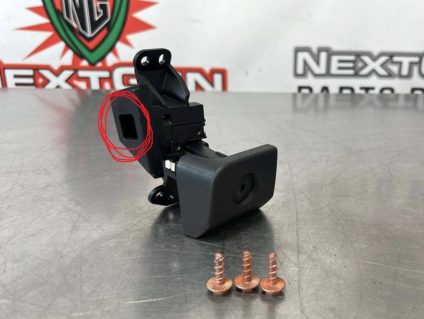

Thanks again SnakeByte, by watching at the ebay photos, I could see where is the square hole, from which my part felt, is in fact included in the lock release assembly.
Square hole (with the red circle) :
So I need to remove the lock release assembly from the glove box, to then try to find out how to reinstall the felt part.
I am not sure if I can remove the 3 screws of the back of the lock release without first disassemble the whole glove box, I will have to try.
Then, if I cannot reinstall the felt part, I may buy a 2nd hand lock release assembly, but I think removing the glove box lock, I could find a video about this, but it is very unclear ... :

So my Mustang came to Ford today, they fixed my problem : the part, which came out of my glove box button, has been reinserted by Ford without disassembling anything. They just pushed it back into its hole, until they feel a "click". They said I did reinserted it the wrong way ... So they did it for free, that's the good news.
