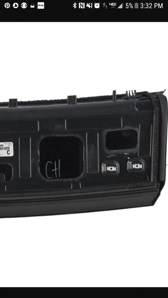

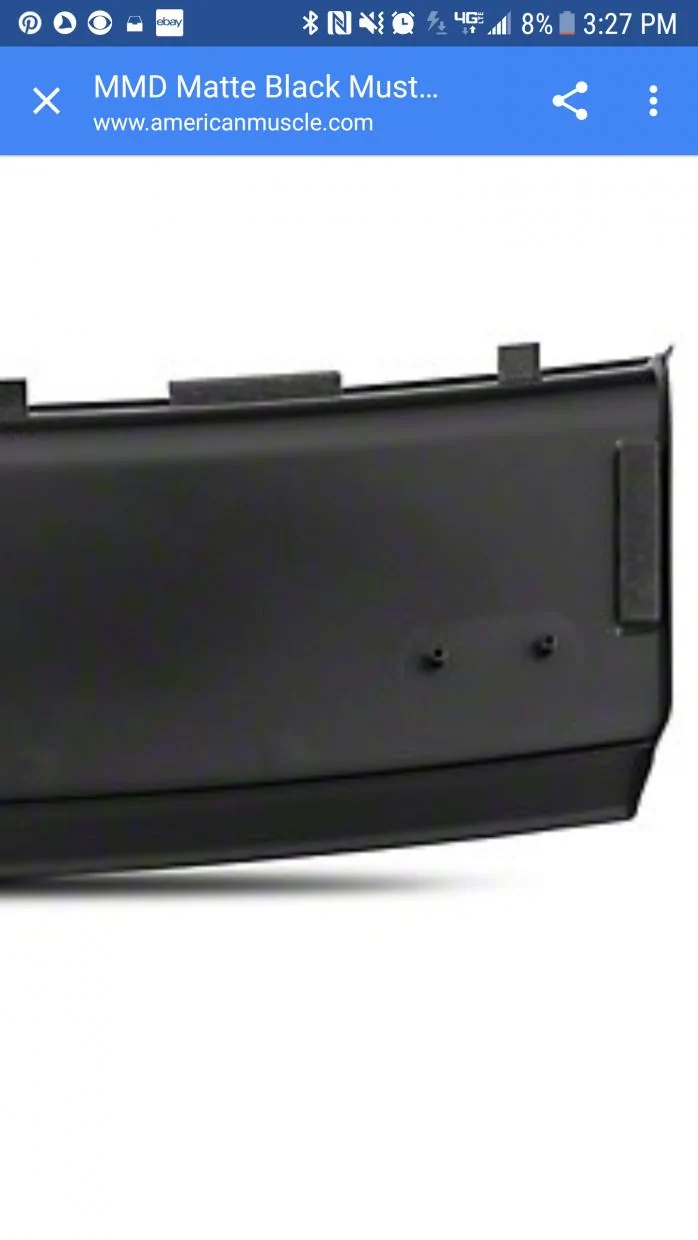

So guys .. a few things I wanted to point out I know you guys are excited and the mmd one... is the best choice since they don't make the Ford product one anymore but there is a few things you need to know it's not completely perfect and as good as stock you have to reuse your clips and also the four little bolts that you go to hold the back down they're a little bit different.. if you make them too tight on the MMD you will see dimples from the outside so be careful this will not happen with the stock ford part it's thicker and stronger and more reinforced and does not require inserts molded in the panel for this to happen .. and yes the dust and fingerprints stick right to it just like the stock one does.but way easier to clean because there's no emblem

I have seen the "dimples" comment before, but didn't understand what was causing it or where it was located. So thanks - those pics help me enormously.

So I end up making mine too tight ..what you need to do is when that's really hot outside loosen them up don't make them too tight but don't make them to lose and leave it in the hot sun and a helps the dimples go away

For the most part that dimples went away after loosening it.. and being in the hot heat
