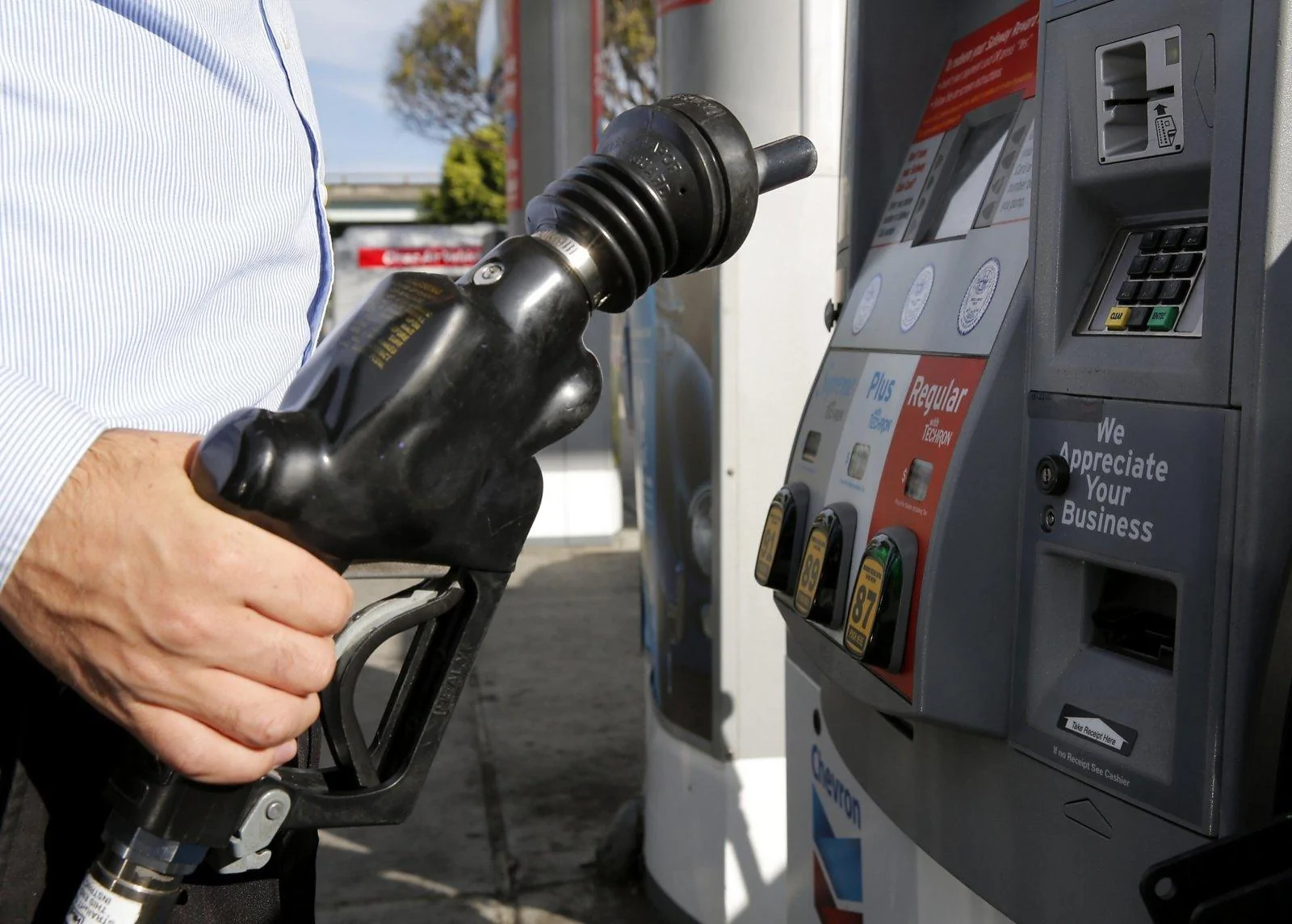

the pics were just pulled off google. i live in SoCAL. next time i go to the gas station i'll take a picture, but it looks exactly like this. this s*** causes it to pop off like a mother. can't even fuel without holding, wondering if i am doing something wrong. No matter how hard i "man handle" doesn't seem to stay.

I'm guessing the accordion boot is preventing the nozzle from completely opening the valve, the gas is bouncing off it, and shutting the nozzle off. None of the Shell or Exxon stations I use have that on the nozzles, so I've never experienced this. You're not doing anything wrong, you may just need to shove & hold while you're fueling, unless you choose a different station.

I've had this problem on my 15 GT when I had it and now on the 18 GT. I don't have problems with all of the gas stations only some. This also happens on my fiancee's 17 Fusion. It seems to be a normal thing on the easy fuel filler from Ford since it also happens on all of their line up. Not really sure what causes it and how to fix it. But you just need to push it all the way forward and hold it for the time being.

thanks for the info! i'll have to figure what stations don't have the "boot", because i went to one mobil that does have it and another that doesn't!
