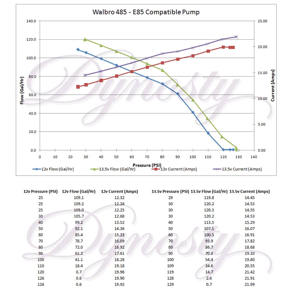

Thanks for taking the time with helpful info. I'll tell you this, I've never touched 1000whp on two pumps, e85, and a single 8AN feedline. But maybe I was too conservative in the setups ability

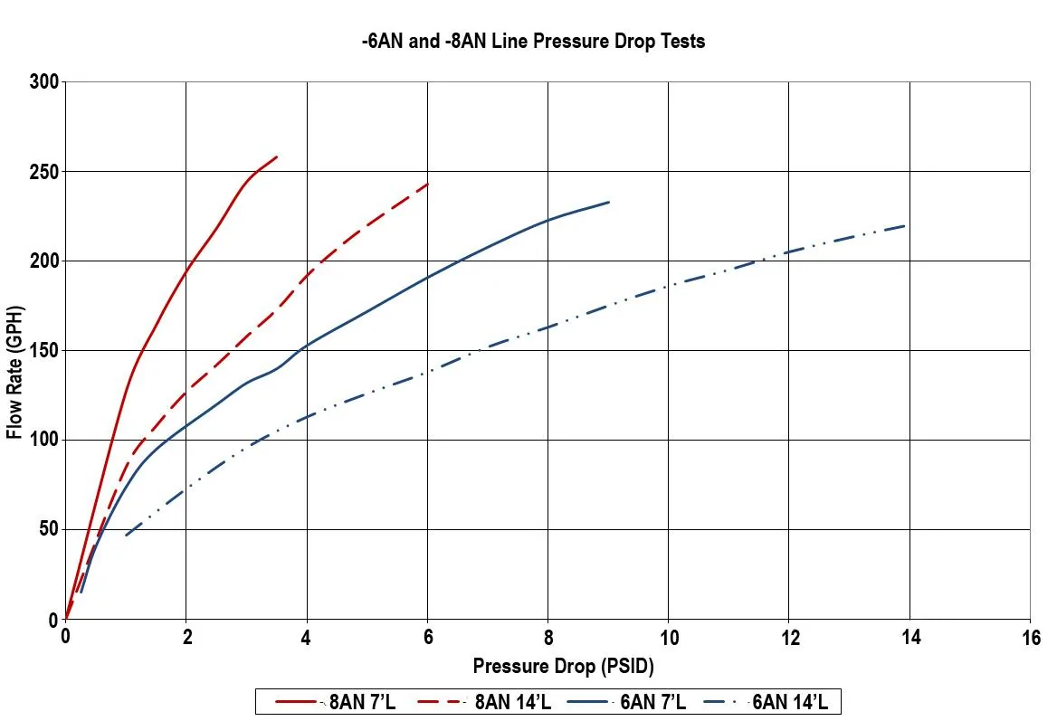

Not all cars will be able to hit 1000 e85 on just 2 450 pumps, it depends on what is in your favor. Higher compression ratio (more efficiently converts fuel to torque), displacement and good cylinder heads that allow you do it at lower boost pressure (keeps fuel system pressure lower thus fuel pump output higher), and optimum ignition timing tuning, are the main contributors to success in that regard and are all common attributes of a boosted S550. I think that the parasitic losses from the supercharger are the only obstacle to seeing the higher end of power per given volume of fuel.
But the single 8AN line would not be the hold up seeing as that it's only contributing to a 2psi increase in pump pressure. That ~1psi pump pressure over a 10AN in this flow range is going to reduce fuel pump output by less than 1 GPH per pump. As I'm sure you already understand, if you're cutting it that close that 1-2GPH is the difference between lean and safe for you, you need another pump. That increase in flow from a 10AN is not going to provide a meaningful margin... the pump is what needs attention.
