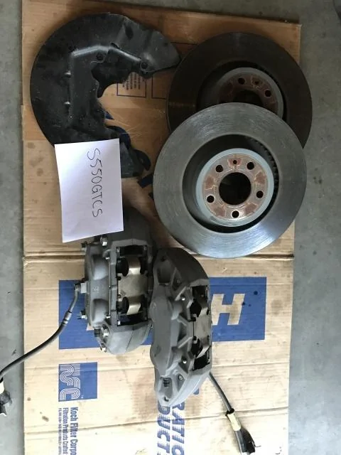

I'm grabbing these from the seller today...so excitedThis is a perfect setup for someone with an Ecoboost Premium or Base wanting to add some stopping power. Especially since it appears to include the lines and the dust covers.
I did this exact swap on my Ecoboost Premium. Factory EBM brake lines don't work on these calipers. So the fact that this sale includes them is a huge bonus. Also the dust shields are considerably smaller on the factory EBM setup, so that's another bonus that they're included.
