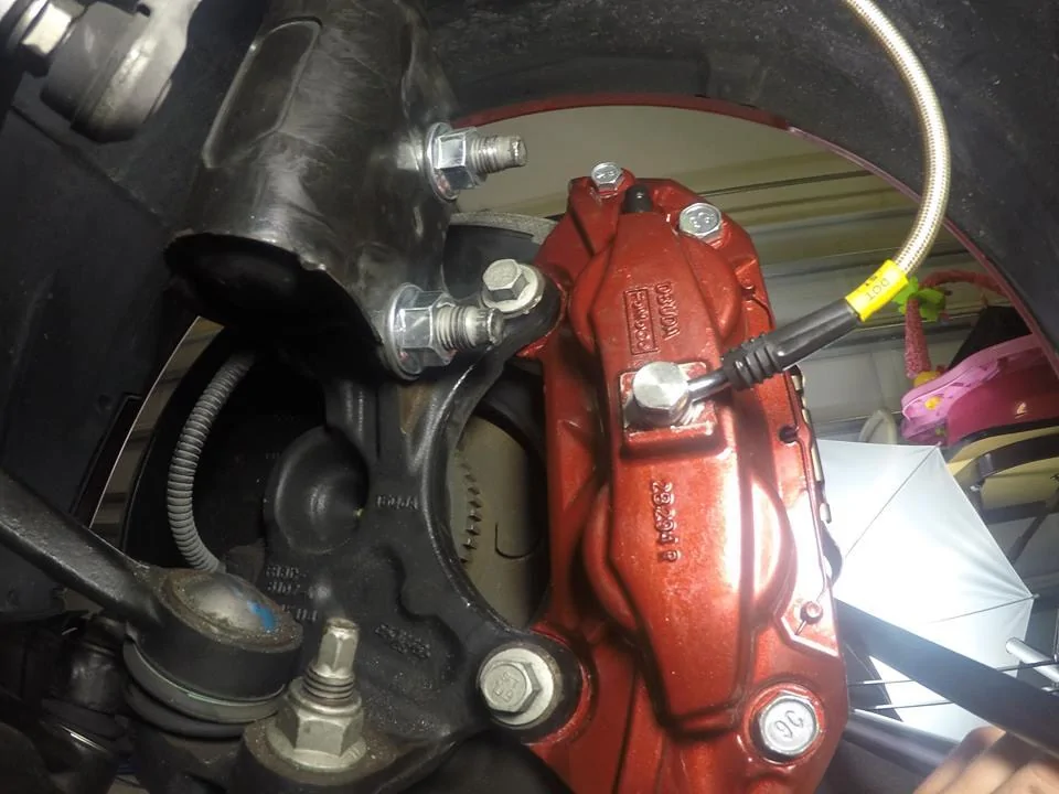

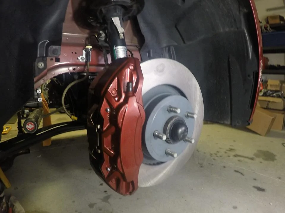

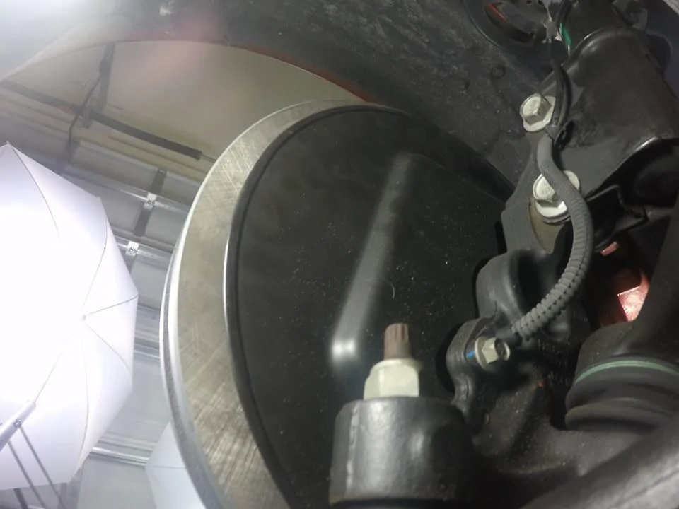

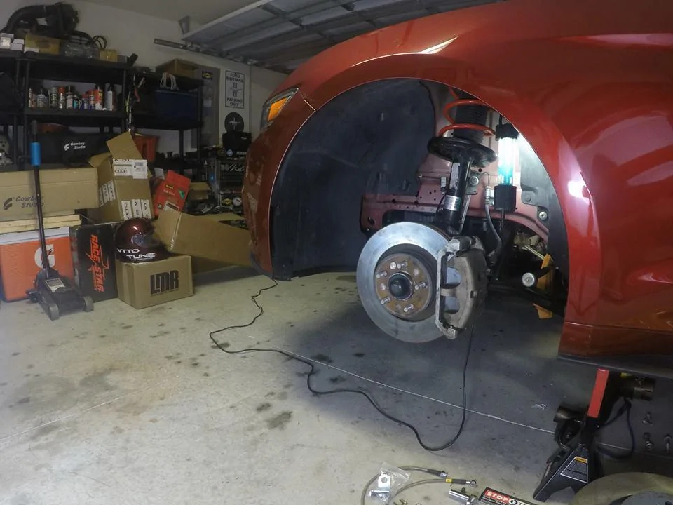

So we're in the process of putting the car back together (feel free to follow along on www.justa4banger.com or my build thread here on M6G), and I'm trying to make sure I address some other upgrades while doing so.
The car had a tendency to push through the front brakes at my previous power level when trying to build a little boost off the line in the staging bulbs. So I decided to do a budget brake upgrade for her. I'm more of a straight line racing kinda guy, so didn't see the need to go crazy overkill on the brakes - no matter how much I'd like to have Brembos or drilled or slotted rotors. That money was spent elsewhere on go-fast goodies :ninja:
Anyways, here's the rundown of what I used, hope this helps for anyone looking to do a budget brake upgrade on their non-PP Ecoboost, too:
-Factory Mustang GT Front Brake Calipers w/Pads (courtesy of Kelly Aiken @ BMR)
-Color Matched by Enhanced Auto Body in Clearwater
-Factory Mustang GT Front Brake Rotors (Advanced Auto)

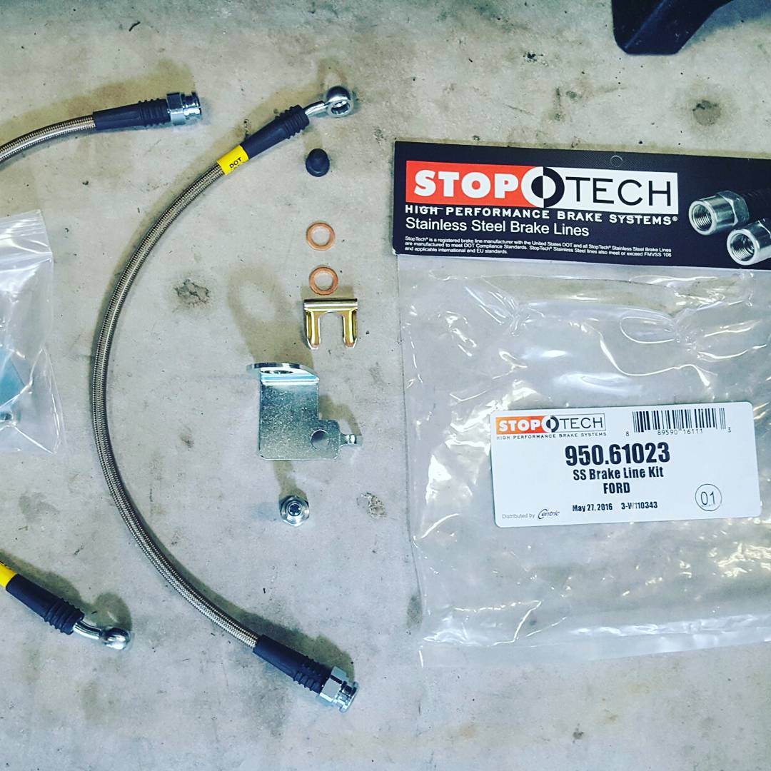

-StopTech Mustang GT Stainless Steel Brake Lines (courtesy of Brad Gusler @ BG Racing LLC)
...and of course, the wheels are getting an update as well! Racestar Dark Stars (also courtesy of BG Racing LLC).
So for about $250 in cost, we're looking a lot better, and hopefully going to be stopping a lot better! (I'll definitely update the thread w/my experiences when we get the car on the road again.) Looking forward to these being paired w/the new wheels & tires, as well as all the new BMR goodies going in! Can't wait to get the ole girl back on the streets and track to test everything out soon! :headbang:

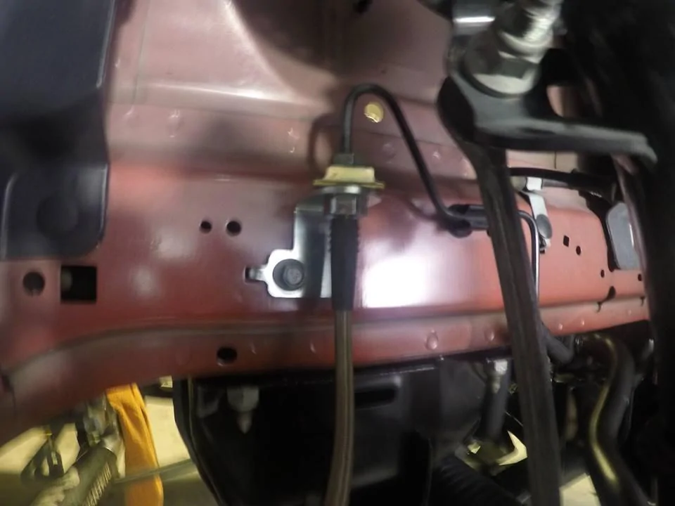

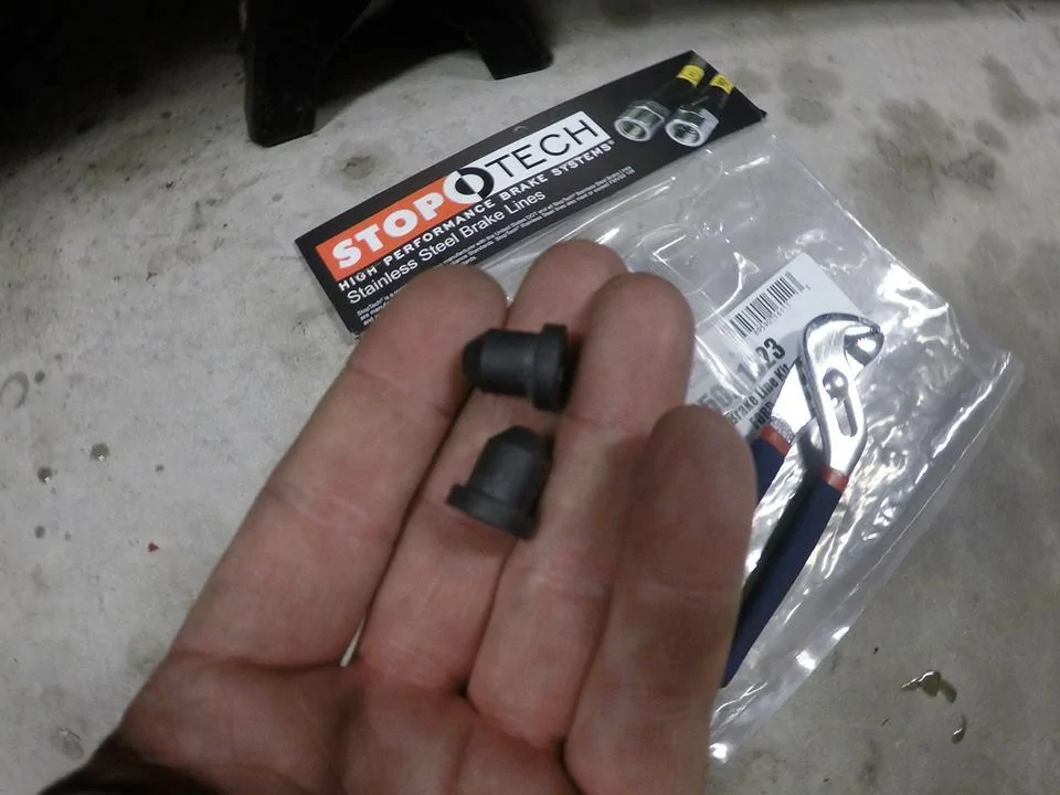

PRO TIPS: The factory Ecoboost brake lines did not work w/the factory GT brake calipers. There was, however, a small notch on the calipers that I bet I could have dremeled away and made them work. I decided the $75 investment into some SS lines from StopTech and my friends at BG Racing was the better choice, though. And when you bring calipers to be painted, make sure you have bolts in all their orifices or you'll wind up with paint in them and need to thread/unthread/rethread/clean, etc. until you get the paint back out, lol (rookie mistake).

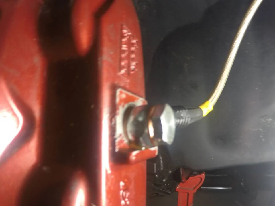

REAL PRO TIP: Don't install them on the wrong side(s)! :lol: Need to install them with the bleeders facing UP! I had them installed facing down; simple fix, swap sides and voila. Big thanks to another M6G member here for pointing that out to me :) [MENTION=18894]zuki_dan[/MENTION]

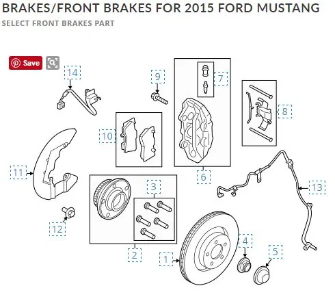

UPDATED PRO TIP: Here's the part numbers for the swap, along with the OEM Diagram at the best OEM parts supplier (Thanks to Tasca Steve for all the help on all my projects!)...
1.) StopTech SS Brake Line Kit: #950.61023
2.) OEM Ford Parts (click).
I did not upgrade *all* the items in the exploded diagram. You should be fine with reusing items 2, 3, 4, 5, 9, 11, 12 and 13 from the Ecoboost car (I did). Also, if you pick up a set of calipers from another member, instead of from Ford, you're likely going to be buying them "loaded", so you won't need to buy parts 7, 8, 10 unless you're purchasing an "unloaded" set.

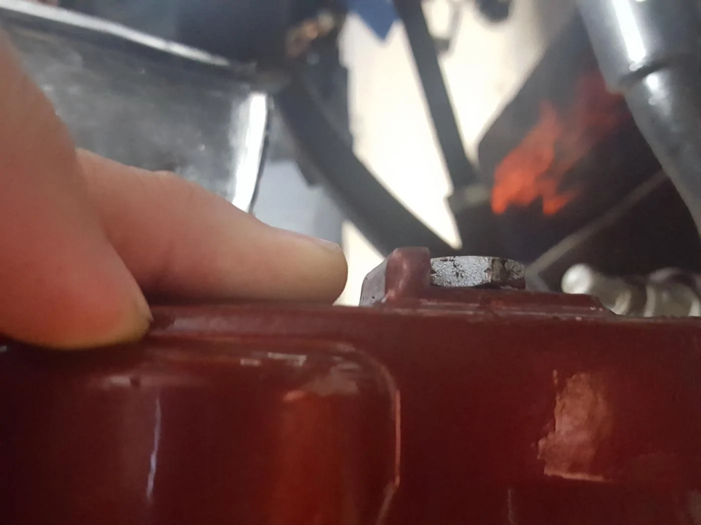

Here's the little notch/tab that could likely be removed to allow the factory Ecoboost brake lines to work with the GT calipers.

Updated the first post w/the part numbers to both the Stop Tech kit that I used, as well as the link to the OEM parts that you would need to complete this upgrade. Also included some additional photos.

Hey, quick question (yes another LOL) there are like 6 different rotors, I get the "with performance pack" ones but what is the difference in the with or w/o "premium"? Which ones did you go with? Also, looks like the package will need #6 on the page also. I think #7 only refers to the bleeder screw. Thanks again!!
Yeah, sorry, I missed the 6. That's the full caliper, you'll need that. Mine came fully loaded w/the bleeder, and the retainer, and the pads (got them second hand, not from Ford parts).
I have a premium car, so I went ahead and had them give me the premium GT rotors, and yet I don't know there to be a difference in them from the non-premium cars.
