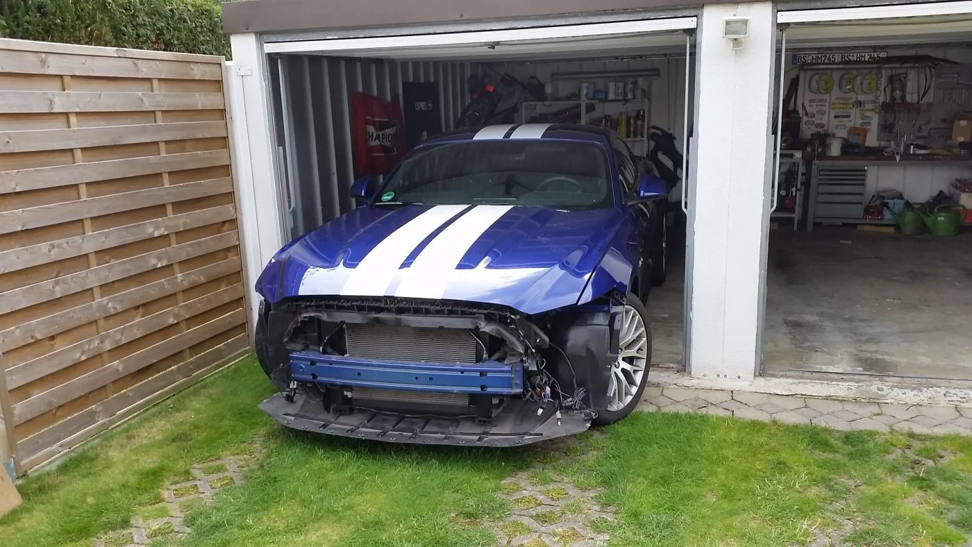

My Pony looks kinda sad now. Hopefully he will be completed again in about 2 weeks :clap2:
