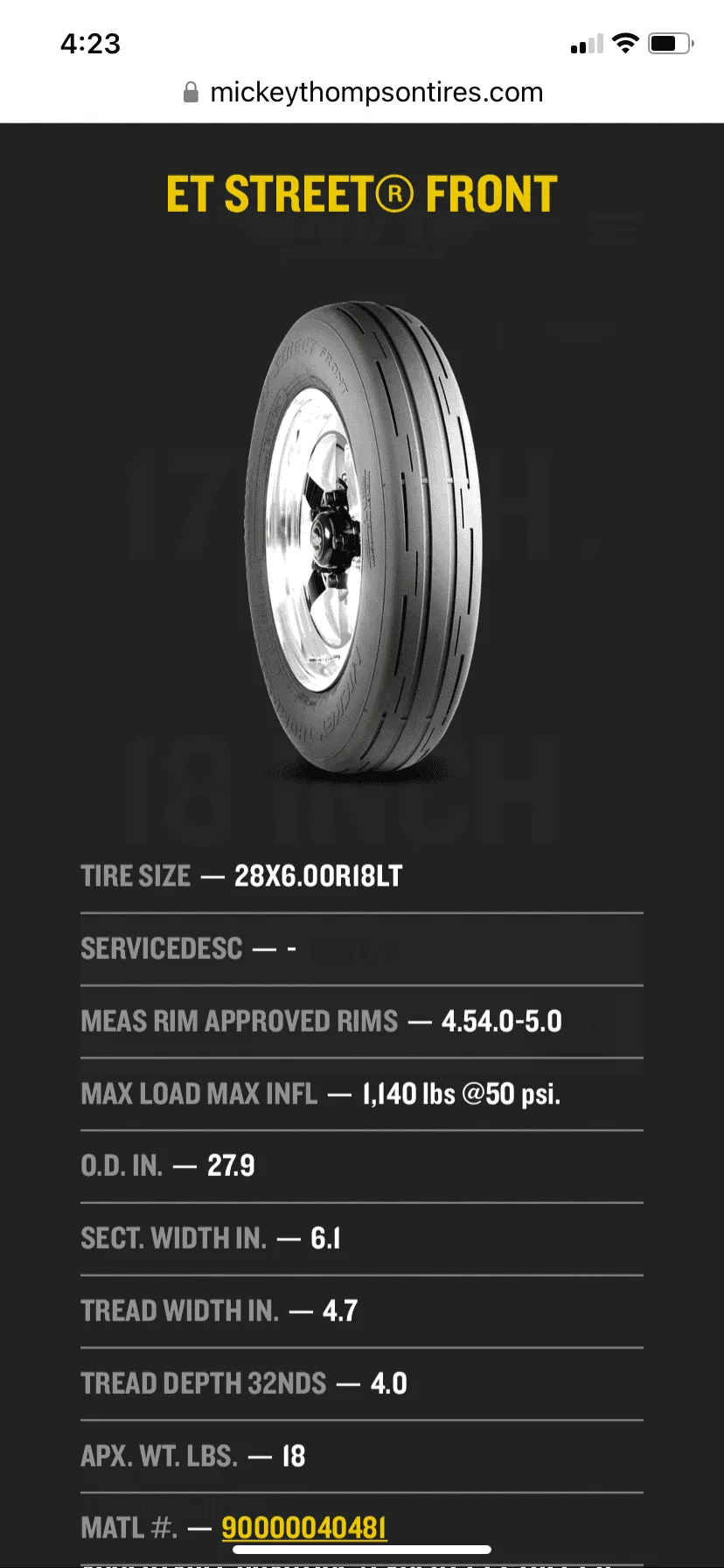

I bought new VMS 18X5 rims for the front . I also have MT SR 28x6x18 tires, but am asking what other tires may work well for use at track and some street. The Mickey's are HEAVY!

The SR’s in 28X6 are heavy for a “skinny” yes. It’s still a full belted radial construction. 25lbs each.
The ET Street R fronts are only 18lbs each. I’m just not fond of the load rating and tread design for street use
