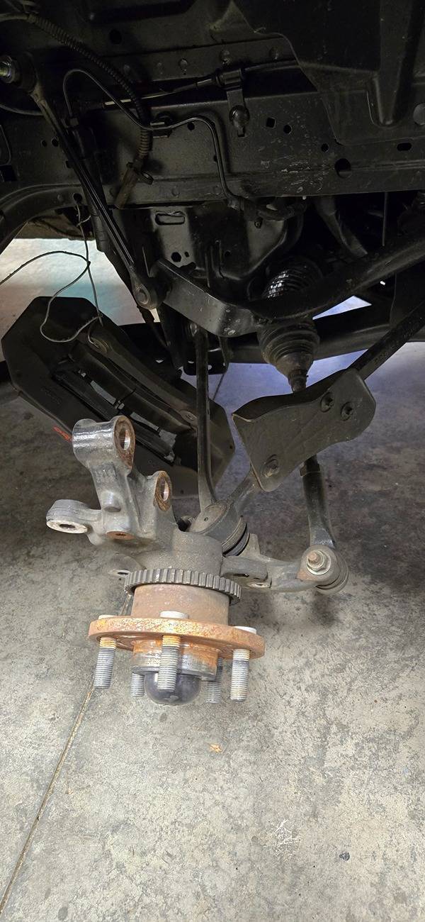

Well, after finally finishing the entire rear end of the car (Rebuilding IRS) (which turned into a gigantic worm hole) I began working on the front end..

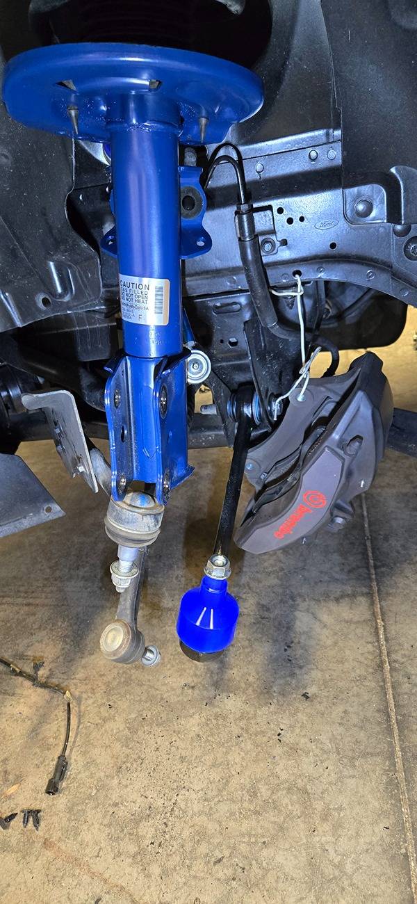

This was originally only going to entail the Steeda Roll Center Correction & Bump Steer kit, and a set of FP FR3 Track Struts, but we know how these things go.
I came across a set of Steeda Sway Bar End Links on here, so I picked them up and they went on too.

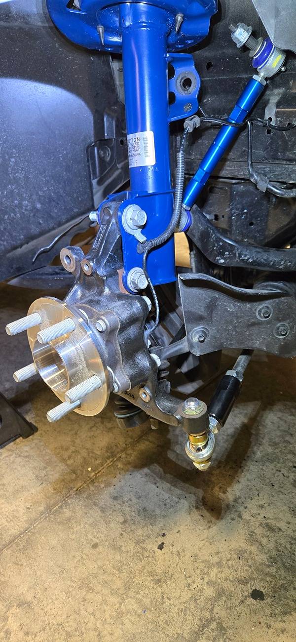

Then I began thinking about the wheel bearings. My car is a 2015, which means they are the old one big nut style.
So I started looking into it, and found the Mach 1 Hub & Knuckle Kit on Levittown.
Not wanting to spend the money on it, I started sourcing parts. Used knuckles in like new condition (which came with the ABS Sensors and saved some money). New Mach 1 wheel bearings for as best price I could find. And 8 new hub to knuckle bolts. Got the entire setup for around 350 bucks.
Finally got it wrapped up this evening and everything torqued.

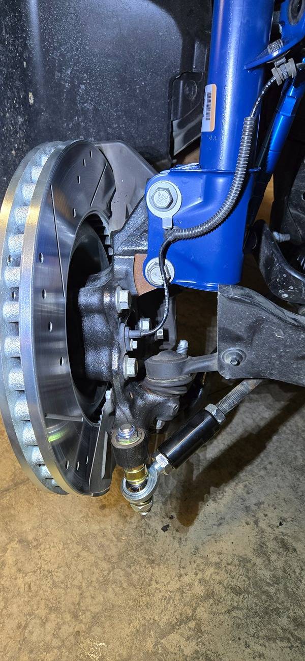

The knuckles are a 4-bolt hub design, and the hubs themselves are bigger beefier bearings.
I read somewhere that there is a little bit more neg camber built into them too, but I will find that out for sure when I get an alignment soon. I mainly did it to beef things up and I liked the separate hub assembly design. I was already in there doing the steeda stuff and the fr3 struts, so I went ahead with it.
