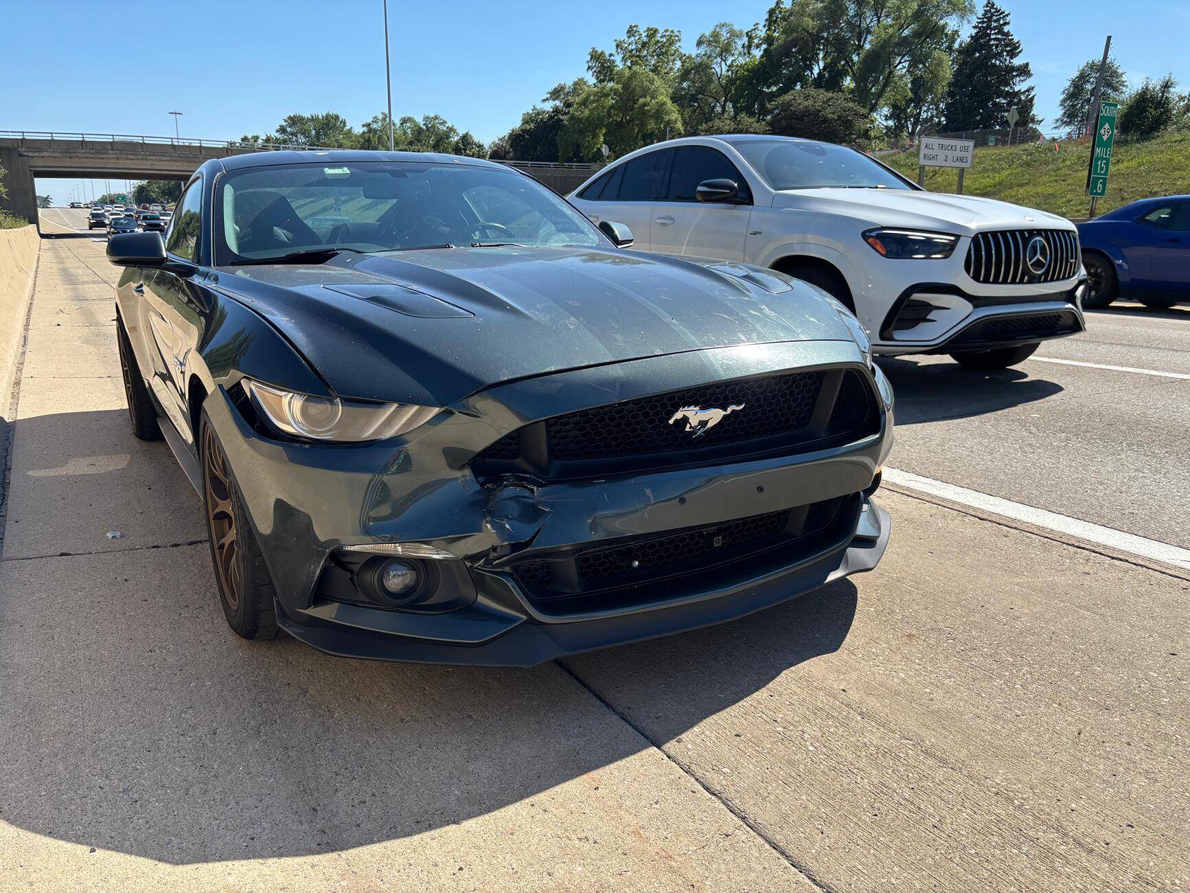

So I got into a minor front-end collision in some stop-and-go traffic a couple days ago in my 2016 GT Performance Pack. Probably 10 MPH or less and the hit was on the passenger side of the front bumper. Luckily enough, the car drove perfectly fine and straight afterwards, so my assumption here is that the frame is ok.

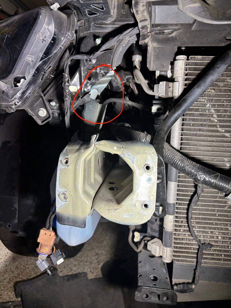

After getting the bumper cover and impact bar off, I found a couple things:
  1. Expected: bent flanges on the top of the frame rail end, visible in the second image. The two bottom bolts and the top right bolt appear to be properly square and aligned with the rest of the car and the bumper bar shape, so only the top left bolt hole is out of whack. My thought here was to try and bend the flanges back with some vise grips and some heat.
  2. Unexpected: some kind of pierced bracket or sheet metal just above the frame rail (circled in red). I have no idea what this is and this is what causes me worry. Any word from the community what this might be and if that section is replaceable?

You have structural damage. If you don't know what you're doing you can and likely will make it worse. You can not use ANY heat on these modern structural components because you can easily ruin the temper of the high strength steel alloy. Don't cheap-out when it comes to the safety of yourself and anyone else in your vehicle. Best to find a good reputable body shop that has the proper equipment and training to fix it right.

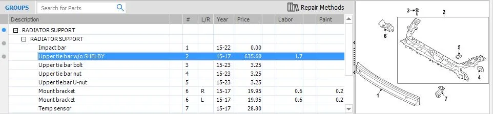

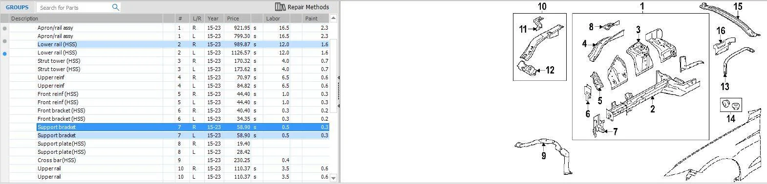

Ah crap I knew it. I appreciate this look-through, thank you! I'd spent some time poring over what dealer repair stuff I could muster up and I didn't put together that the upper tie bar is what took the brunt of it. I guess that explains how it still drives straight, but duly noted that this is indeed structural.
The car's going to a shop tomorrow afternoon, hopefully the quote on the work doesn't completely break the bank. For what it's worth, I'm hoping that restricting the repair to just the broken pieces keeps the cost low; my intent is to get the Triple 7 Mach 1 conversion bumper cover, and that's an undertaking I intend to carry out in my garage.

I ended up sending the car off to a local body shop, @SHOdaddy68 you were pretty much spot on with your assessment. The one area they were able to bend back into shape was the flange at the end of the frame rail; the car measured square even before they started the repair work, so they figured it wasn't worth the hassle to replace that bit. Probably looking at just a shade under $2k all-in on that part of the repair, so I'll take that as a small win.

Figured I'd post another update in case it helps someone else down the road.
Items that got replaced:
  • Impact bar (no surprise here)
  • Upper tie bar
  • RT Front bracket
  • RT Support bracket
Items that got repaired (just needed some bending apparently):
  • RT Upper reinforcement
  • RT Front reinforcement
  • RT Lower rail

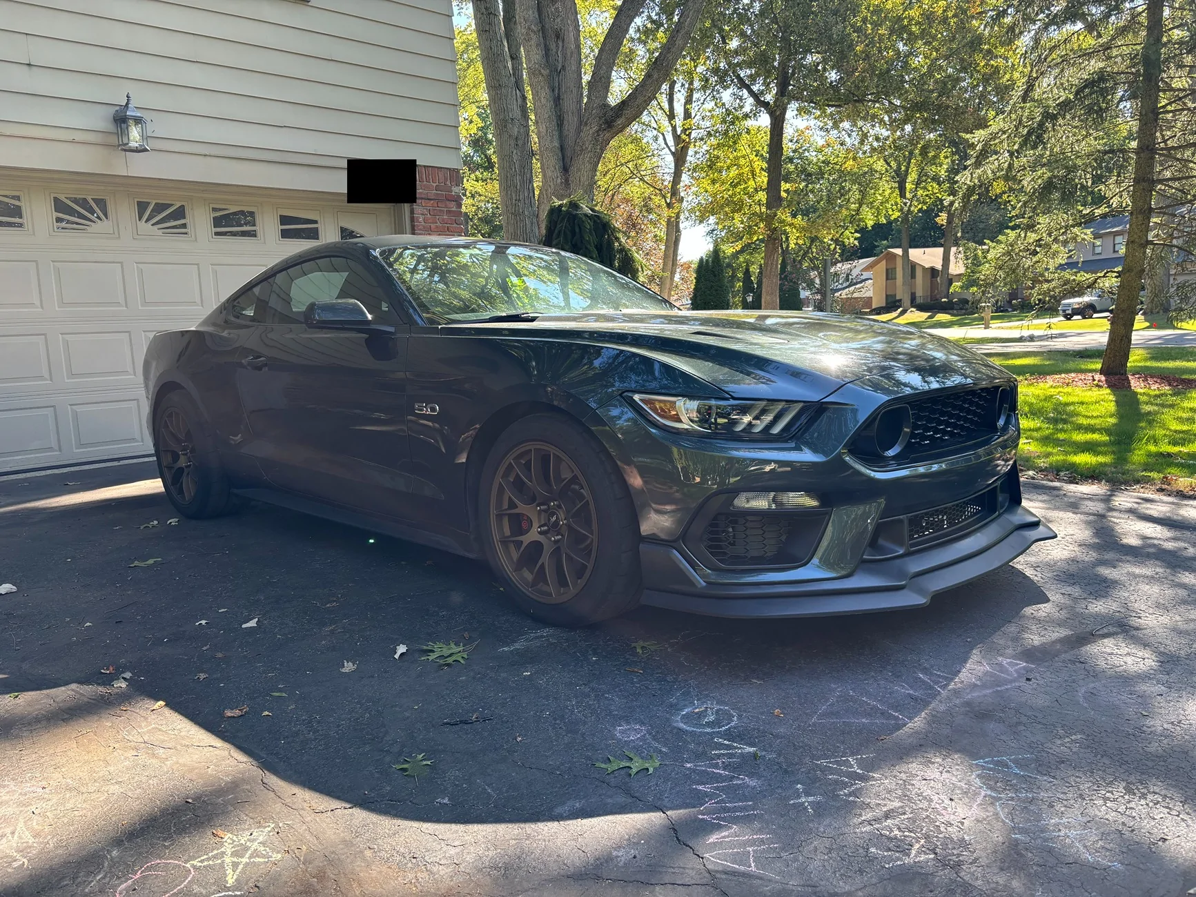

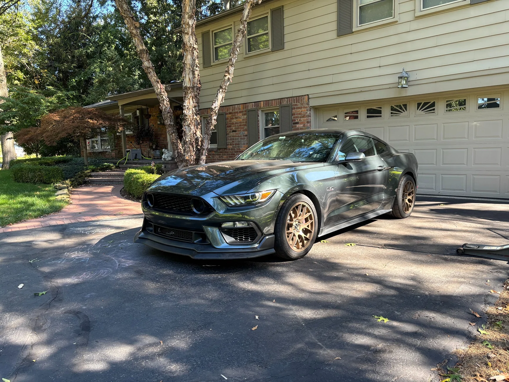

Alright, final update: it's all fixed up and back on the road!
Assembling the bumper as per Triple Seven's instructions isn't too bad, there are a few snap-in and fitment issues that require some forcing and a healthy dollop of JB Weld in some places.
As for getting the bumper on the car, managing the interface with the belly pan is a challenge. My car is a Performance Pack unit, so I had to get the base GT belly pan to make it all work; this is documented, but you still have to figure out which holes and fasteners to use on your own. On top of that, the bumper ships with several adapter pieces that aren't documented, so there's a healthy bit of improvisation required.
Nonetheless I'd say it looks pretty good and the car is now streetable at the very least. Next things to work on will be brake ducting and possibly doing a custom undertray to circumvent some of the adapter issues and prepare for possible front downforce.
